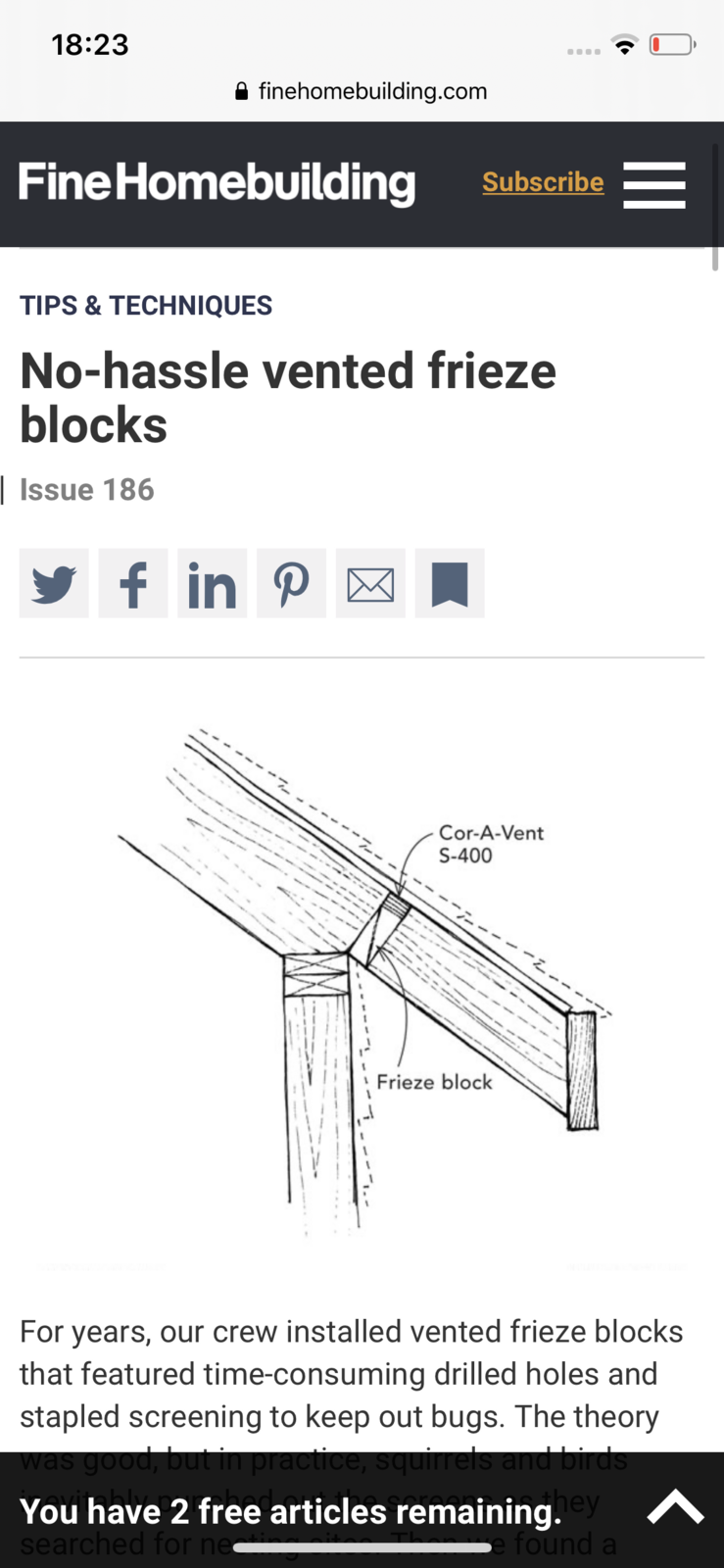

Il be doing a full re build of my roof next week and I’m just a bit stumped on how to best vent exposed rafter tails up to the dry ridge system
Has anyone had any experience with this before
there’s no soffit etc
These seem to be popular in the US

If you use a suitable breathable membrane then you don't need to vent the roof.
You should install a timber eaves board to avoid exposed membrane from below.

I have no fascia and no soffits, gutter brackets are fixed to the rafter tails. Brickwork is between the rafters.
I think my best bet is to fit soffit vents in some timber noggins between the rafters. That cor a vent s400 is only available in America, that would of been perfect
Why are you not using the over fascia vent?
ok so would that work if i bricked up the external face of my wall between the rafters. So my question is if i used over fascia vents would the air flow through this and then through the top of the breathable membrane down to the 50mm air gap above rafter insulation. Im probably not explaining my self the best!
you could make do with over fascia vents, If the brickwork between rafters is a little lower than the tops of the rafters. simply cut the ofv to size and fix in between the rafters.
