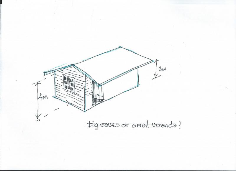

Does anybody know what the thinking is behind not allowing these (on a shed which otherwise ticks all the boxes for not needing PP)?
I know that to look for reason and logic in planning rules is frequently a good way to lose one's sanity, but I really do struggle to see how, as long as the total surface area covered is not too big, what reason(s) there could be for not allowing the roof and floor of a shed to be extended beyond one of the walls.
Is it that it doesn't count as a "verandah" if it isn't a "raised platform" more than 300mm high? (ISTR reading that somewhere, but can't find it.)
If I took this, for example (not that I'm going to):
and put a bit of decking, 100-150mm high in front of it, would that be a verandah?
When does a porch become a verandah?
One suspects that it would be very hard for a LPA to object to one of the sheds
in the pics, solely on the inclusion of the veranda.
For example, what would be the difference between a canopy over a door (to keep the rain off) and a veranda?
The exclusion of 'veranda' is presumably to prevent the shed being used as some form of habitable room (because people often sit out on a veranda)
rather than a room incidental to the main dwelling.

a veranda is a open area with a floor and roof
an overhanging roof is fine in my humble opinion
if you tried to say use decking to raise the outside level you should be fine at less than 300mm
i suspect the shed floor level will be a tad less to allow the shed to comply with the 2.5m rule and have a good head height

It's not saying that you can't have verandas, balconies or raised platforms *on* an outbuilding; it's saying that verandas, balconies or raised platforms are not permitted development *as* outbuildings.
Ah - I see.
Never occurred to me that anybody would try to call anything like those "buildings".
