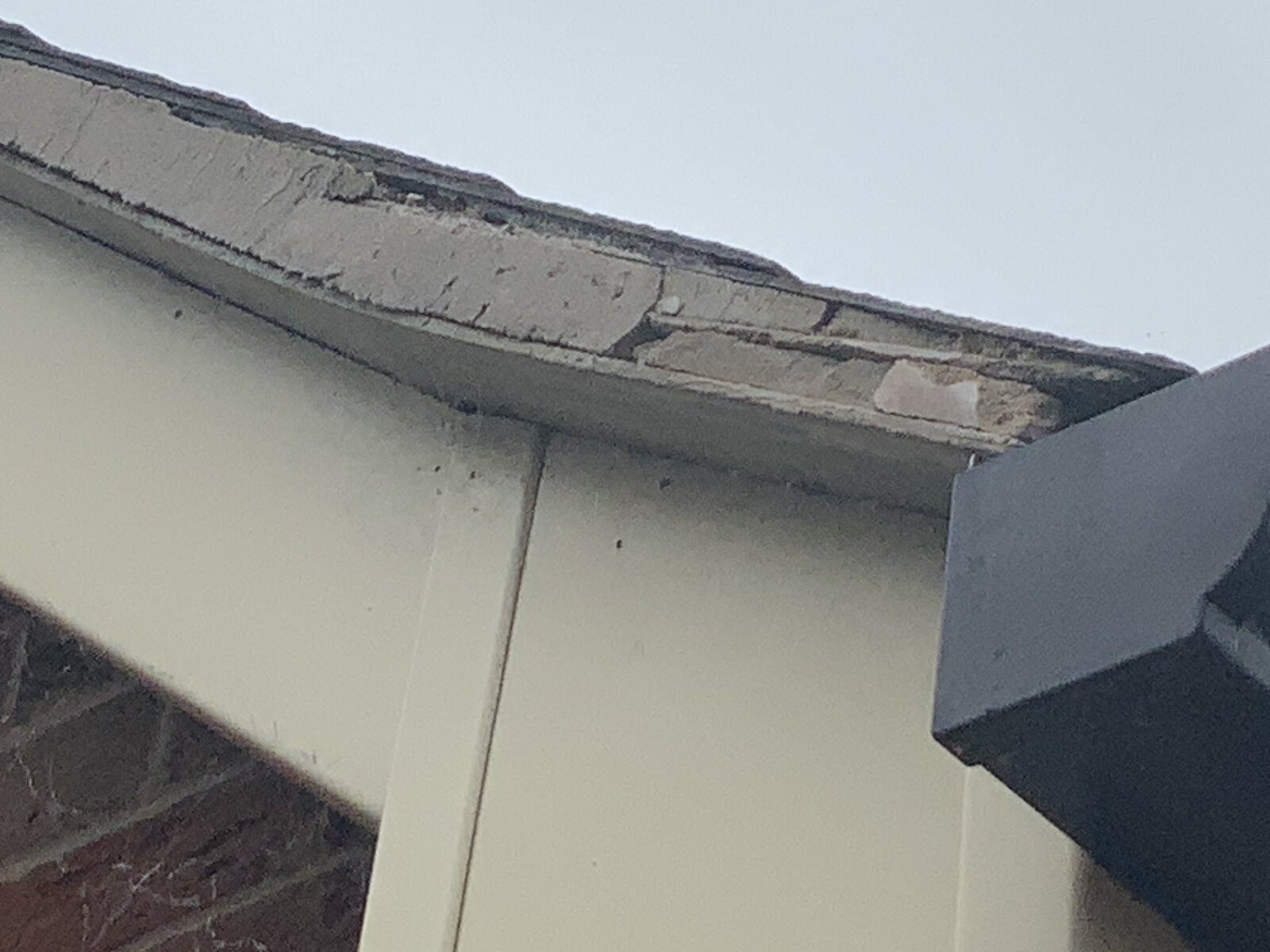

I have a 6 year old new build modest 4bed home with a slated roof. Some of the mortar has cracked and fallen out of the verges. I have approached a couple of local roofing firms. One has suggested that all the mortar needs to be replaced at a cost of £3500: alternatively, he could fit a dry verge for £4200. When I asked about the need to remove edge slates etc, I was told that this wouldn’t be necessary as they would just scrape out the mortar and install a batten which they would attach the dry verge.
A second firm has quoted £1300 to replace the dry verge in the areas where it is crumbling/cracked. A chunk of the cost is for a cherry picker.
Some questions if I may. Is my situation covered by the NHBC guarantee? Is the guy quoting £3500/£4200 having a laugh? Can a dry verge actual be fitted without lifting some edge slates? I should add that the quote was from a company that covers the North Midlands.
I am inclined to accept the £1300 quote. Thoughts?

Cement on slate tile edging? Do you have photos please.

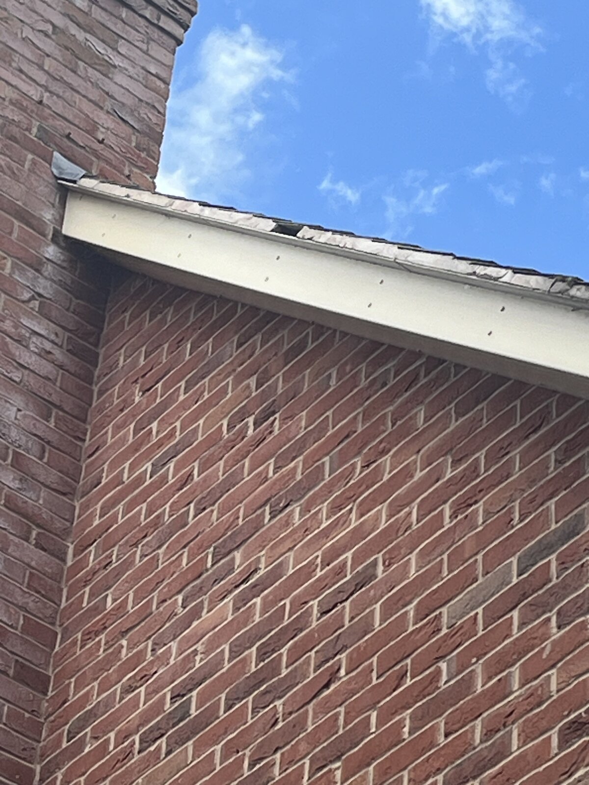

If you have shown us all the work needed then the higher quotes are having a laugh surely. The internet suggests an average semi can have dry verge installed for around £875 and a cherry picker can be hired for around £250 - £300 per day. Two men in a cherry picker would only take a day and so take the £1300 if any. Of course every job is different and the £875 is only an average price so may be worth getting a few more quotes based on using a cherry picker as it would be cheaper than scaffold.

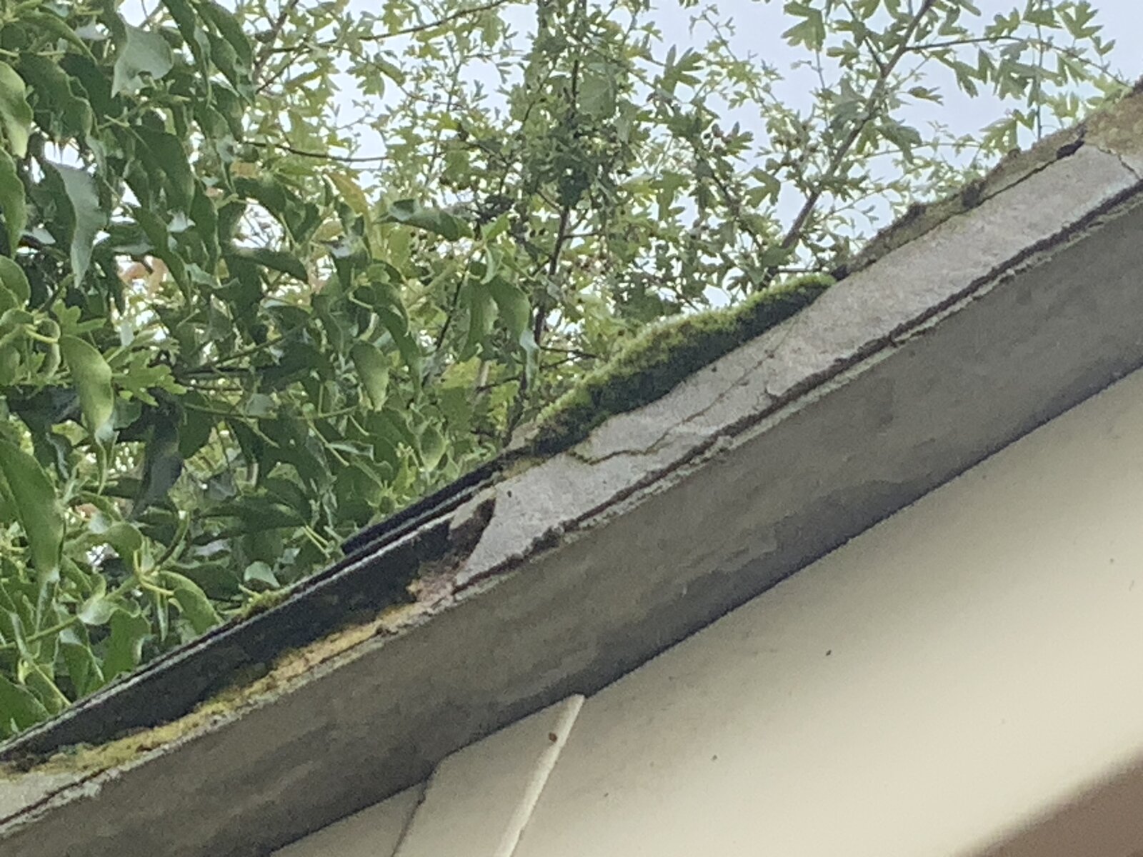

I'd say from the photos that patching up would be a waste of money. It looks like the bits that haven't fallen out are on their way.
I'd go back to Mr Cherry Picker and ask his price for full replacement. If he says under £2000 then say yes.
Internet price guides are often misleadingly low, they're probably based on years old prices or just fiction. It's impossible to gauge the price as we don't know how much there is to do.
Assuming continuous dry verge (type S)then the verge slates need to come off and cut back .
Anyone who says the slates can stay on don't intend to do it correctly .
I mention type s it's the only one worth considering .
Materials are cheap .
