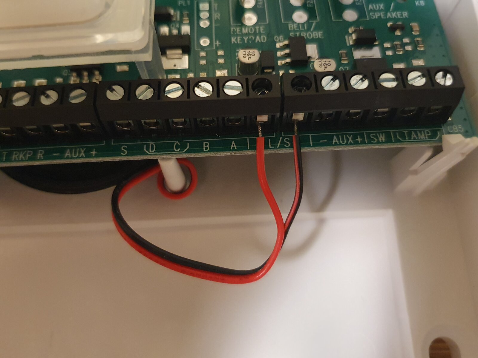

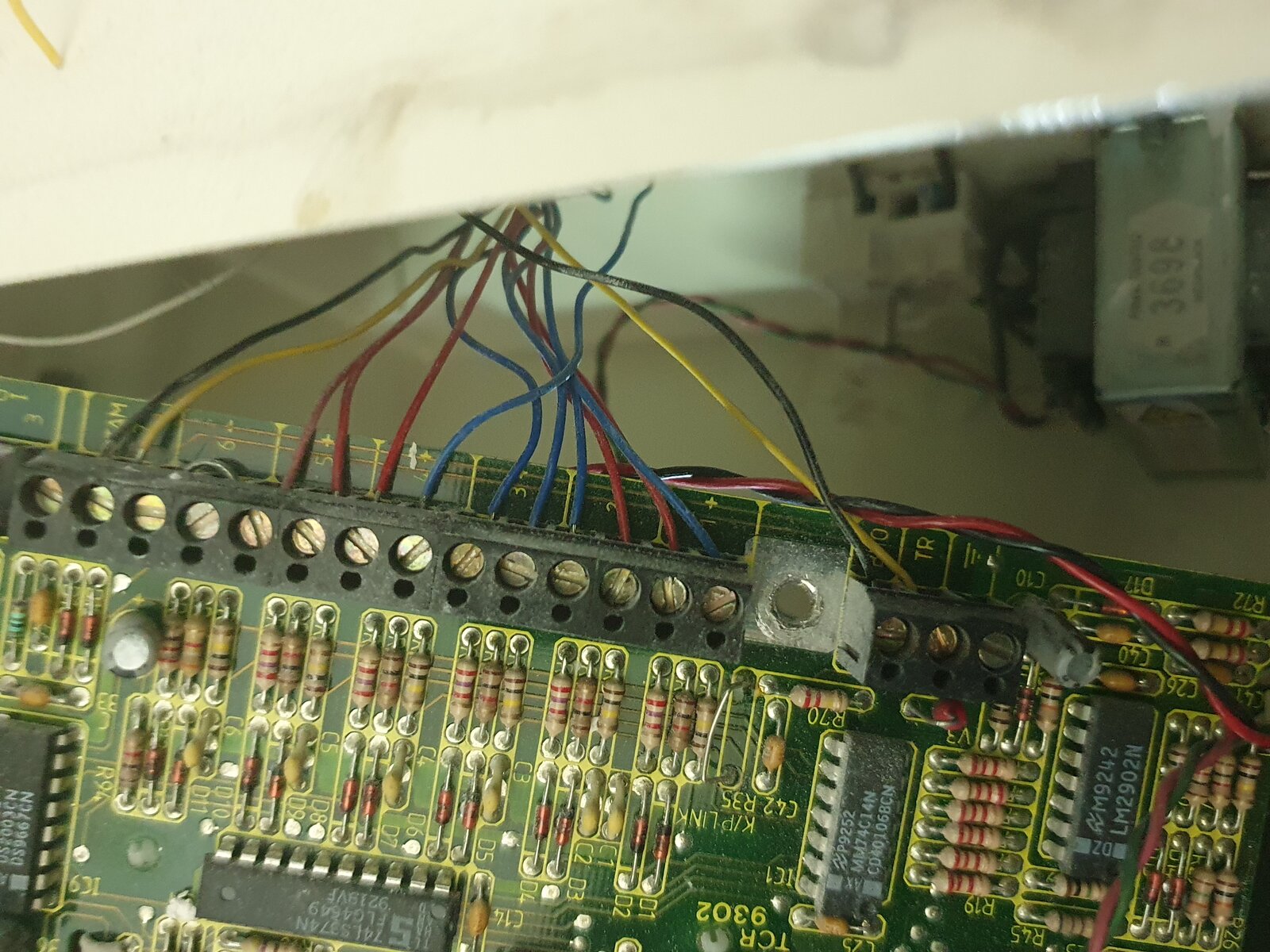

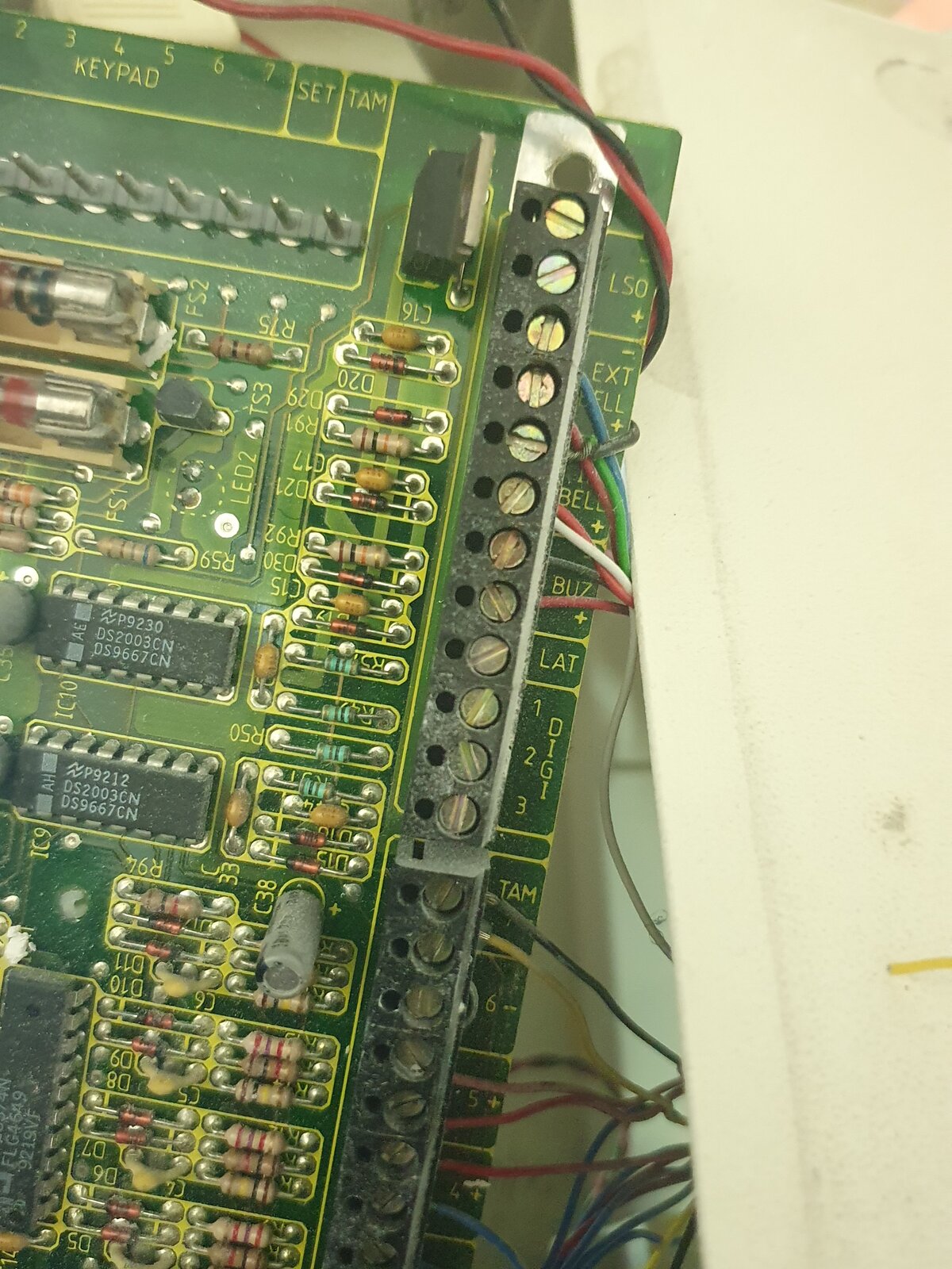

Hi,
I am replacing an old 1987 Horizon alarm panel with a Texecom Veritias 8 Compact and need some help confirming a few of the wires to be transferred over.
So I have the supply no problem.
All the zones labelled so should be straight swap.
Black and yellow tamper circuit, sticking with same 2 wires going to TAM in panel.
that leaves..all on the same cable going to the bell box outside presumably
yellow/ blue core - old panel.. blue external bell minus; yellow TR
red/black core -old panel... red external bell +; Black BHO
Green/White Core -old panel...green Internal bell minus; white internal bell +
I don't have any PIR sensors or internal buzzer as buzzer was part of old panel.
The veritias 8 compact does appear to have a small inside panel also.
any help would be greatly appreciated

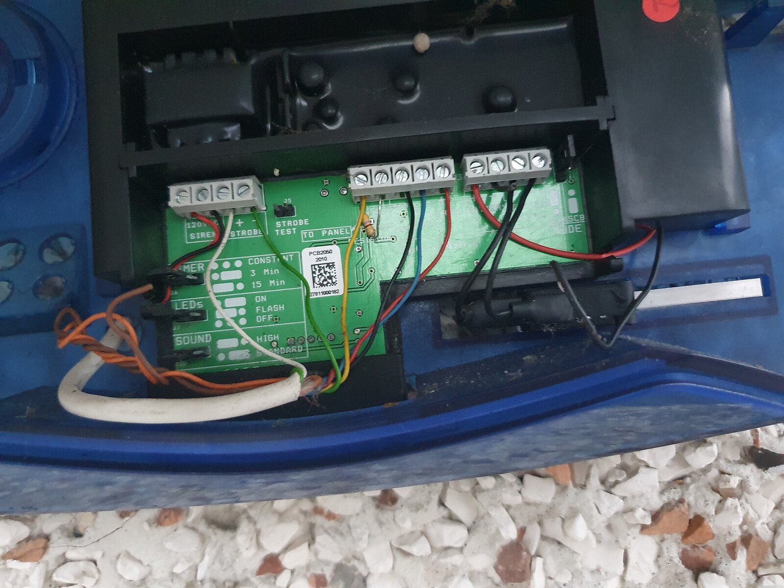

Any idea which of my existing wires connect to ABCDS? Is it possible that my old bell box doesn't have a strobe?
Depending on what is on green and white ? It may be a strobe you would be better posting a picture of the bell box wiring ....but here is the connections you need assuming green and white are strobe ( you may have to add the white core with the red one ....455E68CF-DDEB-4FD8-9F0D-64D72466A5E5.jpeg
Thank you,yes I took a pic of the bell box I haven't studied it yet but I notice it has a +/- for the strobe,green and white,older setup up...but i think you have already answered my question
