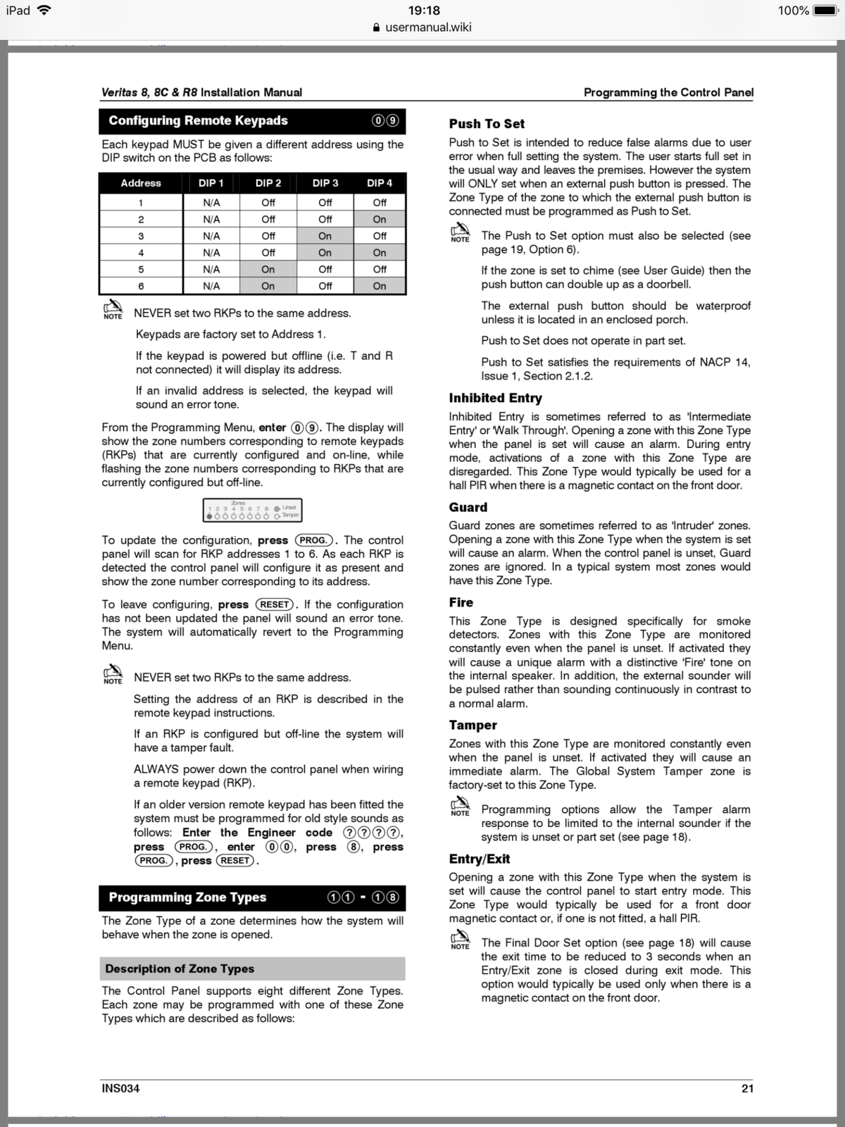

Hi,
I have had a Veritas 8 for many years with an RKP in the garage.
I have just moved the main panel into a cupboard and added a new RKP in the hall.
This new RKP, with an address of 2, works fine.
I just checked the old RKP in the garage, with an address of 1, and it double bleeps when keys are pressed and generally is no use to try and set or unset the alarm.
As I opened the old RKP to check the address, this may be down to disturbance, but just wondering if anyone might comment on any compatibility issues.
They are wired in parallel at the main panel as that is how it is done on the Veritas 8.
The 2 RKPs look the same from the outside but are obviously slightly different inside.
Happy to replace the old one if needs be.
