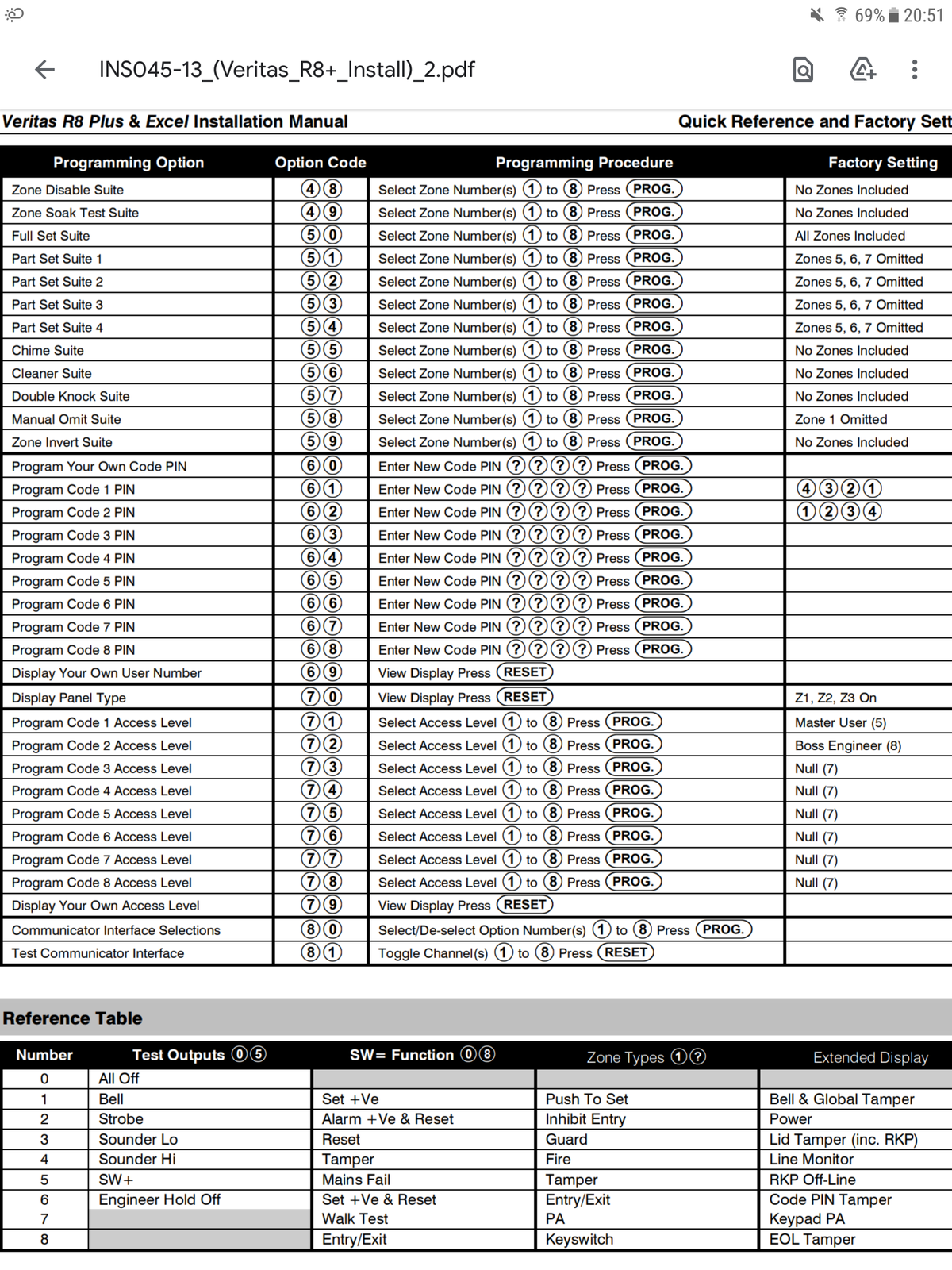

Hi All, firstly thanks for taking the time to read and help it's much appreciated.
My first alarm install has gone really well got to grips with dialler, EOL and everything else and the alarm is working great. One thing has got me totally stumped and I would really appreciate some help.
I have set up a part set 1 which turns hall PIR (Zone 4) to Ent/Exit and front door (Zone 1)to guard for night time no problem, come downstairs PIR picks you up and entry exit tone starts, front door trips alarm if you enter without crossing hall PIR, perfect.
What I want to do is create another part set (part set 2) where both the hall PIR and front door are Ent/Exit and I just cant seem to get it sorted, when I program part set 2 it appears to lose all the settings for part set 1.
I am obviously doing something wrong.......... Thanks for your time all.
Follow instructions as per attached.
Firstly:-
What Zones do what functions full set:-
Been a while but from memory you have part sets
51,52,53,54 which have the zones in use
20 which part sets change zone types
21 change into e/e part set
22 change to inhibited entry in part set
23 change to guard in part set
so full, set 1 e/e and 4 inhibited entry
part 1, zone 1 guard and zone 4 e/e (1 and 4 change function)
you cant then change
part 2 to zone 1 e/e and zone 4 e/e (1 doesn't change function from full set but does from part set, based in change in part 1 zone 1 would become guard)
To be fair think this could only be done on an Orisec panel. I am having think though.
Where you can set each zone type in full set and each part set
Thanks Handymanjo and secureiam,
Handymanjo I followed the install manual and I'm still clueless but it may be that secureiam has the answer.
Secureiam you are spot on with the shortcut numbers, it must be down to my understanding of "part sets". What you say would make sense as when i program part set 2 its effectively overwriting part set 1 that I created.
That just leaves me with one question then, what on earth is the purpose of having 4 different part sets? I guess all you can really do is omit zones in each set but have a common change in zone type across all of them, would that be correct.
I only have one option really to set part set 1 to zone 1 and 4 entry exit that should work.
Many thanks for your replies
basically yes, you might be able to fudge it if you have a spare zone.
and block out zone 1 in part set two from being used and vice versa with the spare zone
but you need to write it down on paper and plan it and then try it, rather than an extra zone you could look at splitting the door contact on the door across two separate zones.
however I don't have a Veritas let alone one capable of EOL, to test and I would have to sit down for some time to get t straight in my head how it could be done.
Thanks for your help Secureiam. I see what you mean about the fudge, ill give it a go after i've had a think about it and see if I can get it to work. I have to confess I'm really pleased with the panel, it does everything I need apart from this. EOL was a laugh to start with but makes perfect sense now. Half of me wants to replace it with an elite so I have even more to play with but I'd only end up filling this forum up.
