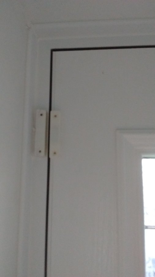

I've had my Veritas R8 for 4 years and was working fine up until a few days ago but now the entry tone does not start when entering the property when the alarm is set. So every time I enter my house I wonder to myself whether I forgot to set the alarm as there is no sound.
But the alarm does work as it activates as soon as the sensor picks up movement in the house (if it hasn't been unset)
There are no problems when setting the system as the exit tone works
How can I get the entry tone back?
Any help would be much appreciated. Thanks
If you have a contact on the entry door it's probably stuck closed, give it a tap with the screwdriver and try it , if that's the case replace the contact as it may stick again
Does it have a Door contact ? If so the part on/ in frame not in/ on the door as this is the magenta
Yes there is a contact on the door (photo attached). So where do i tap it? From the side or from the top or bottom?
