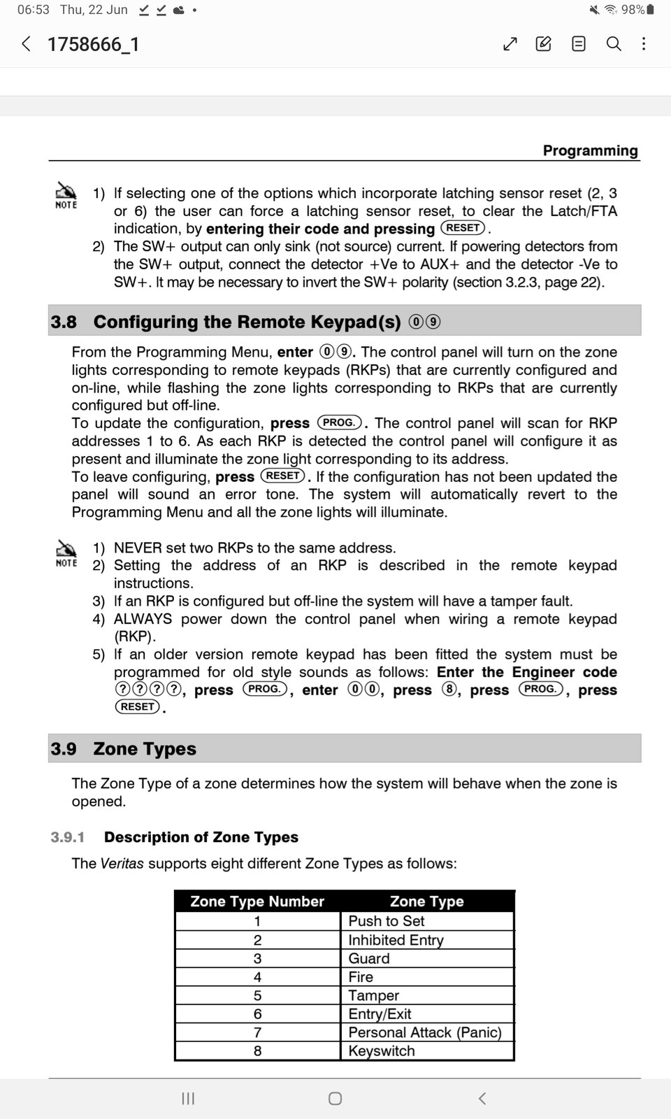

The other thing is the is a menu on the system which shows which keypad addresses are attached to the system. I will look it up as cant re4member off top of my head, dont do many Veritas and even less with multiple keypads although it can take 6.
Engineers code Prog 09 Prog, your looking for 2 leds illuminated between addresses 1-6 if only one shows then the panel can only see one keypad

Also check dil switch settings on both keypads to check that they are not the same address. Screenshot_20230622-065339_Samsung Notes.jpg

your saying it doesnt work at all, so if you do the 09 thing can the panel see both keypads?
09 command will show say 1 and 2 if it can see keypads addressed 1 and 2 or 1 and 6 or a combination of 2 numbers based on the Keypad addresses. The only way it shouldnt show two addresses, is if two are the same address, a fault with a keypad or an issue with the cables.
