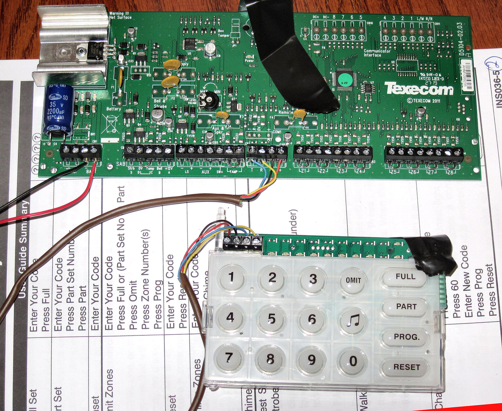

Hello, I've a problem with my new Veritas R8 with remote keypad , it is going to be fitted as a replacement for my ancient Omnicron 9000.
I'm trying it out before actually fitting it in place of the old Omnicron , I've put temporary joining links for the 8 zones and the tamper links, I taped the springs for the tamper on the keypad and main circuit board.
When I try to set the panel all the red LED's light up and green LED flashes, it then beeps for about 9 times ,I can only seem to be able to stop the beeps when I enter 4321 which I assume is the engineer code.
The battery is new, plus I tried the panel with mains power temporary fitted.
The alarm is being used for my garage and workshop plus shed,I don't need the timed entry/exit, which is how the old alarm worked.
I've taken a photo of the circuit board with the zones each linked separately , when I eventuality sort the problem out do I have to use the entry/exit circuit ?
The panel is CFC.0001,Build revision 6 with firmware version 3.22.

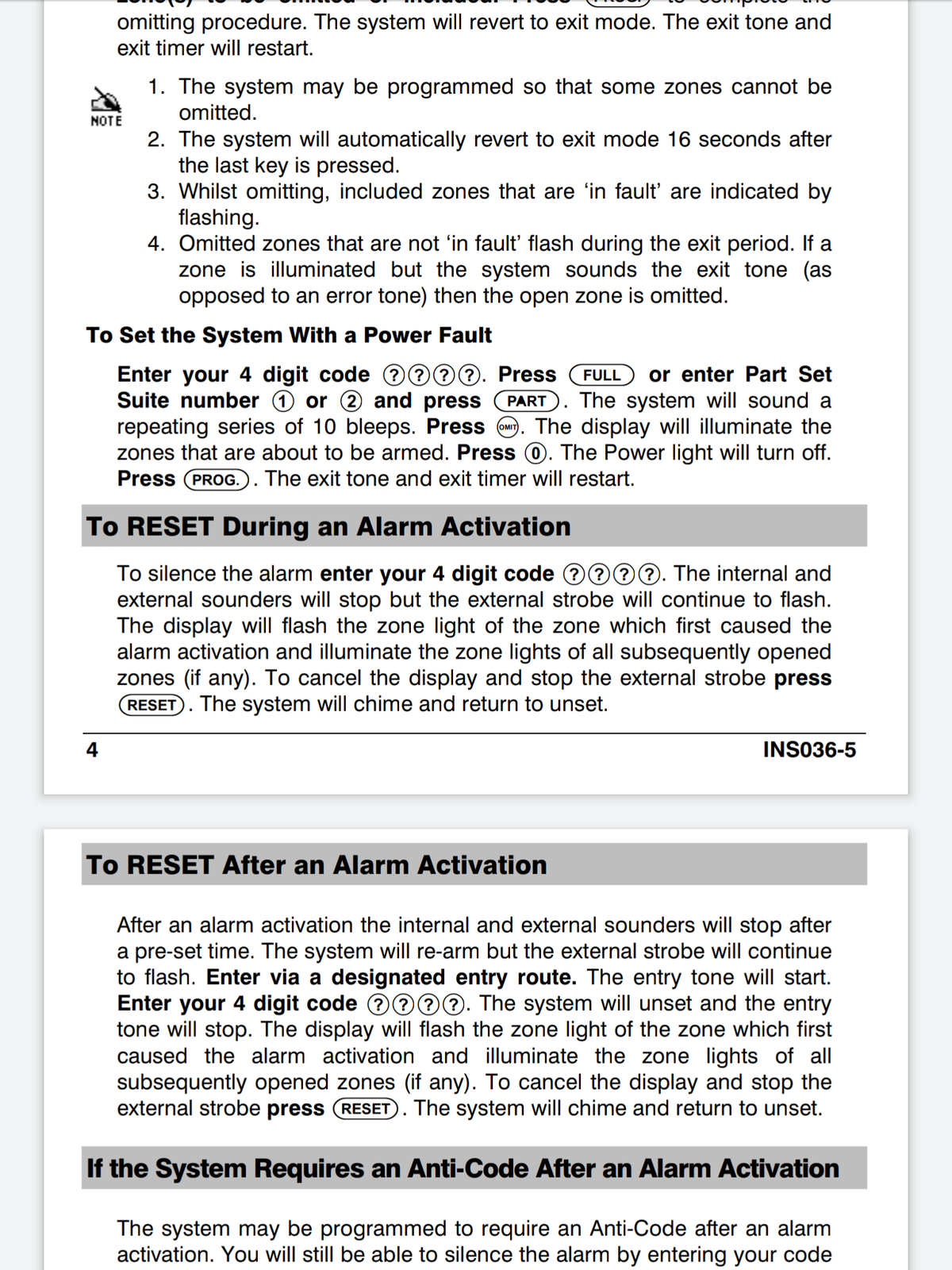

When no a.c. power to control panel you need to set panel differently.
Code number omit 0 prog
Try that.
The springs could also caused an issue taped down,would be better putting pcb back in control panel houses ,same with keypad.Screenshot_20201122-173829.png
Veritas panels on power up start to set.
Unset light flashing would indicate a power problem. and tamper may also be displayed.
during setting process if you press omit 0 prog that will omit a power fault, omit 9 prog a tamper fault and omit 1-8 prog omit an active zone.

Thanks for your help ,I've tried the methods suggested but regretfully I was still having problems until I noticed the tamper light occasionally flickered for a second or so , I checked the tamper switch on the control panel and keypad. This is when I noticed that if I 'wiggled' the spring on the tamper switch on the keypad it showed a poor intermittent connection.
To temporarily bypass the switch I looped a wire across the circuit board connections of the switch ,this helped me get on with setting up the panel.
