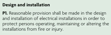

So in short do just vertical chases comply with part P
Vertical chases can be used in some situations.
This is Part P:
be safer if so I need to drill holes in future to hang stuff.
If you drill into walls containing electric cables, those cables will be damaged.
The direction of those cables changes nothing.
