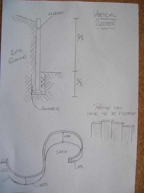

I'm going to use vertical sleepers as a retaining wall.

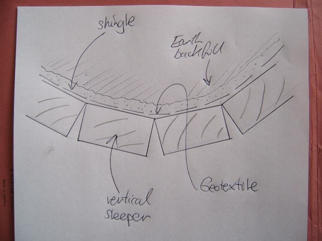

Will I need to fit geotextile to the back of the sleepers, then some shingle and then backfill with earth?
I thought the geotextile would prevent seepage of earth getting through the gaps.
Thanks.
Yes, but I believe it goes between stone and earth. Otherwise the earth will wash through the stones and clog them up. Drainage pipe at the bottom would be handy.
Agree with what Deluks says. Though drain pipe shouldn't be needed if the wall isn't waterproof (so gaps between the sleepers will let plenty of water through.
I would be concerned though with the verticallyness of them. Could potentially be pushed over with that much height. If possible, a slope would be good for strength.
You'll get a lot of strength from the lack of straight lines but I would advise screwing galanised strip (such as http://www.screwfix.com/prods/38619/Building/Builders-Metalwork/Builders-Band-20mm-x-10m) round the back to hold them together.
Thanks Deluks - geotextile between stones and earth - that makes sense.
- how can I stack a vertical row of shingle behind the sleepers, and then hold the geotextile in place? or are you sggesting the shingle is laid, say 1/3rd up the back of the sleeper?

Dont need a drain behind as the wall will leak like a sieve..
Dont need a strap to tie the timbers together as its designed like a contiguous wall, but probably wouldnt hurt.. as the walls get a little bouncy when fairly high..
Geomembrane should be permiable and shingle isnt such a bad idea as it will filter alot of the silt outta the soil behind.. build up the soil/shingle up in layers after the post foundations have cured..

To be honest i was more suggesting the contruction methodology rather than the whole system.. you will probably find the logs more expensive than sleepers.. but the flip side would be they would be easier to form your S shape.. check the prices.. there are tons of suppliers not just the one i linked..
I think the logs would give a much slicker profile and definately easier to install.

I'd say don't cement the bottoms, as it just seems wrong to me. Get a few friends to lift them. They are chuffing heavy if you buy the real sleepers.
