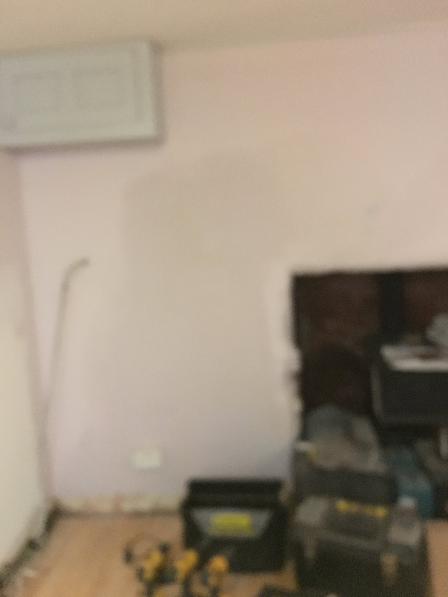

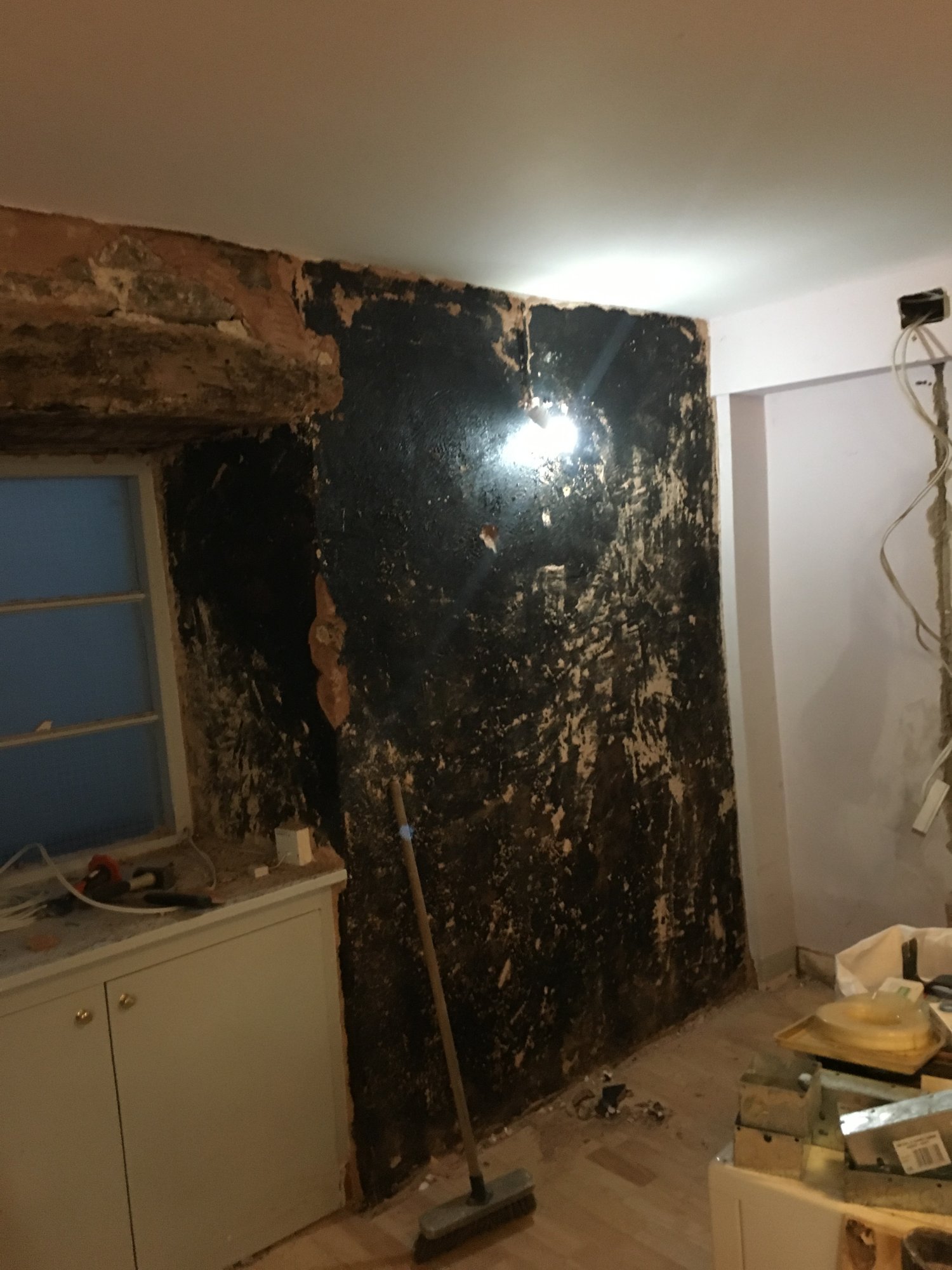

First pic shows the bitumen wall
I am going to expose the stone and repoint with lime
Second shows the damp rising up
The plaster goes down to the solid floor so can prevent that contact
It's the vinyl paint that must be making everything worse that I want to remove but don't know how to
I can see the interior bitumen covered wall, and next to it a plastered wall showing damp signs up to some cable chasing-in.
The damp is penetrating damp - or perhaps damp/salts associated with a chimney breast flue. Its obviously a long standing problem - any painting is incidental.
Wherever there is bitumen or damp signs then all the plaster must be removed back to bare stone or brick.
The cabinet unit in the window recess will have to be removed to expose the wall surfaces for hacking off.
Your second pic is hopelessly out of focus and not showing the c/breast wall in full - can you show the photos I asked for in my first reply?
