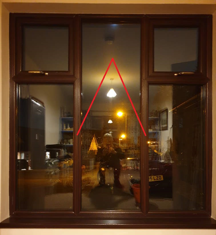

The window in my living room was 30 year old mahogany frame (approx. 6’ x 6’), which was rotting, so I saved up and got a new uPVC replacement put in yesterday.
Possibly too much information, but I suffer from a kind of PTSD, and find things like this very difficult and stressful. Anyway, job got finished eventually, and looked good, so I spent a good part of yesterday and today cleaning the room, moving stuff back in etc.
Later, I sat down for the first time with a cup of tea, and sat looking at the nice new window… and thought the two middle members (whatever you call them) seemed to be bulging ever so slightly into the room. I put a straight edge against them, and sure enough, they’re both slightly curved – convex with respect to the room.
You probably wouldn't notice if you didn’t know, but I’m hypersensitive to things like that.
I then went and checked another room that they did a couple of years ago, and it’s the same, maybe even a bit worse. I never noticed it before, as that room is a workshop, and I work with my back to that window.
I've added a photo so you can see what kind of window it is, but you can't see the curvature.
So my question… does this suggest badly made units, or could it have been something about the fitting? Are there any potential consequences, or is it just a question of how much it annoys me?
I don’t see an easy solution – having to go through fitting windows in two rooms again would probably finish me off. So I guess, initially, what I need to know is what I’m dealing with.

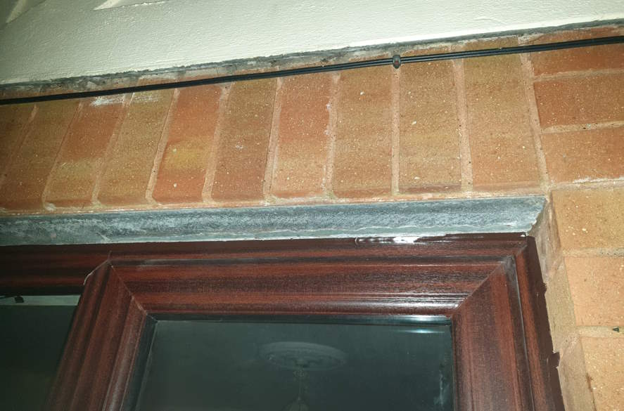

PS I Googled this before posting, and everything I could find concerned walls sagging on top of the units etc. This house was built in 1994, brick, decent quality I think, and if my attempts to drill above one of the windows to put rawl plugs in for curtains is anything to go by, has proper lintels.
Then I read that there can be internal and external lintels, so thought I'd better go outside and check that there's something above the actual windows... does this look like a steel lintel to you?
I'm no expert but the lintels look fine, no sign of cracking on the brickwork. I would expect the glass units to have cracked under the pressure required to bow the frame members.

Anybody know anything about windows?
If there's any way for you to put a straight edge / level on one of the 'middle members' as you call them and take a pic from sideways on, it'll give you (and folk on here) a better idea of just how bad the bow is.
It’s quite a tall window, I wonder if the upvc profile is changing shape slightly due to temperature differential between inside and outside. You could have 20deg inside and maybe 2 deg outside.
how much bow are we talking - 5mm or so?
the window has tall mullions, they would be quite flexible at that height.
It wont be anything to do with load from above - your windows would have been made small than the opening and then wedge up - if the bow is caused by compression it could be it was fitted with wedge packers and somebody put some right above the millions and hammered them in too hard.
