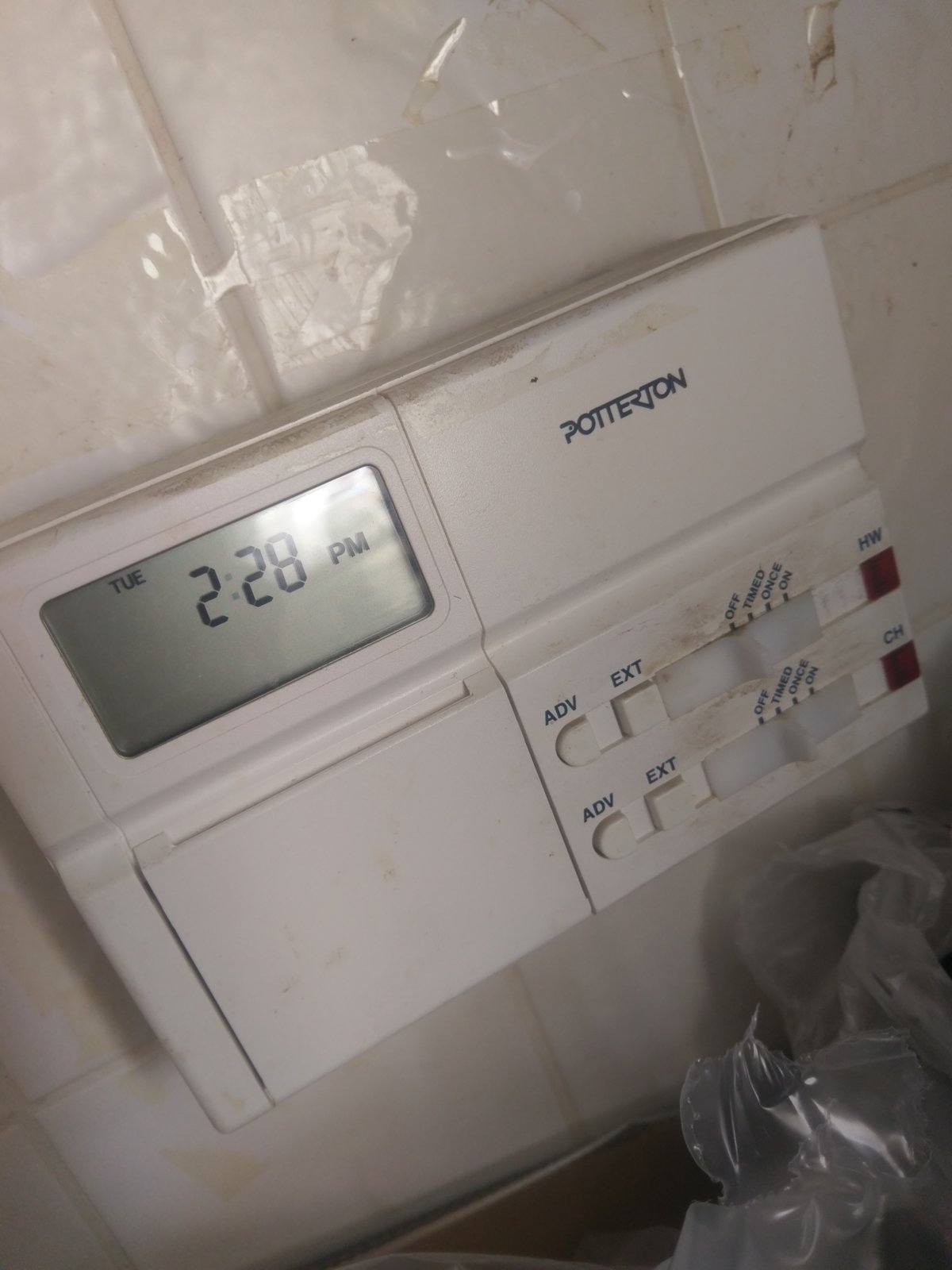

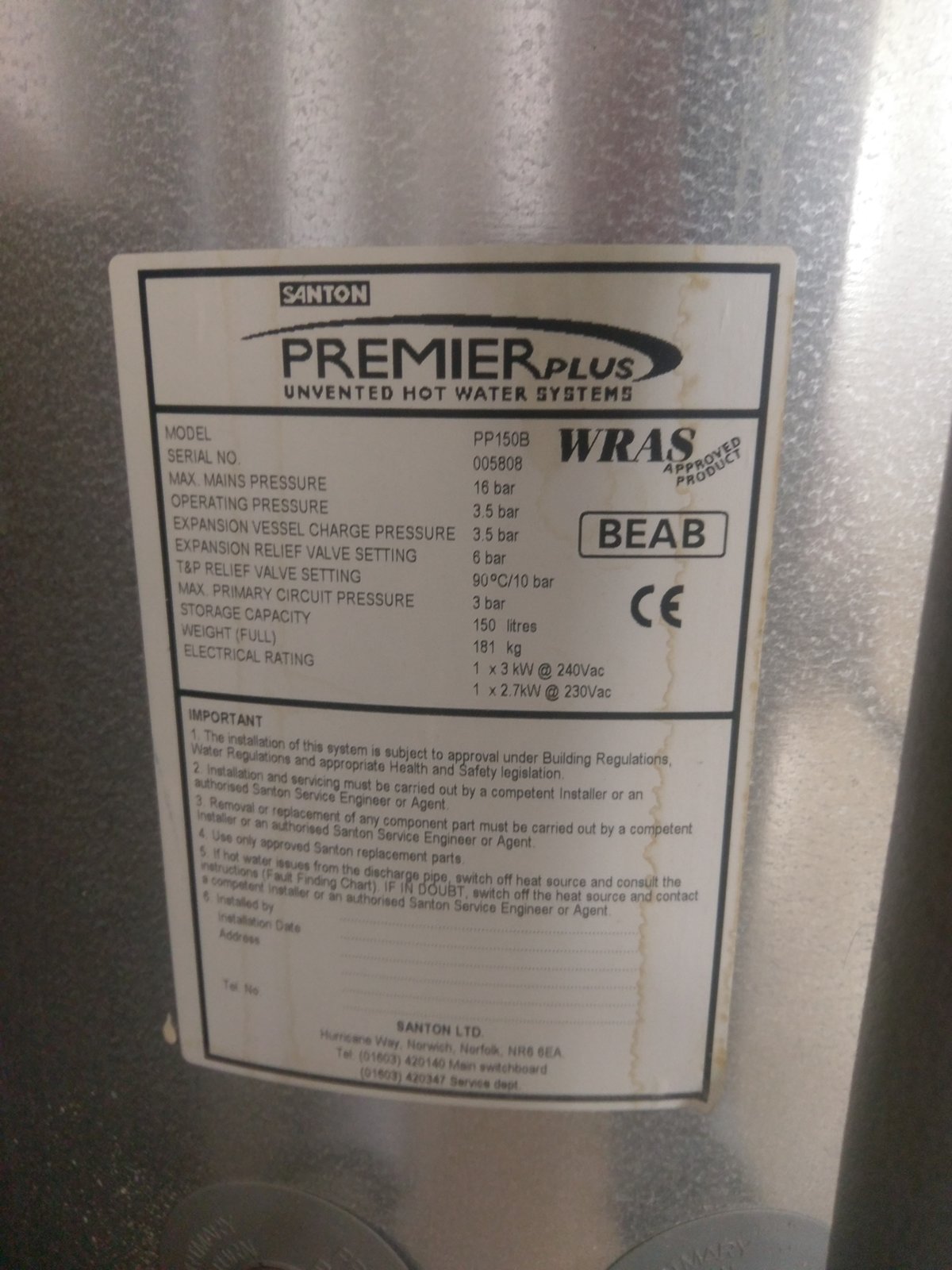

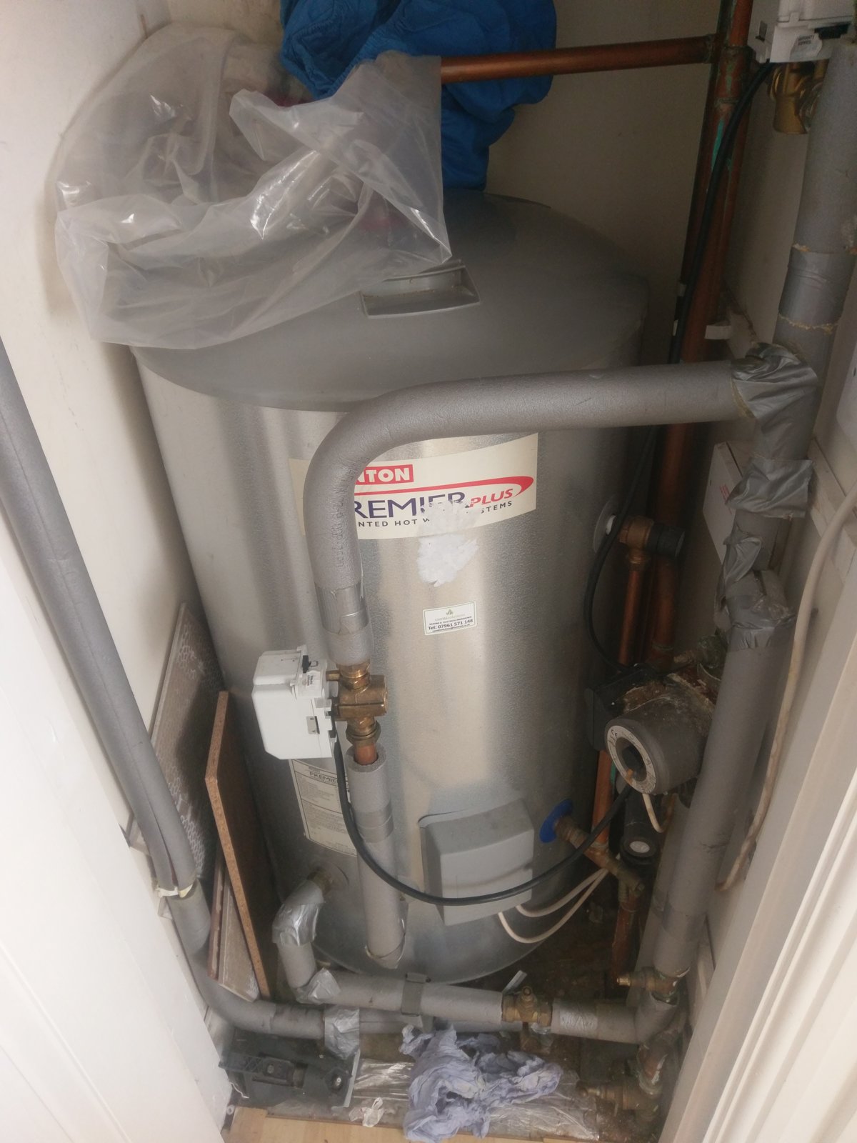

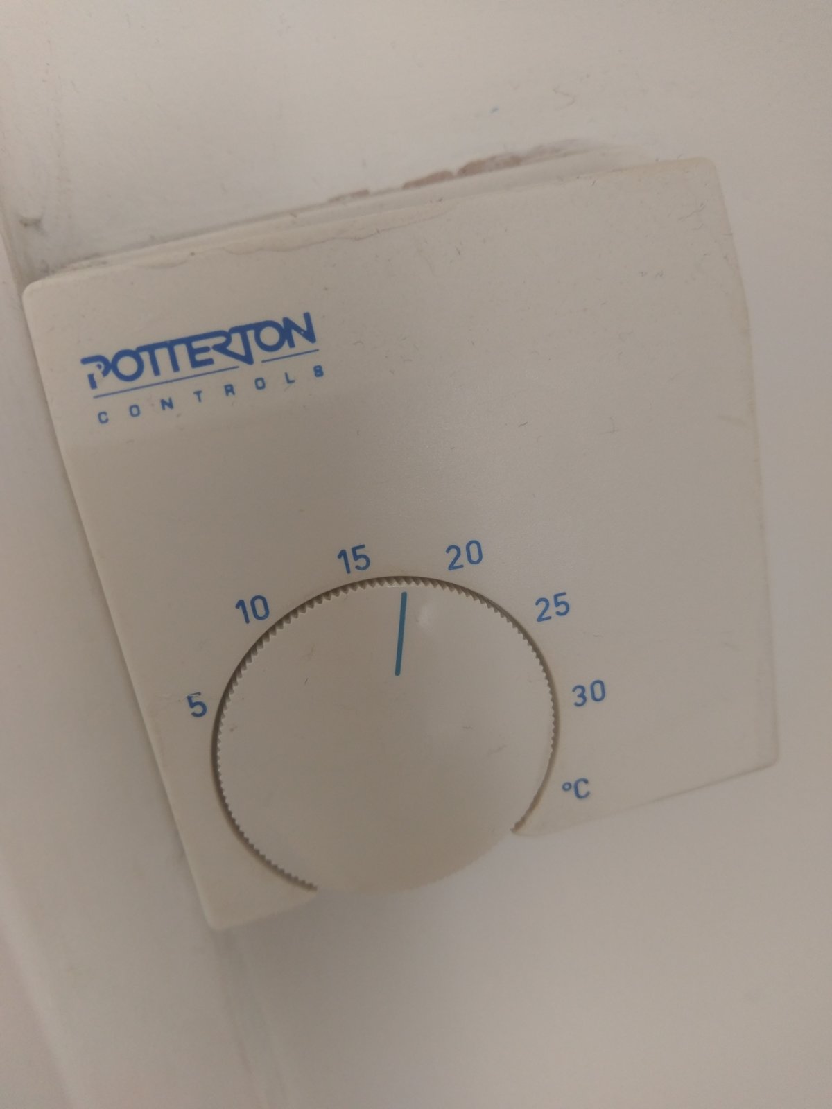

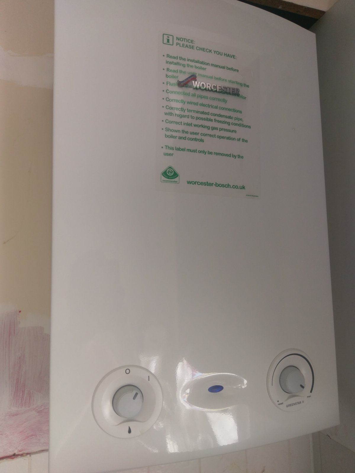

Here are some pictures which might help with my poor explanation.
You all definitely know more about this stuff than I do so I won't attempt to explain everything, but IMG9 is where the loud banging and violent 'vibrations' are happing whenever I have the CH on.
On the controller, I put the HW and CH to on and give it a few minutes is when the noises begin. It doesn't happen when just HW is on.
EDIT: I should also note I am renting this property and the CH used to work from December until around April. Since then I did not use it during the summer months and now when I turn it on, the chaos ensues.

Except that the cylinder should be heated by the boiler, and not by an electric immersion heater. Switch it off, unless you have money to burn.
Where is the leak coming from, and why haven't you had it fixed?
It's an unvented cylinder, so it needs a qualified engineer.
