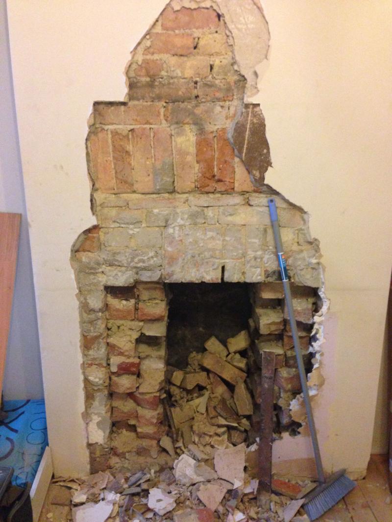

hi there
had a little more time to look at the fire place
decided i am going to plasterboard it up but leaving the hole there
the new photo the red box, that lower part of chimney is kinda hanging down can that come out?
and still the pink bit u think would be fine to remove?
thanks again

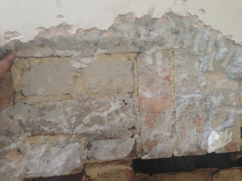

ok me again !
thanks for the reply, gave me confidence to keep hacking plaster off
so have found the arch
so basically under that everything can go
also the bricks on the arch the fronts have broken away, if i was to expose is there a way to make them look better? does that make sense
