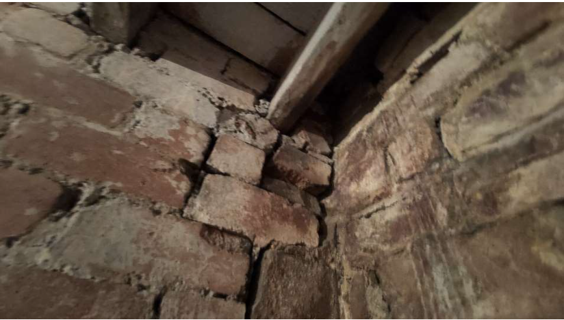

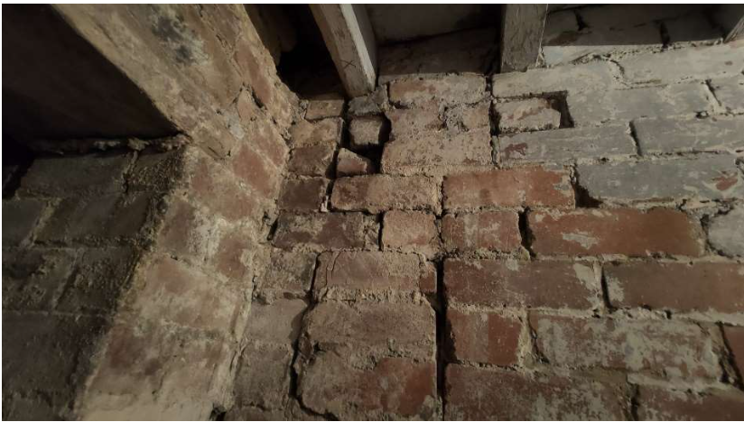

We are in the process of buying a Victorian house but have noticed the beam in the basement and the surrounding brickwork is loose. Parts of the beam also seemed 'spongey' which is expected as it appears to be old (not sure if its original). Would anyone be able to advise of causes and possible solutions? (attached pic)

spongy means decay and less to no strength so needs replacing as it holds the floor up
Might have been an old water leak. Mortar is absent between the bricks. Leaks can wash away lime mortar over time. Is it still damp?
As B-A spongy is not good and is NOT to be expected in timber, no matter how old it is. You possibly either have dry rot (very distinctive musty smell) or wet rot caused by water ingress, e.g. a leak.. Investigate and sort out the leak first, remove and replace the joist with a same size structurally graded (C16, C24, etc) new joist which is pressure treated, then clear out and rebrick the loose stuff beneath the joist with bricks and mortar. The joist cut ends should be treated with Enseal and in an ideal install I'd also want to "envelope wrap" the ends of the joists with something like roofing felt
Thank you all, I feared it could be related to water damage. Yes JohnD doing some reading I’ve heard the same regarding the mortar. Seems it’s a bigger issue than we originally thought
I wouldn't get too worried. It's an old house and it'll need maintenance. If it's just one accessible joist and a bit of loose brick it isn't anything to get too worried about. Easily sorted.
That's right - replacing a single joist in situ can be hard work, physically, but it isn't that difficult to do. Quite a common repair job in older buildings

Get a full structural survey and assess the likely cost of repairs from that; even if the buyer won’t drop the price you will have an idea of the additional cost involved.
