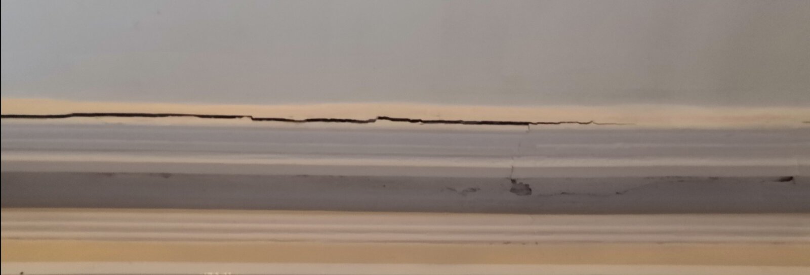

The previous owners were awful at property maintenance and it appears that an overflowing gutter left for years has caused this section of Cornice to get damp.
It now has a crack running a couple of metres.
The gap isn't too large.
I'd like to try and save it.
We are having work done later this year, if it falls down during the course of that building work, so be it, but, I'd like to retain as much as possible.
Recommendations please...
Looking for the best product that will bind the dropped part of the plaster cornice to the remaining that is still firmly attached to the ceiling.
If the product could be injected (like grip fill) and also something that I could use my fingers to prod into holes (like filler) would be most useful.
What would create the best bond and be workable?
Photos hopefully help explain.
Thanks very much
Not an expert but possibly something like casting plaster applied using a big syringe like thing? You might also be best to first deliver a load of water to the crack which may stop the injected plaster drying too quickly.?
If the plaster is runny it will flow behind cracks rather than just fill from the front, it dries very quickly so apply in small batches before it goes off.
I have used this (and specfically this) 'Wickes-Instant-Grab-Adhesive-Solvent-Free' for this typoe of job.
pros
As it is not solvent based I can wipe overfill off with a damp cloth
It is cheap - but does get expensive when hole is big.
Once it drys it does glue two surfaces together making area stronger.
Nozel makes it easy to get into areas like you show.

Cornices were stuck up using a mixture of screws and grade A plaster which is what the cornice itself is made of , to try and repare that i would use the same plaster and apply it using a busk also if its dropped a screw or 2 could be added, if that fails that section could be cut out a profile made and the section reinstated and it will look brand new
Screws? theres no screws holding it up. Thats an original cove run in when the house was built.
There’s no strength in it , it’s very crumbly , like plaster of paris.
looks a bit too deformed and loose to repair.
you could remove the loose material and rebuild the basic profile slowly using universal plasterboard adhesive and use filler and sand after to get it spot on. or remove a whole section and manufacture a template to ‘run it in’ as it was done originally.

That's running cornice.
Run in with templates by dragging along. Still done today.

i'd check that the (timber?) lintel is level and in good condition.
There's obvious hairline vertical cracks, & spelched plaster below which suggests lintel movement or pressure from the floor above?
From outside does the window opening head look level?
I'll stand corrected but I dont see anything to suggest that it was run-in on the wall.
Simple profiles like above were much cheaper to run-in on the bench or bought by the yard off the shelf.
