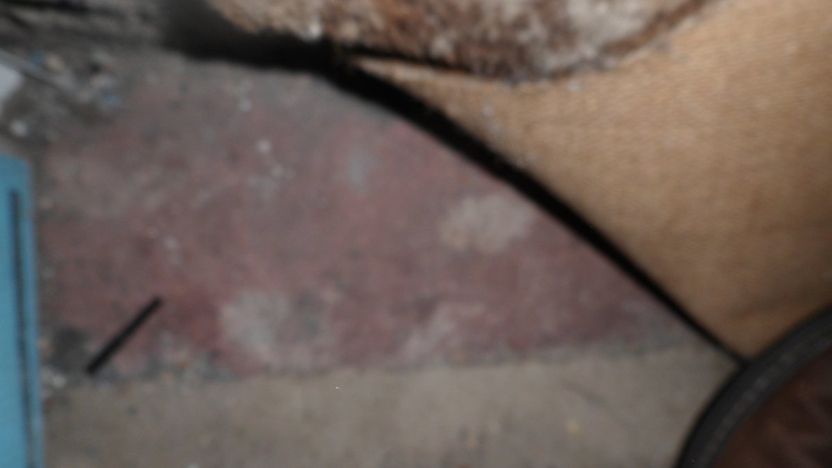

I recently moved into a Victorian house and the kitchen floor seems to have pink coloured concrete, i have notice this type of flooring in a lot of Victorian houses Do anyone know what type of flooring it is?

It's possibly victorian terrazzo - an in focus photo would help!

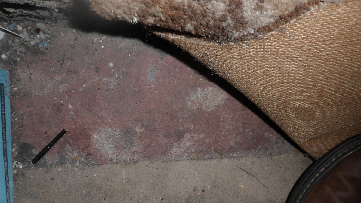

Here is a clearer picture the gray patches on the floor are just dust.
The floor has rough texture finish The floor hasn't been painted this colour because there no flaking.

Looks like asphalt to me same as what was used in most terraced house,s when people wanted to lay lino or oilcloth as it was self leveling, ish you prob find there are stone flags underneath it, which were not even enough to lay onto.

You have an asphalt floor - the red comes from the Magnetite that used to be added to the asphalt.
