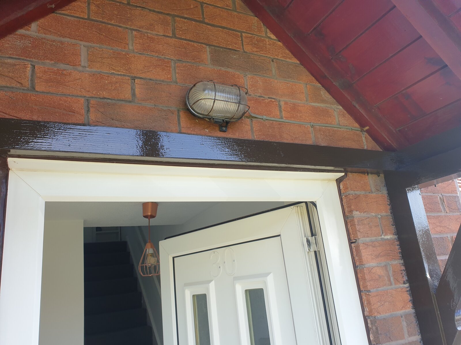

Got an outside light just above front door, would it be possible spur off this cable to fit a transformer which would then feed a ring type video doorbell?
Would make it convenient as no drilling or feeding wires into the house, I just need to know how to do it properly.
Could a transformer be mounted outside under this outdoor porch ?
You will likely need a box for the transformer, and swap the bulb for a smart bulb so you can turn off light without turning off the door bell, I found with a fitting like that I needed a candle bulb as standard one too long, found this one says 106 mm long standard one 120 mm long, check clearance.
Find a permanent feed
That light switch only will have a switched live
You have such a old light no offence!!
Had one of those back in the 90's
You mention the light switch, is this a mis-print?
Nothing old about those lights, fitted 8 last year on a house.
My bad. I meant the official bulb itself
Olly you could dismantle the light and figure out if you could shove a single core cable from the light fixture to the switch. Which would probs have a permanent live. Try putting a screwdriver and wiggling the hole which already the wire is placed in.
The light runs back to a switch in the entrance hallway.
So I'm thinking if the light switch turned off then it wouldn't give any power to the light or transformer for ring doorbell. I don't understand how running a single core cable from the light fixture to the switch in the hallway would help me?
Maybe I should just keep the light switch on and change the light to a sensor type one, that way both the light and ring doorbell are always getting power and the light just comes on and off when needed.

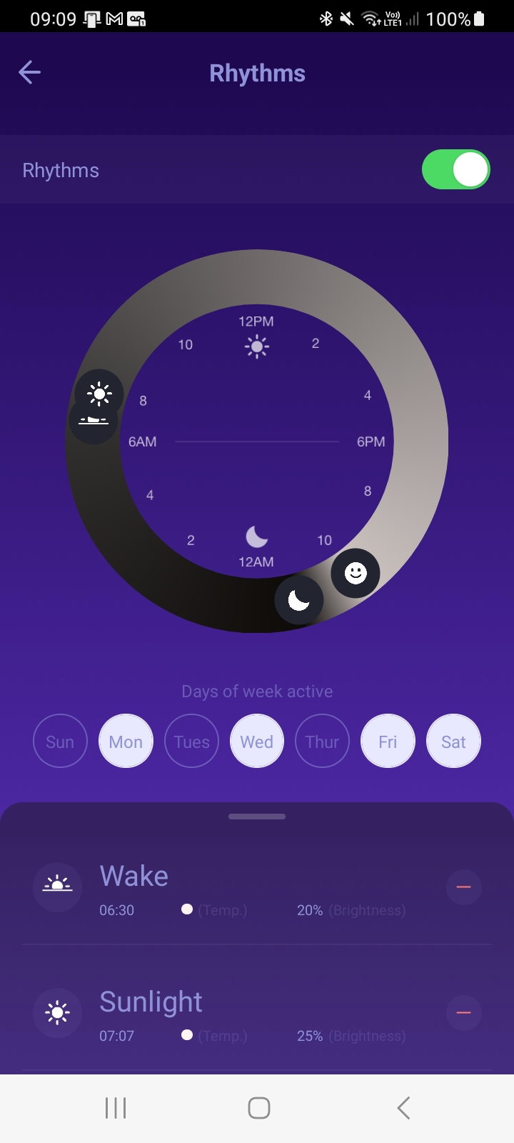

But when we wanted more bulbs and Lidi did not have them on offer we went to other outlets, wife got one odd one by Wiz which has a fade in and out feature, nice as not plunged into darkness, you get some warning, but in the main we got TCP, and I thought it was an antiseptic! anyway these don't need a hub, and have "Biorhythm" this is a screen shot 1686298301446.png this allows me to set it to light at dusk, then have an off time dead of night, then back on until dawn, the 4 days selected are when the milkman delivers milk, but now I am looking at yet another, TP Link, not got one yet, but seems it has a hub which doubles as a door bell, so it seems, not tested yet, that I can set it so pressing door bell turns on light and rings the bell.

The same of course with smart lights, I set them to switch off around midnight, there is one however the Wiz, where I can set it to fade out, so it gives some warning it is about to switch off, but it does not have other features, BioRhythms.jpg shown is the dusk until dawn with set off in dead of night which can be set for other bulbs.
