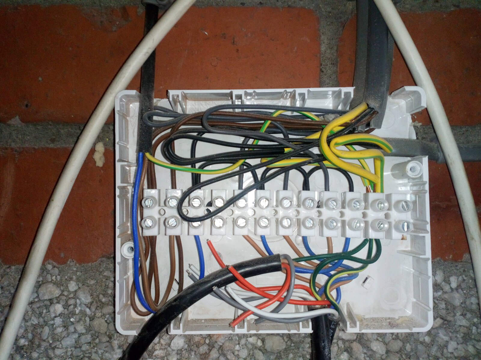

Hi Folks,
Looking for a bit of help here. We moved into our current house in 2018 and have always had a bit of an issue with the heating. The boiler is a Viessmann 200-W WB2B system boiler, and the central heating is split into the zones, each controlled by a thermostat. The boiler is plumbed as a two pipe system.
Along with huge gas bills, at times it seemed the heating would randomly come on, but never to full temperature...
The other day I popped off the cover from the CH junction box and was a bit surprised to see the following...
The three black cables coming in from the bottom are from the motorised zone valves for the central heating. (the DHW valve doesn't pass through this box). As you can see, the orange and grey wires are left unconnected... Also , the black wires coming from the thermostats are left unconnected too.

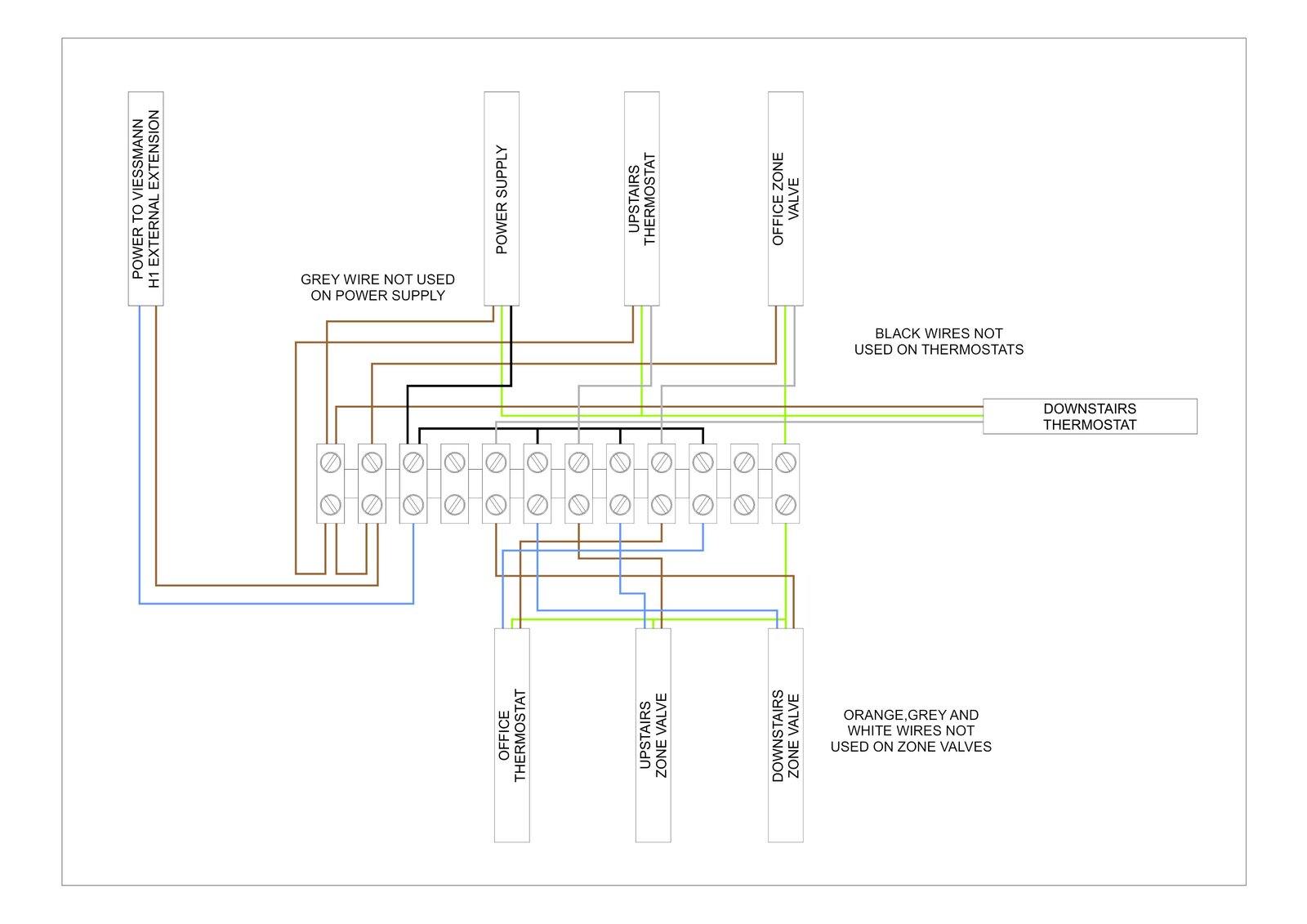

It's maybe not the best diagram, but here is what we inherited...
Now, to me it seems the thermostats don't actually talk to the boiler - from the junction box there is power to the Viessmann H1 External Extension, but no other connections.
So when the thermostats are turned up and click, the valves open and when the thermostats are turned down and click, the valves close, but they don't seem to tell the boiler this.
So it turns out the odd times of luke warm heating are caused by the central heating valves remaining open when the heating is off, but the DHW is on and in turn pumping round the central heating system.
Now I've figured this out I can stop it by turning the thermostats right down to zero when the heating is off, but it's not really practical.
So my question is... Normally, do the switches on the valves normally tell the boiler to fire when they are open and in turn the boiler tell the valves to close when the central heating is off?
The DHW pump and central heating pump (maybe the DHW recirculating pump too - I'll need to check) are all wired through the Viessmann H1 External Extension which in turn is connected to the boiler using the KM Bus. But there seems to be no connection to/from the thermostats/valves.
Surely they should be connected some how?

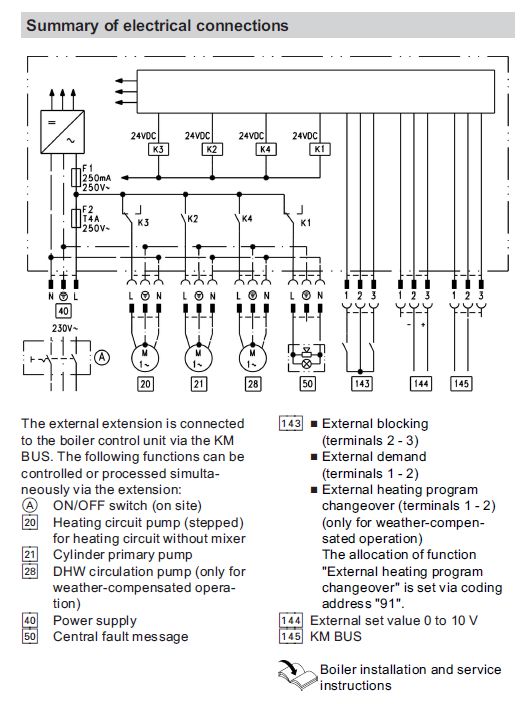

In the Viessmann H1 External Extension, there is a connection numbered 143 which in the manual is described as external blocking/external demand. There is nothing attached to this. Is this maybe where the valves/thermostats should be connected?
Obviously all this depends on readers knowing a bit about Viessmann boilers and components, but any advice would be very greatly received.

Not with the H1 extension, the grey and orange wires are not used
Hi Ian and thanks for joining in. So what is supposed to tell the valves to close? If the heating has been on and the house is warm, when the heating goes off it needs to get pretty cold before the thermostats themselves click and tell the valves to close. At times this can take long enough that he next heating cycle kicks in and leads to a situation where the valves never close... I would have thought once the boiler was finished it would somehow tell the valves to close so there is no cross flow of heated water when DHW kicks in. So without there being wiring from the boiler to the valves themselves I can't see how this is supposed to be done. The H1 takes its power from the junction box wiring, but nothing else.
If it helps, nothing is connected to the 143 terminal in the H1 Extension - in the manual this is referred to as as External Blocking/External Demand.
Any help offered greatly received.

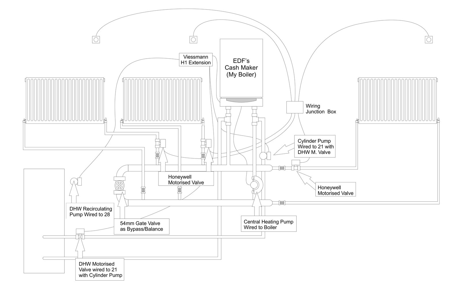

Okay. I've put together a diagram of how the system is laid out - as the DHW does what I want it to I've left that part of the system simplified.
Hopefully it makes sense, but bear in mind it is more pictorial than real life. As i said earlier in the thread there is a 54mm loop that the three different central heating loops tee off of and onto, each with their own Honeywell motorised valves once its dropped to 28mm. They also have gate valves on the flow and return tees. These motorised valves however are not wired to either the H1 Extension Unit or the boiler - the orange and grey wires have just been left loose. I've attached the H1 Extension manual, which to me would suggest they should be wired to the 143 terminal.
The fact the orange and grey aren't wired to anything just seems odd as there is no communication to or from the boiler to the valves, but then there are some other oddities too...
Looking in the H1 Extension, the central heating pump, a Grundfos Magna 32-100 180, isn't wired to terminal 20 as the H1 manual would suggest, but is instead wired to the boiler. Unfortunately I don't know which terminal in the boiler as I'm not allowed to look, but that's where its cable goes, I assume to the internal terminal 20.
Also, the DHW motorised valve is wired to terminal 21, the same one as the DHW cylinder pump. Not sure this is normally done and it does seem to work, but the manual doesn't mention doing it that way...
Terminal 28 has the DHW recirculation pump wired to it.
I have contacted Viessmann (who's willingness to help I can't fault) and they said,
"...if zone valves are on the system that require a 240v power to open them, then this could be taken from the plug 20 (pump output for heating). It may be that a bypass may be required if the valves close. As mentioned previously the internal pump may still run to monitor system flow temperature or for overrun after a demand has finished - this may be the reason why the original installer left the valves open."
Now that kind of makes sense, and there is a bypass valve of sorts, albeit a gate valve - fully closed (20 turns) then turned back 4/5 turns - so the pump shouldn't really deadhead when/if it overruns.
The other odd thing as I said there is nothing actually connected to plug/terminal 20. The central heating pump is directly wired to the boiler for some reason. I have a feeling the fitter enjoyed soldering much more than wiring.
Anyway, I still can't work out how a weather compensated Viessmann 200-W WB2B boiler is suppose to tell central heating motorised valves to open and close and vice versa - mine simply aren't connected to one another. My logic would suggest they are meant to go to plug/terminal 143 in the H1 extension.
I know as a weather compensated boiler it should in theory say "hey, it's a hot day so I'm not putting the heating on", which it does, sort of, but the problem is the valves - nothing tells them to close on a hot day or when the boiler isn't firing. And the thermostats are pretty pants to be honest - unless they are turned way down, the valves stay open - and so we end up heating the central heating with DHW...

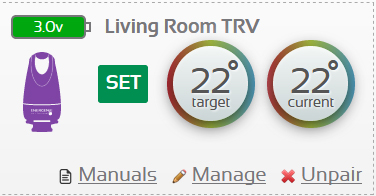

With a TRV head that reports target and current TRV_report.jpg then the user can close the lock shield a tad if the current exceeds target, and open a tad if target rarely reached, but they at least need a TRV head which works with °C. The eQ-3 only shows target, so not as easy, but with a thermometer at least one has a chance.
As an electrician I have lost count of the times called to a faulty wall thermostat only to find the lock shield valves wide open. Thermostat working A1 but could not deal with the hysteresis caused by the lock shield being left wide open.
Clearly if the central heating installer had done their job, I would not have been called, so likely I am seeing just the bad installers work, the evil men do lives after them the good is often interned with their bones. So we don't see the good installers work.
