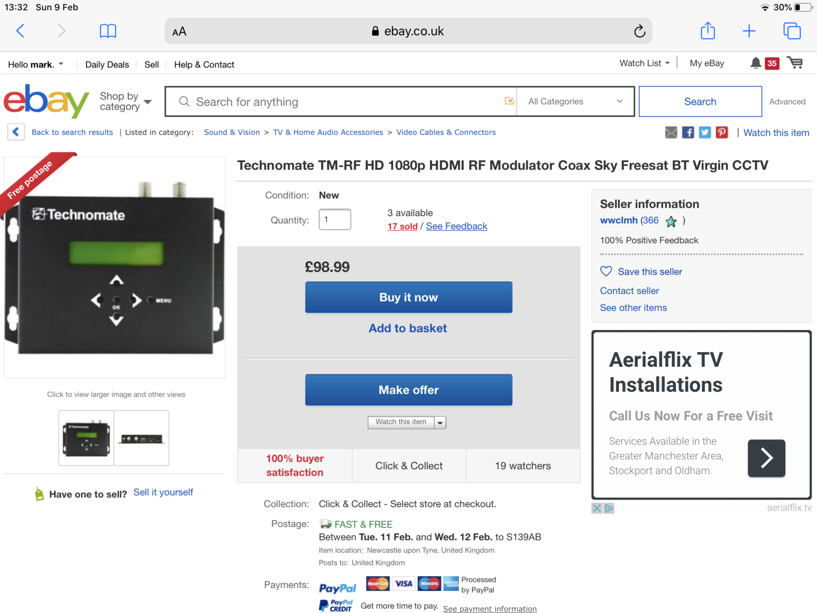

Nope ....Options ....run hdmi cable ....dvb modulator fed into tv aerial system or cat 5 over hdmi
775A5A39-71FE-47DA-BD0B-EEADB2743381.png Your tv must be able to receive....eg ...bbc1 HD via aerial For this to work
