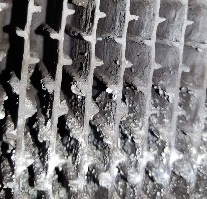

But like most aluminium heat exchangers can suffer from erosion when the boiler is condensing and producing condensate on the surface of the heat exchanger.

Not much erosion there, and there are some still going strong after 25 years of use so it's not an issue
I am led to believe that picture was taken when the boiler was 6 years in service.
I know the amount of erosion is greatly increased if the return water ( from rads ) is cool enough that liquid condensate is formed on the surface of the heat exchange.
If the return water is hot enough that condensing does not happen then there will be very little erosion.
Another factor is the layer of oxides and other compounds that form a layer of thermal insulation between flame and heat exchanger, How much does this affect the efficiency of the boiler ?.

The hex in the photo could do with a service, all boilers need one annually stainless or aluminium.
