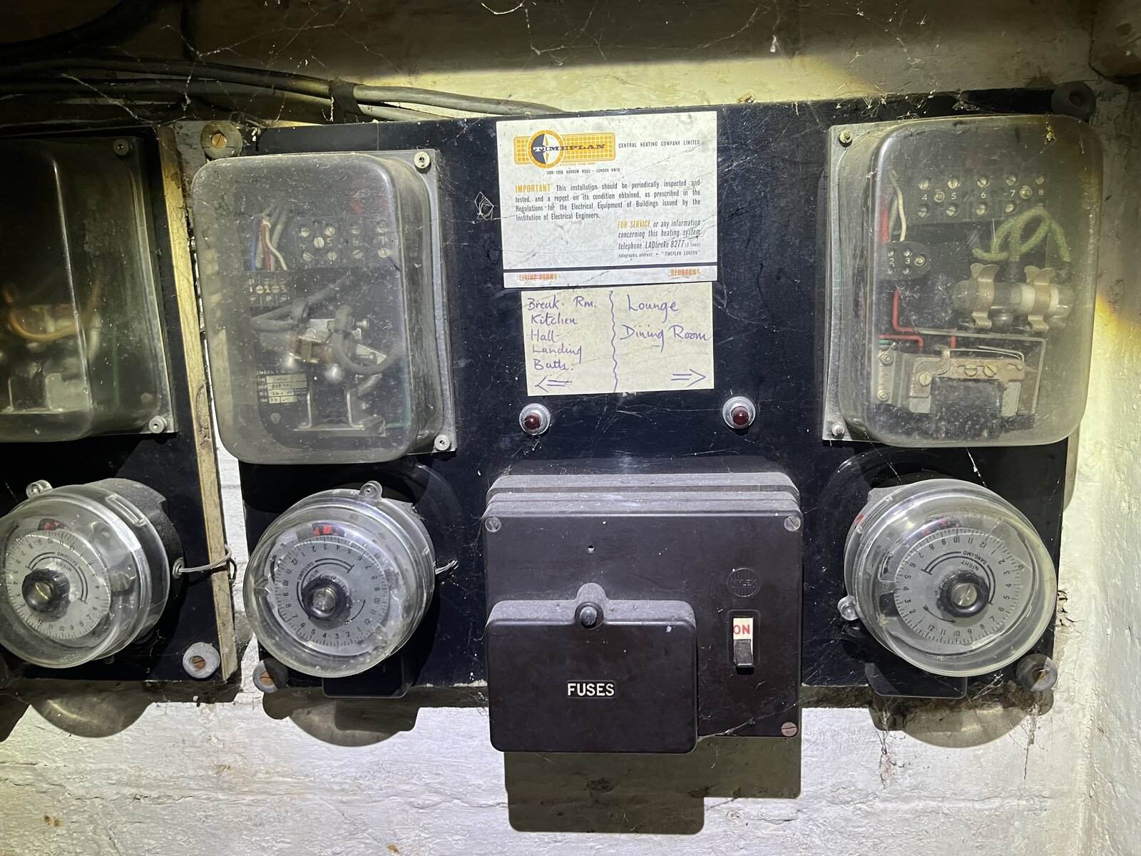

Does anyone have a manual
I doubt a manual exists. You have two time switches controlling different areas of your house. The large boxes are mercury contactors (relays) they are there to switch the heavy loads of (possibly off peak) storage heaters. Do you know what tariff you are on. As it old, maybe economy 7 or some other low night time tariff. The time switches show different times so you need to get your head around what you have. You may need (an old) electrician to advise. It certainly does not fully comply with today’s safety regs.

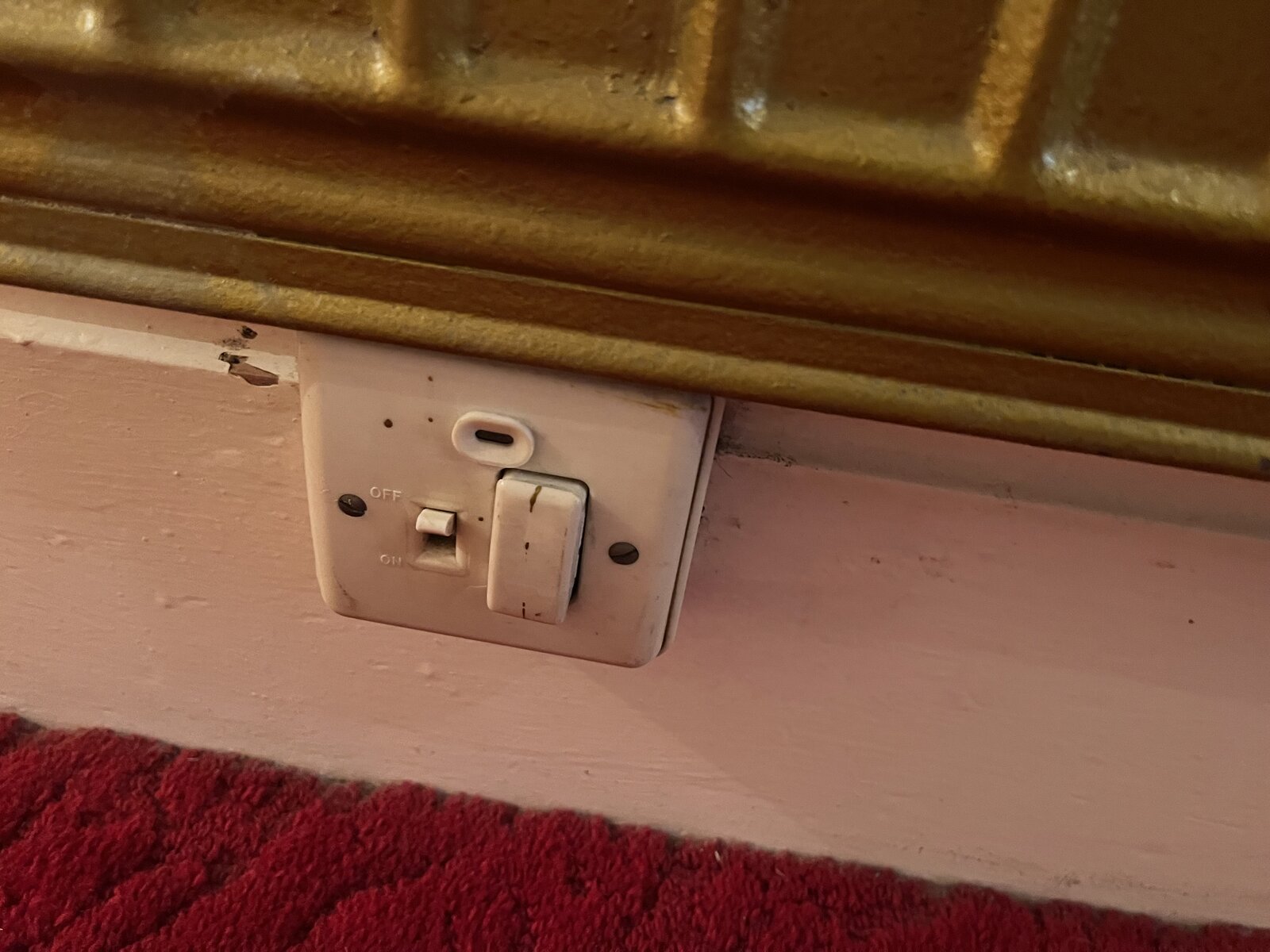

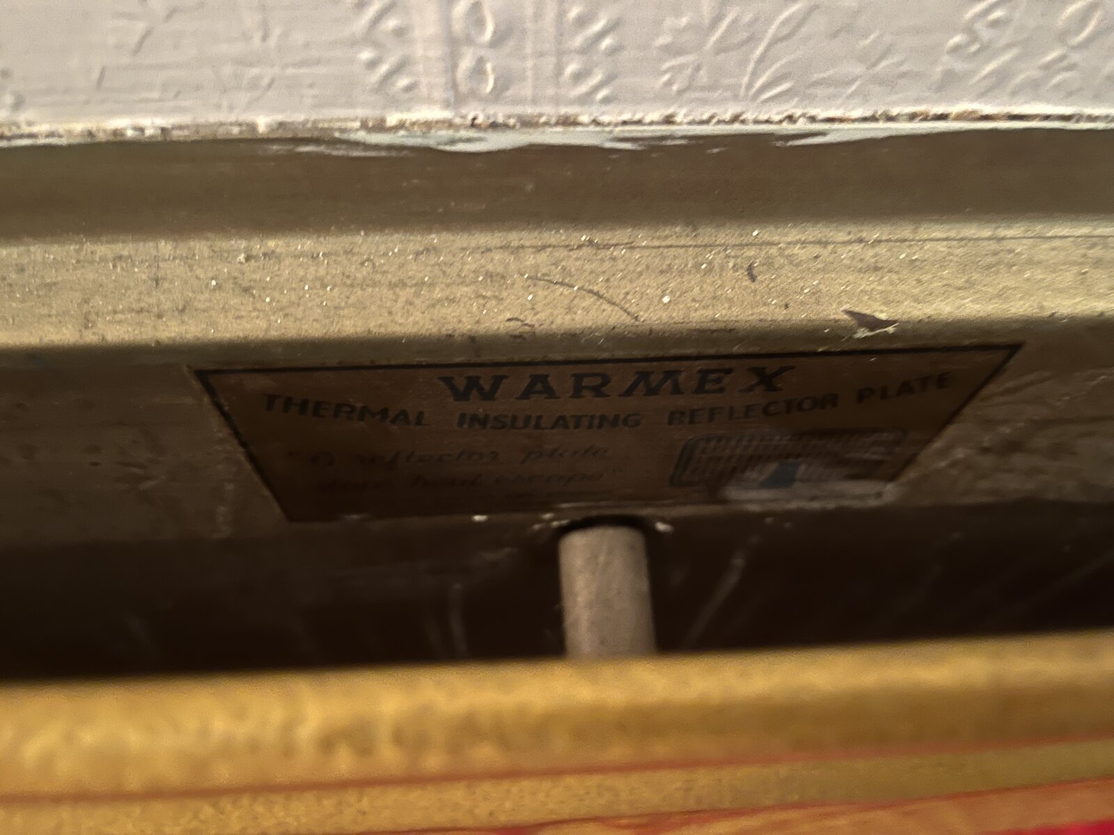

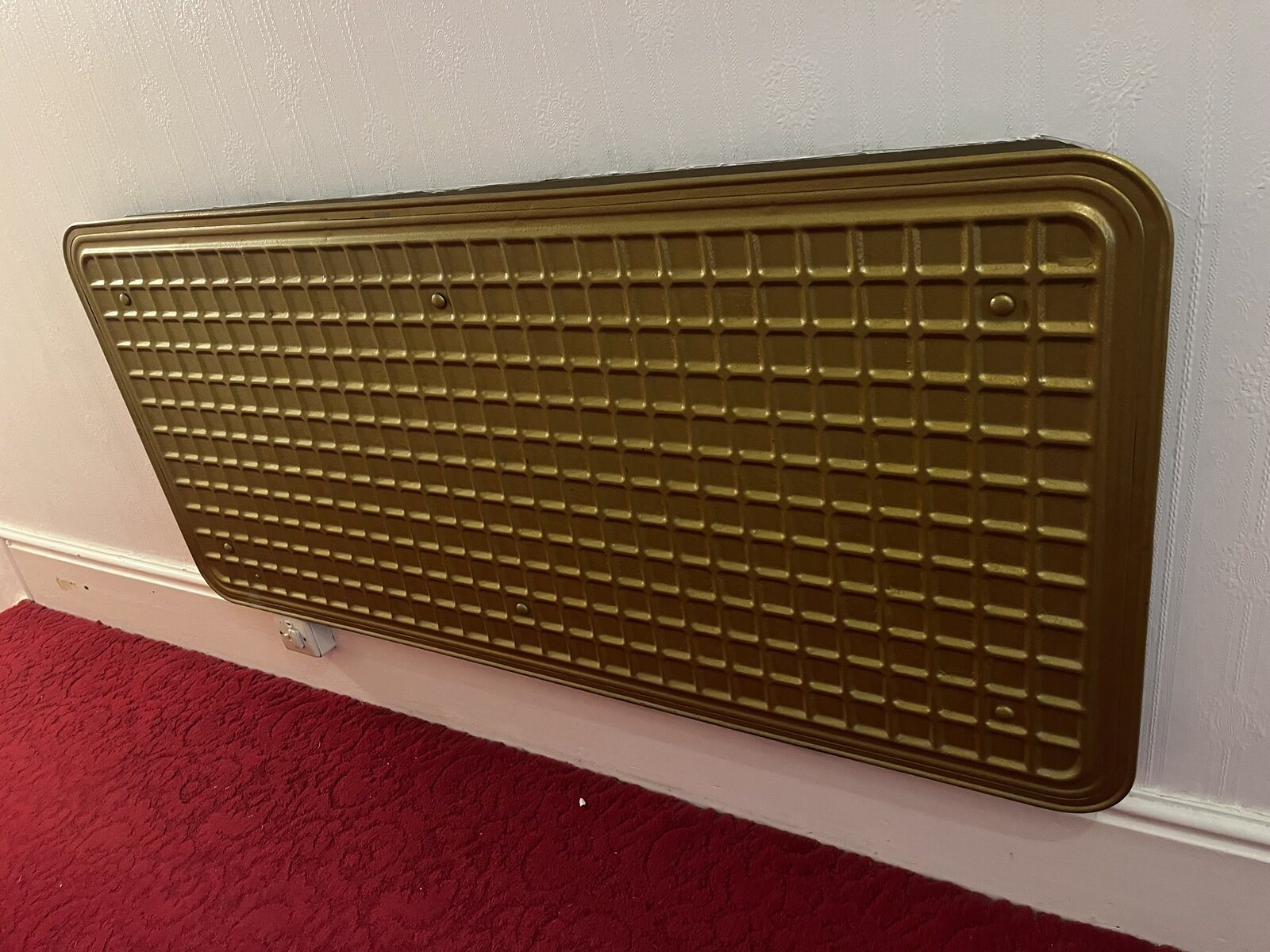

Cheers… this is one of what it runs

I asked for an old electrician…. And the oldest I can find is 46! Haha. Too many old electricians not working these days. Must have made too much money
Yes that one looks like an oil filled rad. That would not store heat so is of little benefit. The installation looks to me like late 50s. I’ll do the maths for you ….70 years!!!! Time to get a younger spark in and quote for a new system if electric is what you’re thinking. Just don’t expect him/her to know what a mercury contactor is.

But the radiator you show does not look like a storage heater, so it will need some thought on how to use it.

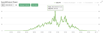

Our homes are also heated by the sun, and if I look at yesterday
this varied through the day, so in winter months the heating needs to vary the reverse to maintain a constant temperature, even water filled radiators are slow to respond, it is not the storing of the energy which is the problem, it is lack of control when releasing the energy.
