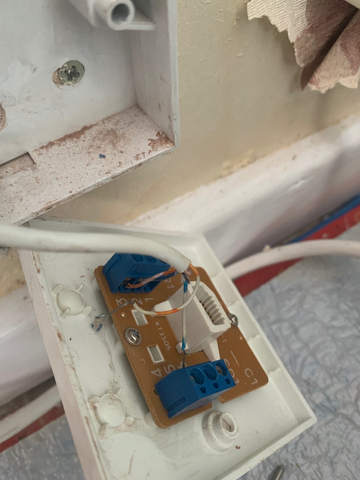

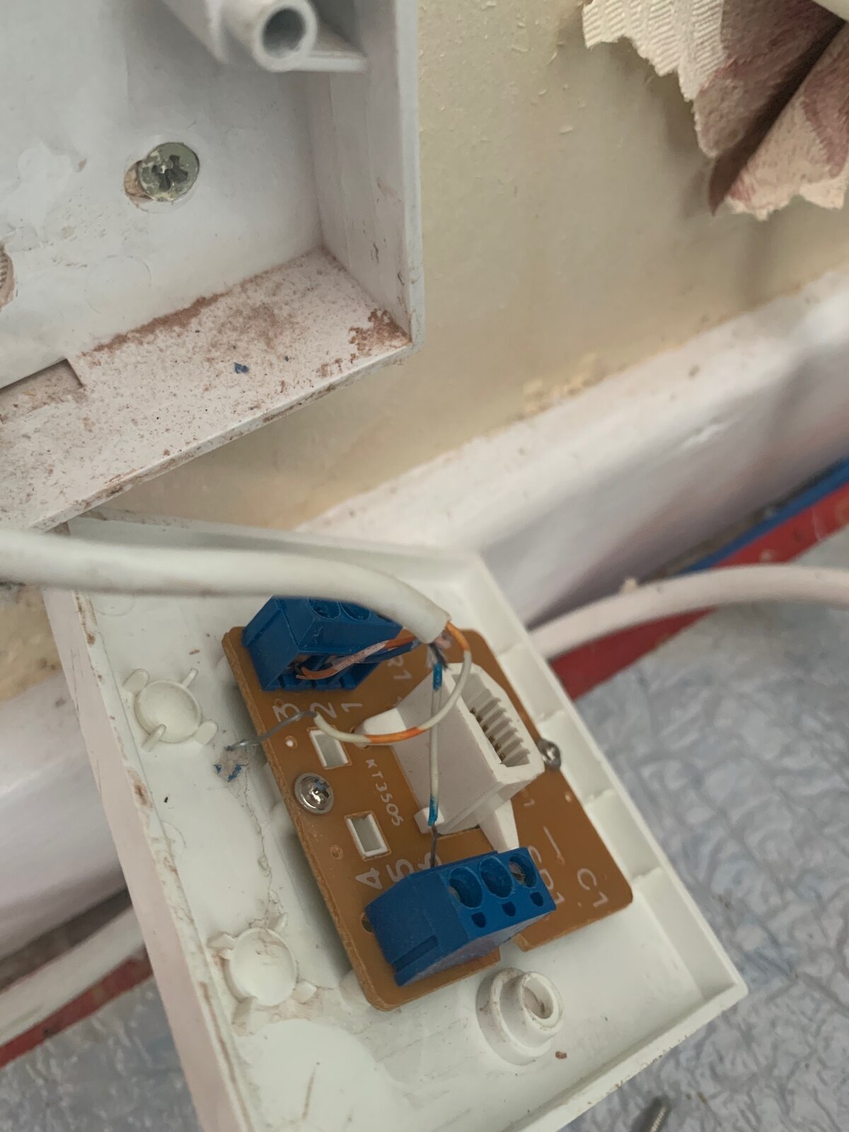

I re-decorated an upstairs bedroom which had a telephone extension (see Photo 1), or I assumed it was an extension. This extension hasn't been used for years so I decided to disconnect it. I then noticed a few days later that nobody could call in on the landline and the caller receives a message stating, ‘we are unable to connect your call’.

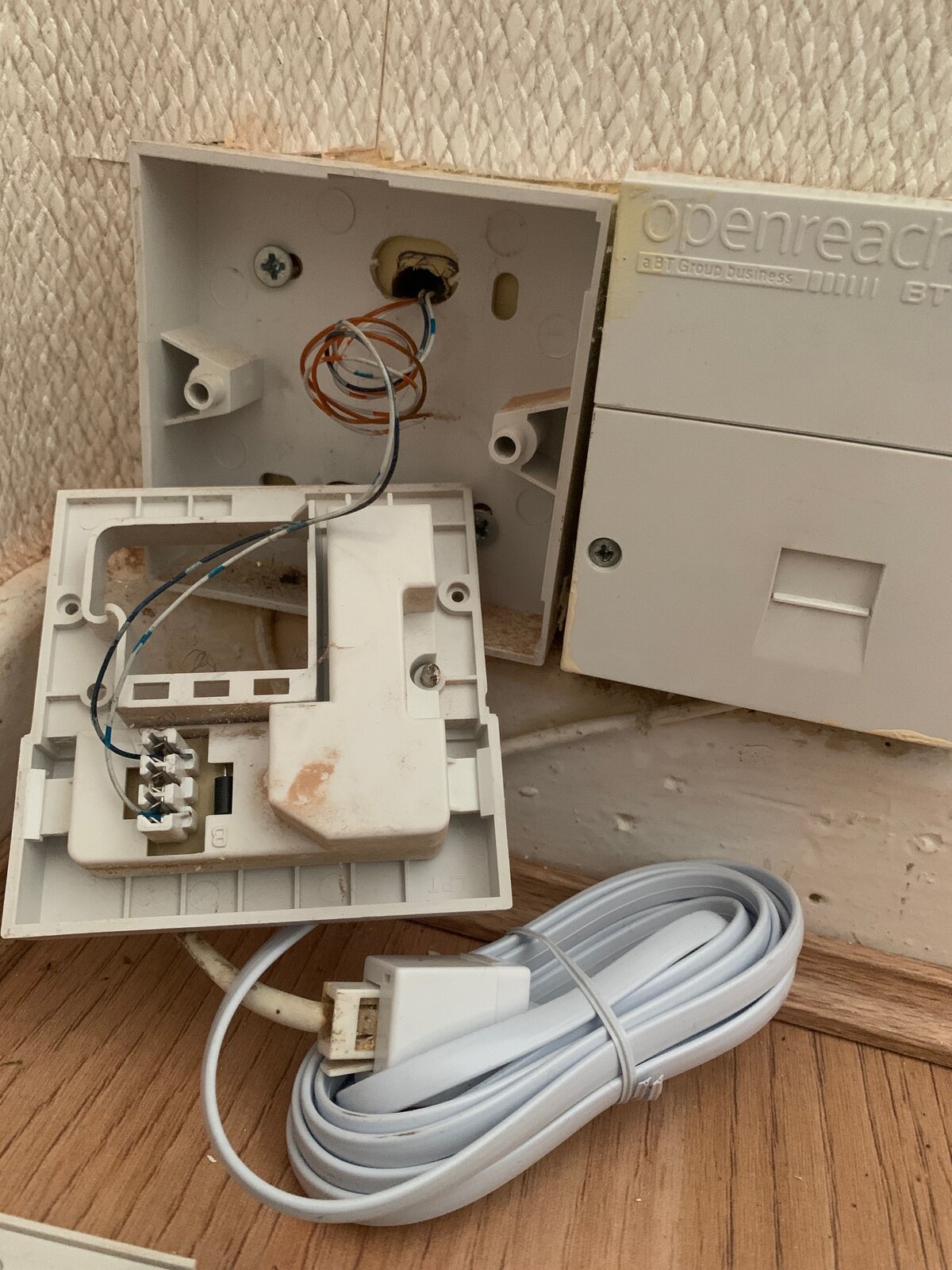

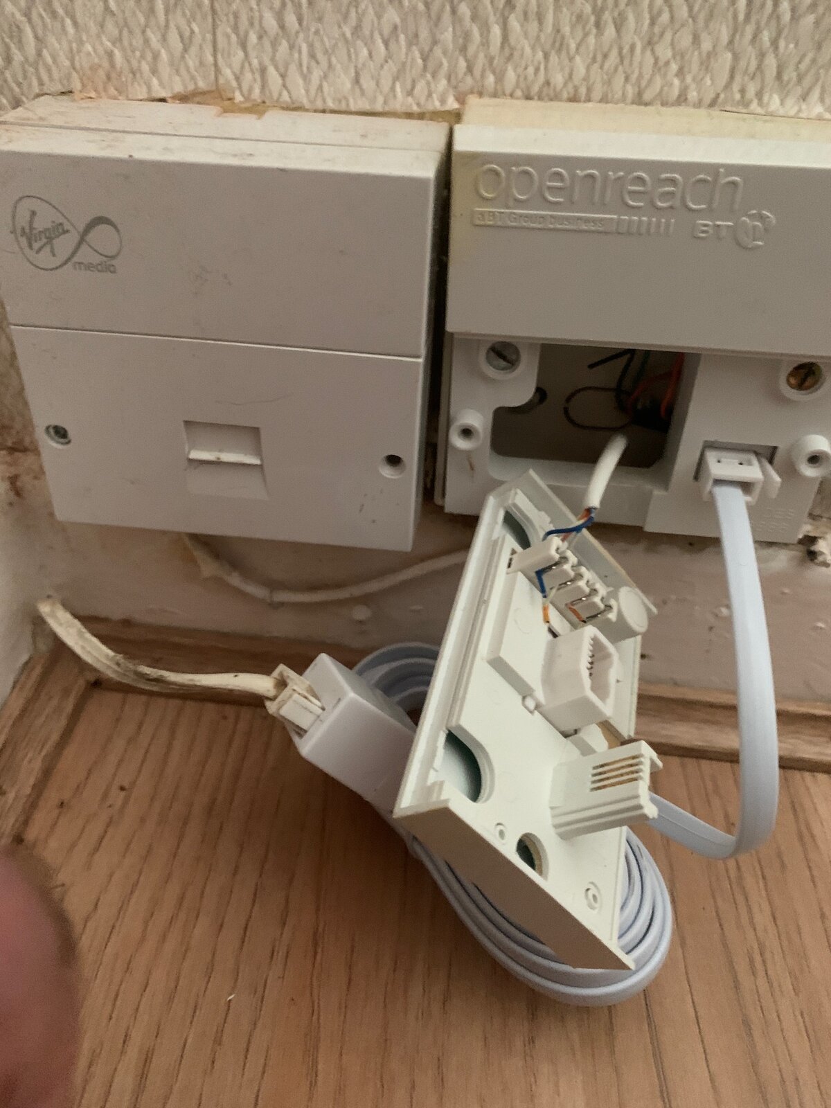

As you can see from the photos, we have a virgin box and a BT Master box downstairs. I assume the BT Master Box is redundant as we are on the Virgin network, anyway I did test it regardless and received ‘we are unable to connect your call’.

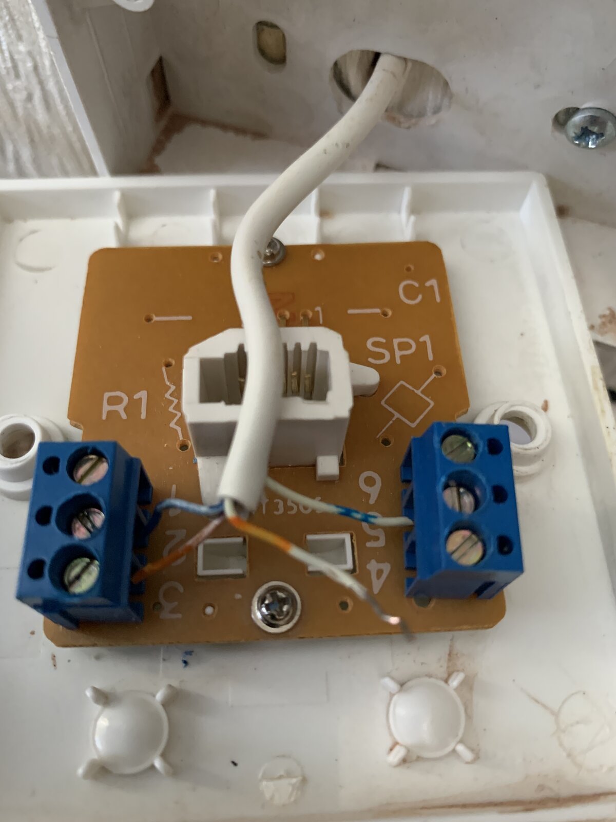

I then tested the Virgin Box next to the BT Master with the test socket and again ‘we are unable to connect your call.
The landline was working perfectly ok until I disconnected the extension in photo 1. I can re-instate the box and reconnect it in the bedroom to see if I can get it to work again but as I don’t use this extension box I would rather keep it as it is.

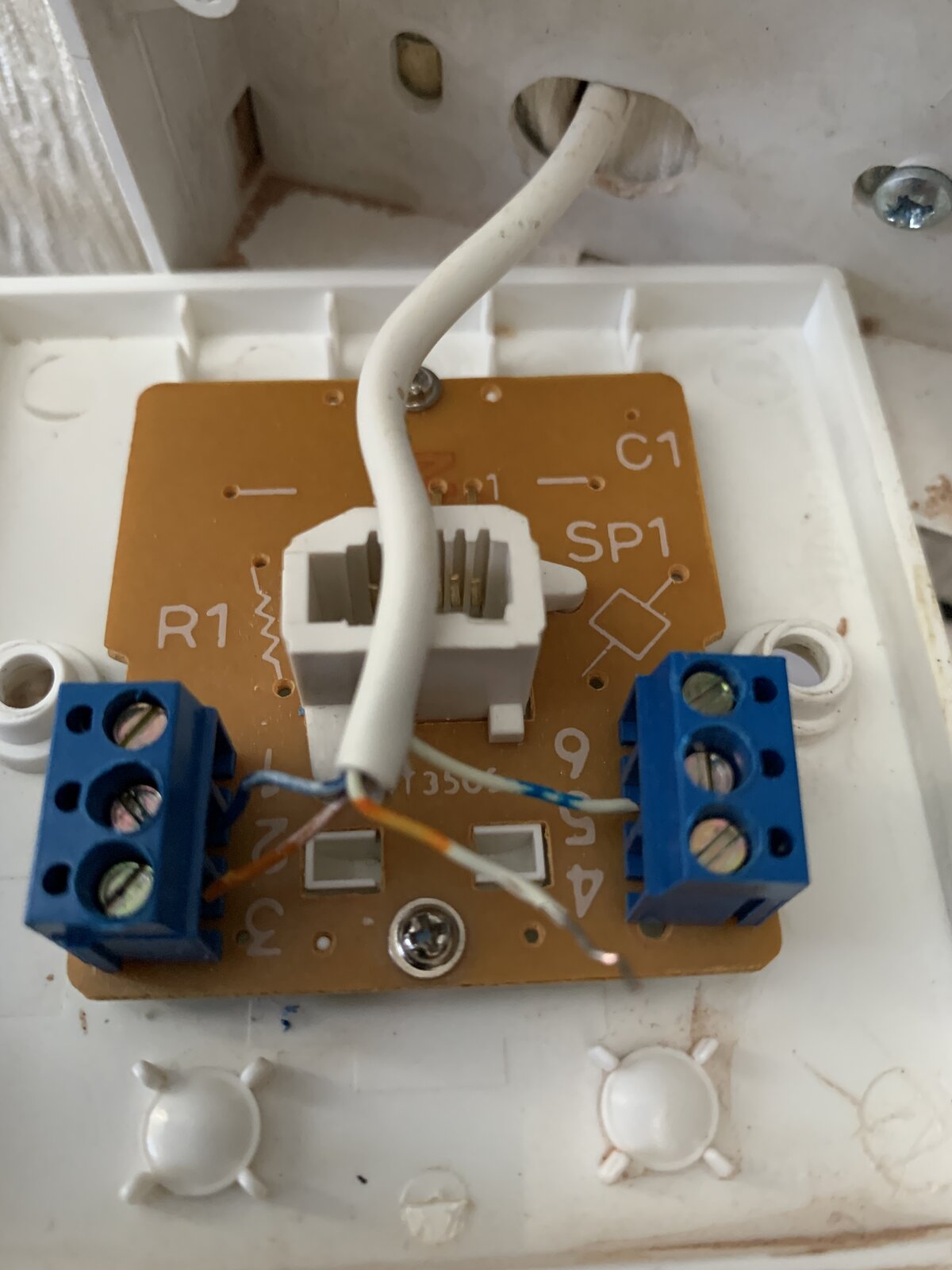

Image 2- the virgin box- I cannot see any extensions.
What happens in the bedroom if you reconnect 2/3/5?
Disconnecting has probably shorted one or more wires together.
Just removing wires would not result in a problem when calling in.
Reconnected 2/3/5 and the same problem. Not sure whats going on as it was fine before disconnecting image 2 in the bedroom

Found that i can make outgoing calls but not incoming.
I am only guessing, but it sounds like a network issue. You only have two cores running in to the main box. Your secondary box had 3/6/5. One of those 3 only existed for the legacy "ringer".
