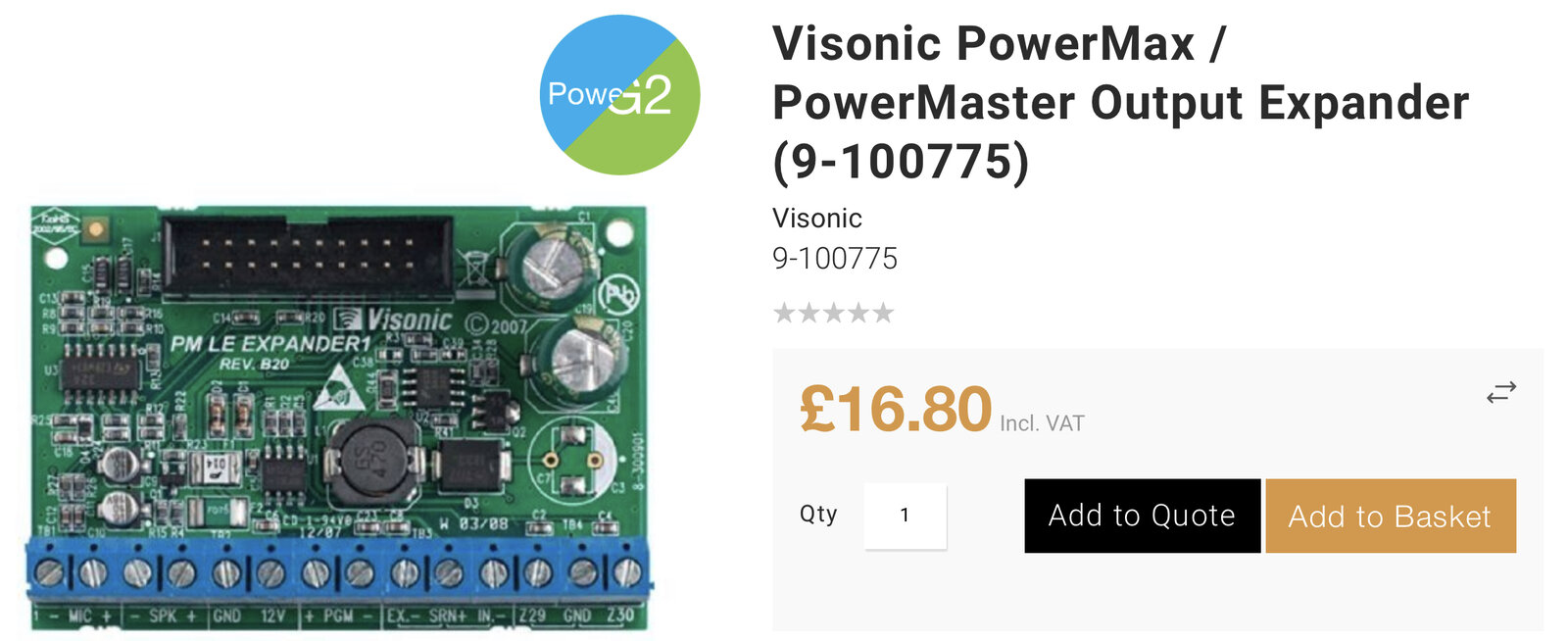

Thinking whether it would be worthwhile to go for a mains powered siren that would be compatible with the Powermax? I understand that there is a Visonic expander module that clips into the main alarm box for the cost of about £18, but what siren is compatible with it?

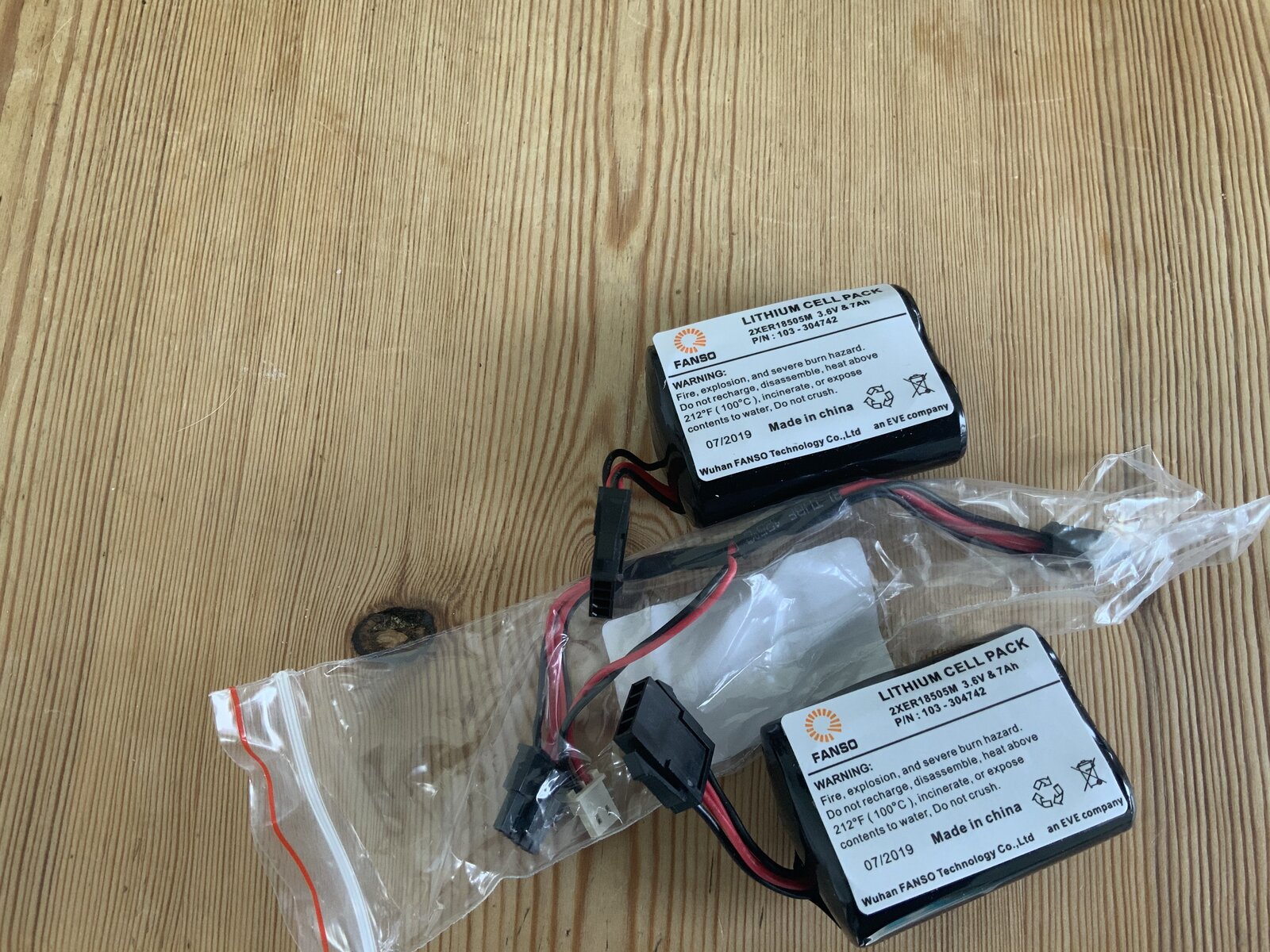

The battery is supposed to last for up to three years, so cannot understand why it only lasts for 12 months. This must have been the fifth battery that has been replaced in the siren in the last six years and they are not cheap at between £25-£35 each time.

Pictured are the new batteries for the siren

The battery pack is marked as 7Ah which equates to 0.8 milli Amps continuous load for one year or less than 3 milli Amps for three years. That is a very low current for a wireless receiver

Ok, thanks for going through that:D. But the original question that I asked was, can I fit a mains powered siren using the Visonic expander module which clips inside the alarm module? And which one?

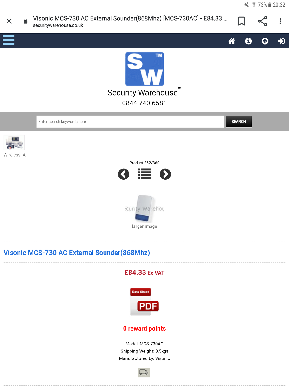

The MCS 730 AC bell box has auxiliary 12 volt input to connect a remote power supply.check to see if compatible with your control panel.
You could put power supply in loft to power bell box.

LEDs are not enabled, have a separate battery pack driving two leds in the box.
The MCS730 has been discontinued and cannot find it for sale anywhere.
Just wondering if I can use a separate powered siren (Such as a Texecom) running from The Visonic expander module (picture on one of the posts above]?
You're paying a lot for single-use batteries.
I would be tempted to fit a rechargeable one, with a PSU matched to it connected inside the house.
Is there room in the case for something bigger?
They are very expensive for single use batteries. With the wrapper off you can see the batteries, 3.6v Chinese lithium type. Did notice that you can buy them as singles on Amazon, but still £6.75 each, so not really saving.
The battery compartment in the siren has two compartments with a plastic door that weather seals them. They fit snug in there, so not much room.
