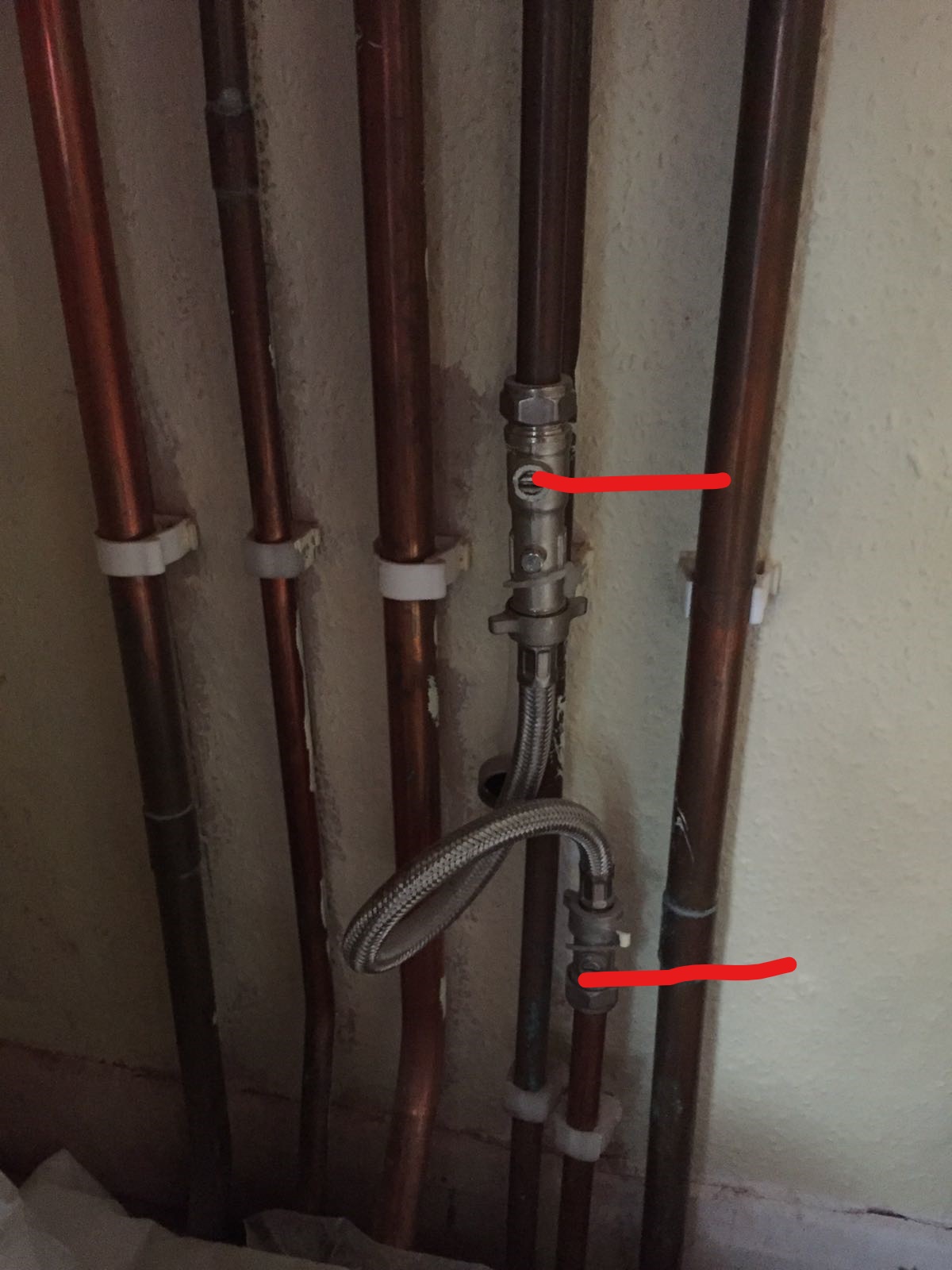

I have a Vitodens 100 WB1A boiler and just lately we've been getting an error where we don't get hot water after using it for washing up for example.
We have to press reset for it to work again, however it keeps occurring.
We've researched it and it came out as too low pressure and you need to increase it. I've turned some "knobs" but no success. I've attached images, can anyone help how to solve this?

on pic 3 you have a silver braided hose, this is called a filling loop, at each end of the hose there are valves , the slot that is across the valves have to be turned in line with the pipe and that will top the pressure up, open both valves till pressure is around 1.5 Bar when the boiler is cold, then close both valves and it will be fine , you just use a screwdriver to do it.
you need to put a screwdriver into the slots either side of the silver hose
here and here

looks like they turned the knobs on the front to off.
