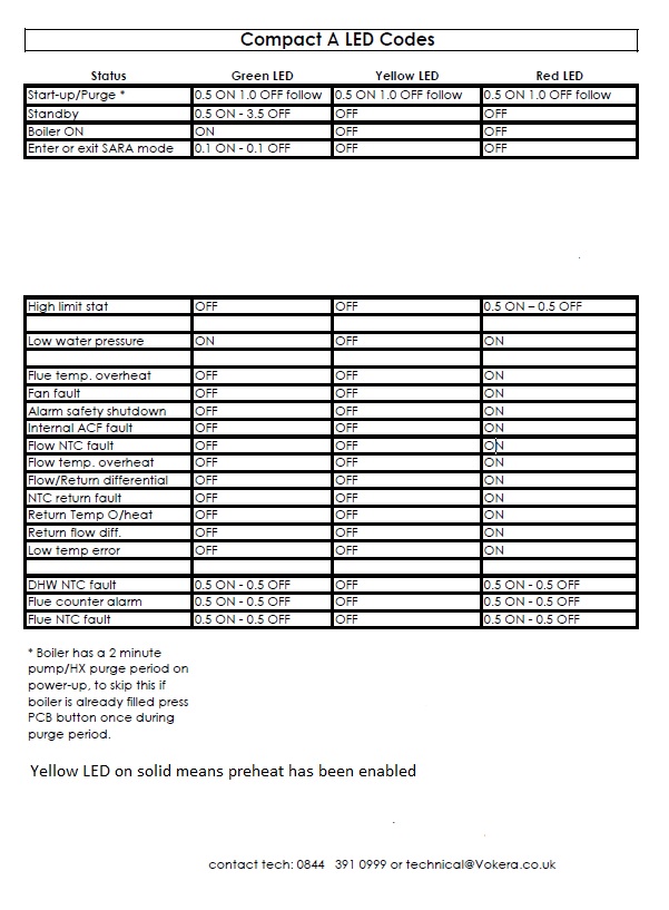

Hi My daughter has vokera 25a compact. red light is on. the hot water works but no heating, the thermostat dosn't seem to be working but not sure if its just that or something else telling the boiler not to switch on. Any help would be appreciated
This might help decipher the lights
