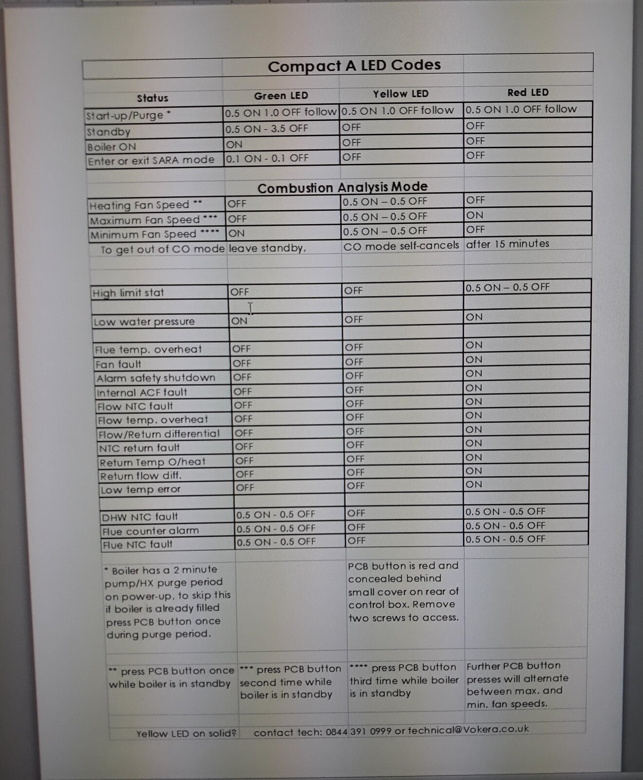

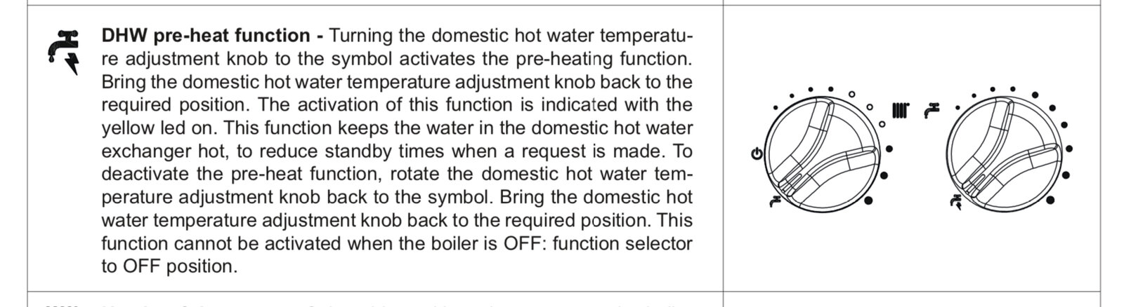

Not long moved into house with Vokera Easi Heat Plus C boiler and it's not firing up properly. The orange light is staying on and green light is flashing every 5 seconds.
I called Vokera and they told me to reset it, but that doesn't seem to be working. Did reset + turned on taps, but still getting same orange/gren lights + water or rads not getting hot.

Turn DHW to max then force past the stop and return it. If the boiler's is in preheat, that cancels it.
The boiler wasn't firing up properly, then you reset it and now it's not firing at all?
