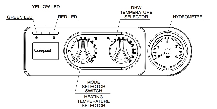

Hi everyone,
I've recently rented a flat that came with a Vokera Compact 25 (discontinued). I'm new to boilers and heating systems, so I studied the manual I found online on the website.
My property agent helped me set up the heating system and set both dials to 7. I also set up the timer system to that machine will only run when I'm at home.
However, I just got last month's bill and it hit a skyrocket of almost £300. I get that it's winter but I don't think my gas bill should be that high!
I checked my gas meter and found the numbers rolling quite fast.
When I checked the boiler settings, the green LED light was blinking every few seconds (Vokera's customer service says it's on standby). I changed the left dial to 5, which the manual said would have the boiler respond to the timer, and reduced the right dial down. My gas meter has slowed down a lot now and isn't moving.
I'm confused here. Isn't the clock timer supposed to control when the boiler is running? And doesn't the blinking green light means it's on standby and would only activate when I need it to?
I realise that the high bill might be my fault for not adjusting the boiler settings properly. But I need some help making sense of this. I called up Vokera's customer service and they're not much help.
I'd really appreciate input from any of you guys out there. Can't afford to shell out hundreds every month.

Do you have TRVs on the radiators? A room thermostat of some sort? What does the pressure gauge say? Is it steady near 1 bar?
Also with you saying it's coming on when it shouldn't be makes me think it could possibly be a faulty frost thermostat in the boiler.
OP is there a wall thermostat titled? Where is it and what is it set at?
If yes, is the radiator in that room fitted with a TRV?

Have you noticed the boiler firing when the CH and HW is off?
Change the times on your programmer so that they are OFF, whilst you are at home and monitor the boiler for firing and heating the rads. If this happens then you have a faulty timer/programmer and/or frost stat, in the boiler and maybe even faulty roomstat. Get you landlord to have it looked at!
As for nuiscance firing, during a heating period (I.e when the programmer/timer is in an 'on' period) the radiator in the room in which the roomstat is located, should have manual and not TRV valves fitted! This is simply because the TRV is likely to shut the rad off, allowing the room to cool, which makes the roomstat call for heat, whilst all the other rooms are up to temp!

is it a Vokera Compact 25A ? if so it has built in frost protection which could be faulty and false firing , but to be honest wouldnt have thought you would have such a high bill with your stated usage even if this was faulty
As a work around where your wall stat is you really want to turn the trvs to max so that room reaches temp quickly and turns the boiler off. Also trvs do not talk to the boiler they are very simple things. A trv will not turn the boiler on and off only the room stat will call for heat when the room temp drops.
