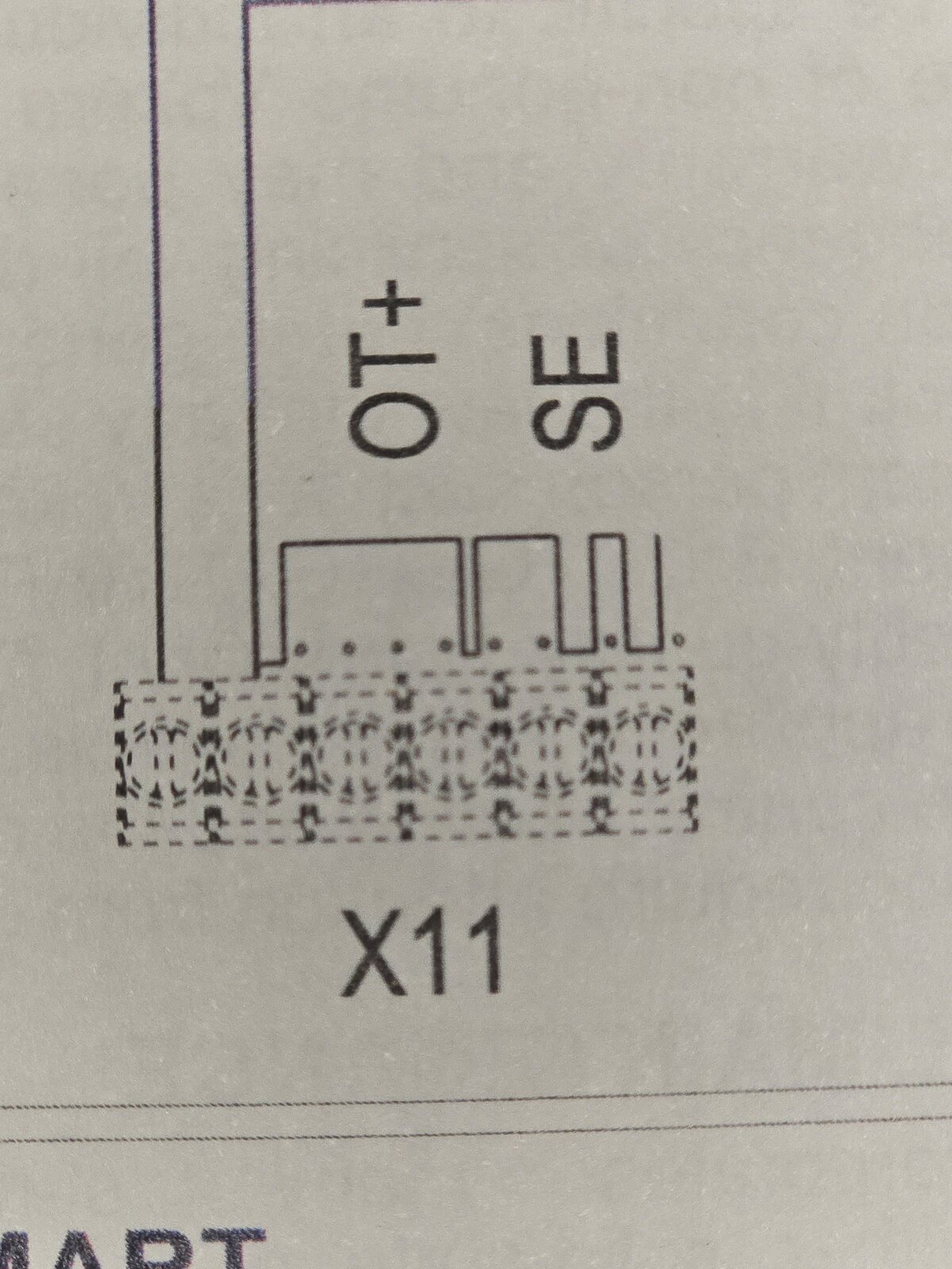

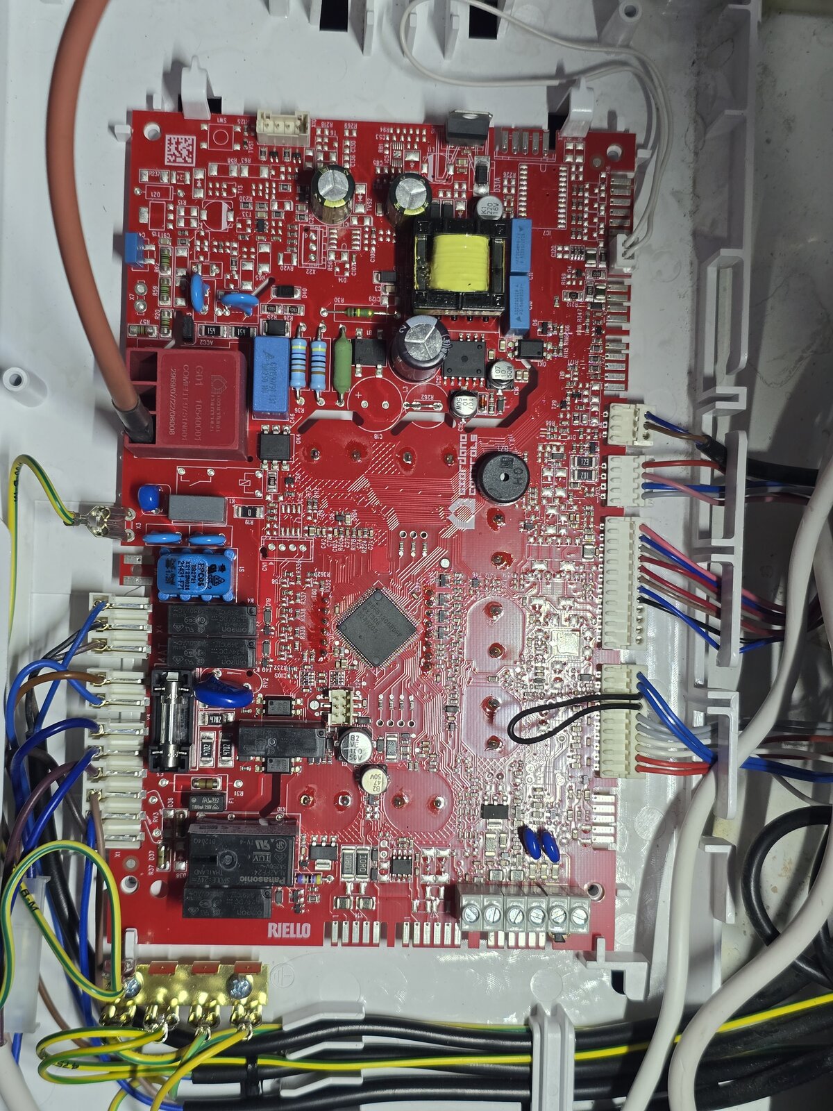

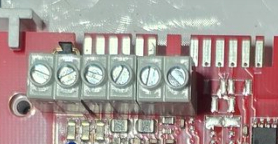

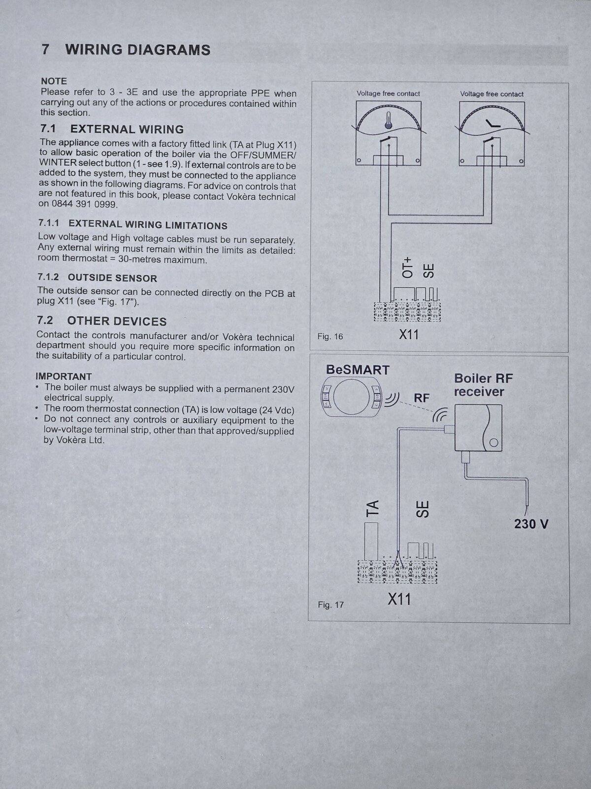

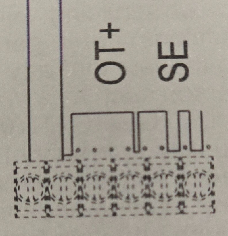

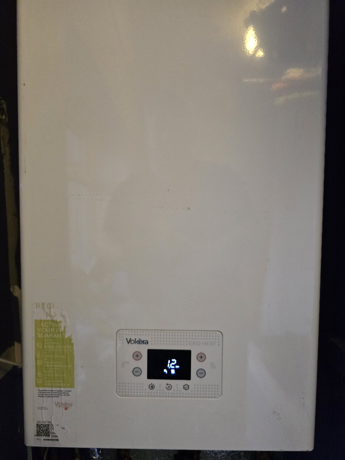

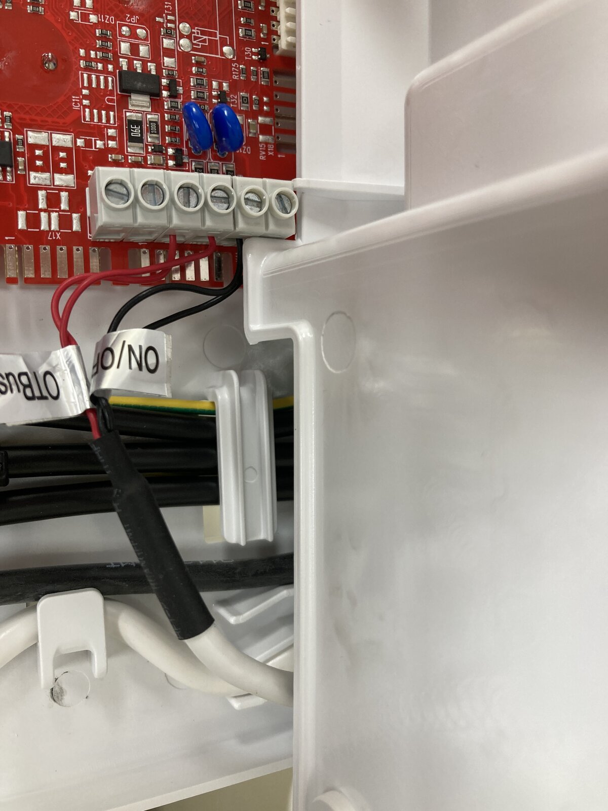

Hi all, I have a Vokera easiheat i25c boiler and I am currently trying to swap out my draytin timer for drayton wiser controls. The issue is have is that when wiring it as per manual I am not getting opentherm control. I am.womdering if there is any steps I am missing to get this to work. I have attached pics pic of my boiler its board and wiring diagrams to see if it helps. Thanks Andy

Previous was just a timer and it was fitted to terminals 1+2 where the bridge can currently be seen. Bridge has been refitted just to enable use of boiler while I sort the issue.
The bridge is vokera original just refitted.
Thanks, I'll try that tomorrow. Just to check I'm reading it right opentherm is terminals 2 & 4?
