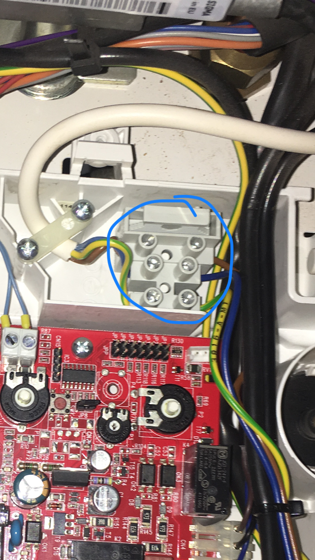

I have a Vokera vision 30 C boiler trying to wiring programmable wireless thermostat.
Not experienced at this, can someone tell me where I should wire in please? See picture

which wireless thermostat are you trying to wire in, VERY important this boiler is only suitable for voltage free switching thermostats, 240v switching can be achieved but requires an additional part
Hi. It’s a Vokera RF programmable thermostat. Receiver has four wires. Brown blue black black.
OK your Brown and blue connect to Live and Neutral and the two blacks get connected to the link on the left hand side of your pic, two blue wires with a black link, remove the link and put a black in to each terminal, do not make any links anywhere else
Ok I understand where black wires go on white link. Could you say exactly please where brown and blue connect?
Cheers
The thing is you'll have a timer on the Vision and another timer on the room thermostat. When you have the room thermostat connected as Ian describes (brown and blue to the terminal block top right of your picture blacks in place of link) set the programmer on the boiler to manual heating (24 hours) so the timer on the room stat will be the one the heating system operates on.
Out of interest, where is the boiler located and where are you located in the UK?

you add a live and neutral to those existing ones circled in your pic (with power isolated) and run them to your receiver, alternatively you can take the live and neutral from the fused spur if it is easier but everything must come from the same supply
Top right of your picture as I mentioned there's a terminal block, LNE, brown blue and green and yellow. live and neutral go in there.
It's a tight fit and fiddly so I snip off the ends of the existing live and neutral and strip back to expose the strands then twist together with the live and neutral from the thermostat.

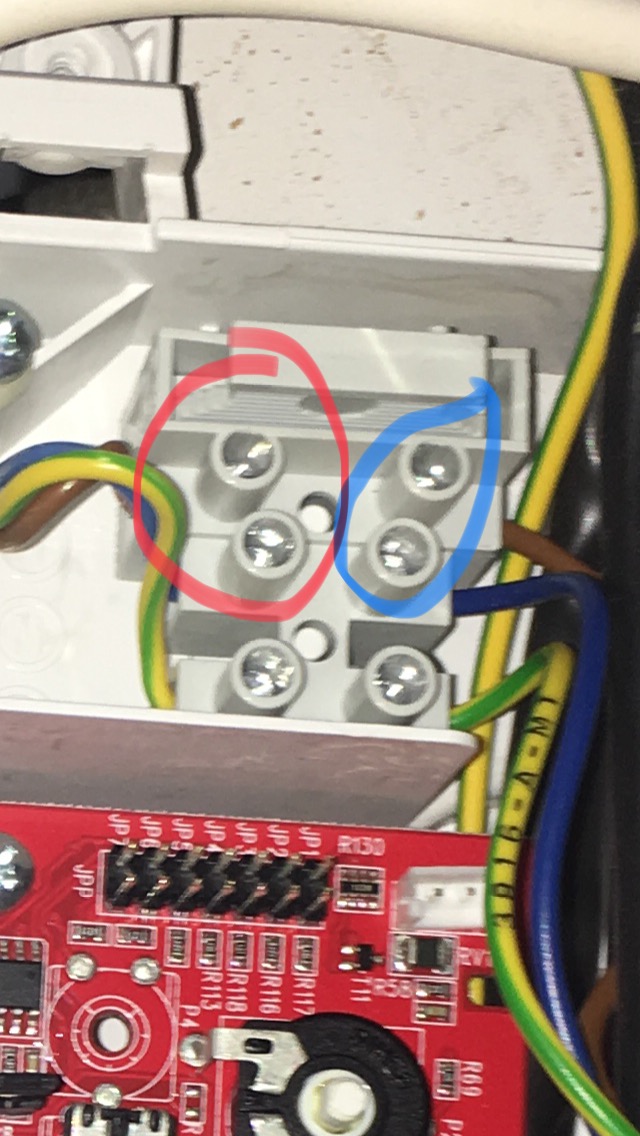

Apologies for this but I’ve never done electrics before ever.
Please see another picture. Do I wire brown and blue into the blue or red circle? And am I correct in saying I don’t remove those wires that are currently there I add the receiver wires to them so effectively each brown/blue connector will have two wires screwed in?

brown to brown and blue to blue, two wires in each connector then blue to neutral and brown to live on the receiver

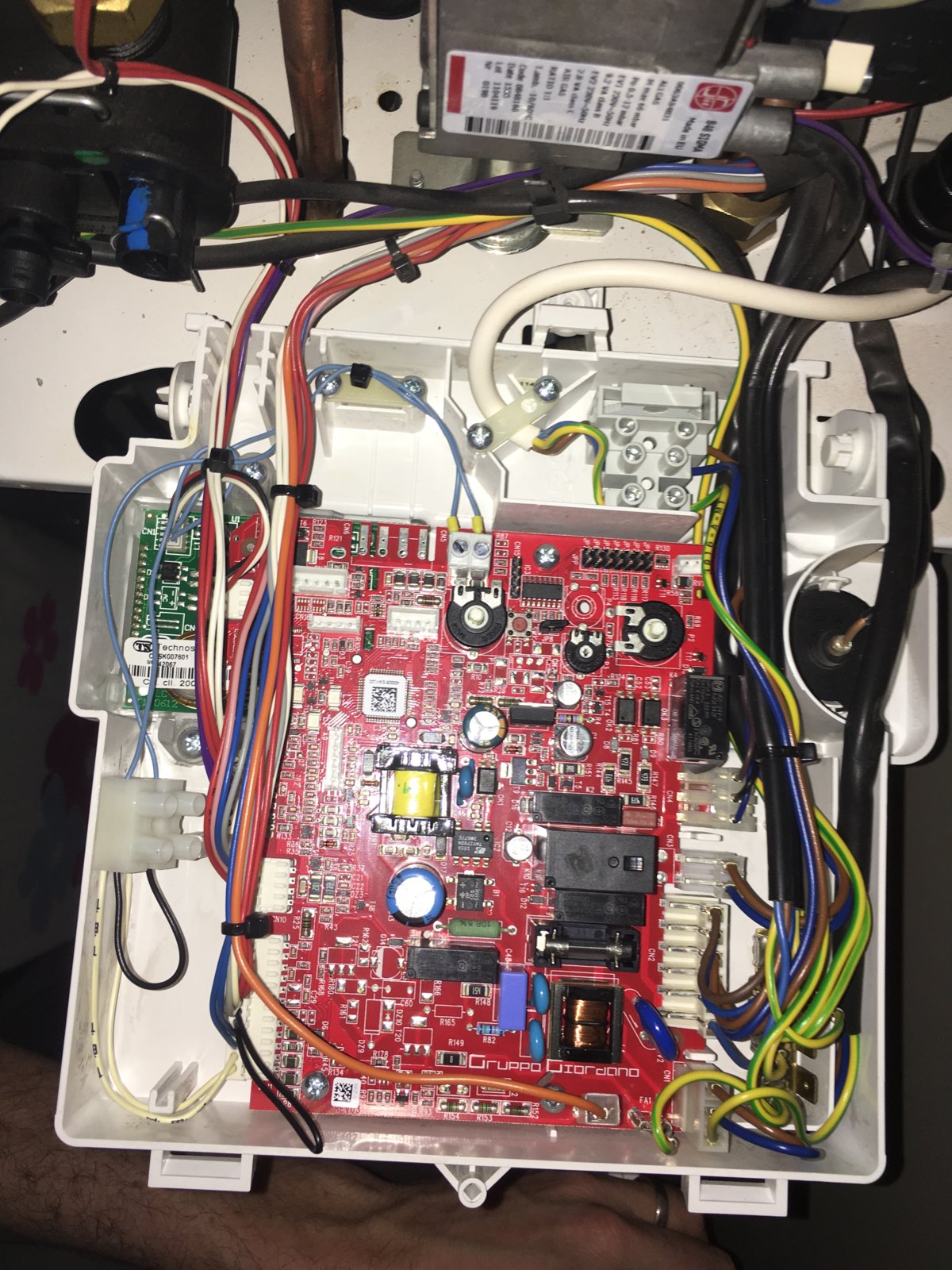

My question is do I double up the blue and brown wires on the left hand side or right hand side of this white connector box?
