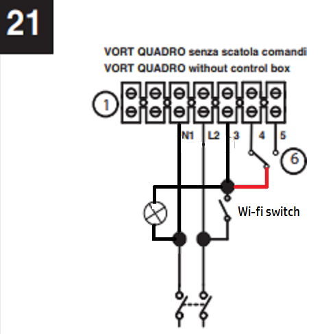

Hi guys.
Would you be able to help me? I am trying to replace my bathroom fan but I am not an electrician. First time in my life I see electrical connectors that are not labelled and that is my problem (or maybe I don't know what am doing).
My old fan connection is:
switched fused spur --> wifi switch (only accepts live and neutral, no earth connection) --> extractor fan. I had to short permanent live and switched live to be able to use my old fan. Now I decided to replace the fan with Vortice Quadro Super T and I want to have the same connection
switched fused spur --> wifi switch --> extractor fan with short between PL and SL. Please help.

Ok, I am replying to myself. This is the answer (official, taken from vortice support):
Neutral into N1
Permanent Live into L2
Switched Live into 3
And then a link between L2 and 4 to set the fan on the high speed.
The fan will operate constantly after switching on.

Anyway, from what you have said the smaller diagram from the manual which you posted is indeed wrong.

Everything worked as expected until I decided to set it up in normal speed mode. I "unlinked L2 and 4" but the fan has stopped working completely. I don't understand why but when I linked L2 with 5 it started working in normal speed mode. I guess "5" is open connection, without any "bridge" but I still don't understand why it has to be linked to two separate live connections for normal speed mode.
If I understand correctly:
Link L2 to 4 - runs high speed.
Link L2 to 5 - runs low speed.
No link does not work.
I would think that logical as 4 or 5 must be live for it to run.
Assuming there is a speed switch on the fan, then this would be a better way (the only way?) of wiring it.
