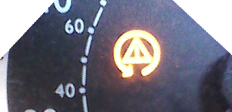

2004 Bora 1.9 TDI
I've had a look around and there was a suggestion it was the brake lights. Have checked them and LH, RH and bar lights are all lighting when pedal is pushed.
Brake fluid level seems good too.
Anyone know what the generic symptoms are for this warning light?
full

Had it on mine and it was a faulty wheel speed sensor.
Didn't need replacing because for some reason it was too close to the slotted part of the hub when it needed to be around 3/4mm away from it.
Repositioned and all good.
I diagnosed it with vcds lite by driving below 20mph and looking at wheel speed readings on the laptop.
The nearside front was going up and down, the others where reading correct steady speed.
Mind you, it might be something else in your case, but you need to scan the car.

Have been to a local garage who plugged his diagnostics in. It didn't find any recorded faults.
I found an article on a VW forum about resetting the esp by holding the esp button in for 5 seconds. I did this with the ign on and the warning flickered and then starting the engine, the light goes out. The warning light can then be turn on/off with the esp switch and when off, if the car is moved, the light comes on and stays on.
This suggests to me a faulty wheel sensor.
Possibly, but if the wheel sensor is faulty, even intermittantly it will have recorded a fault code.
I had a wheel bearing (front) changed on a Mondeo. Had esp problems after and it was down to a faulty insert of the new bearing.
If there is no codes and the bearings are demonstrably good then live testing of sensor outputs would be a logical step.
