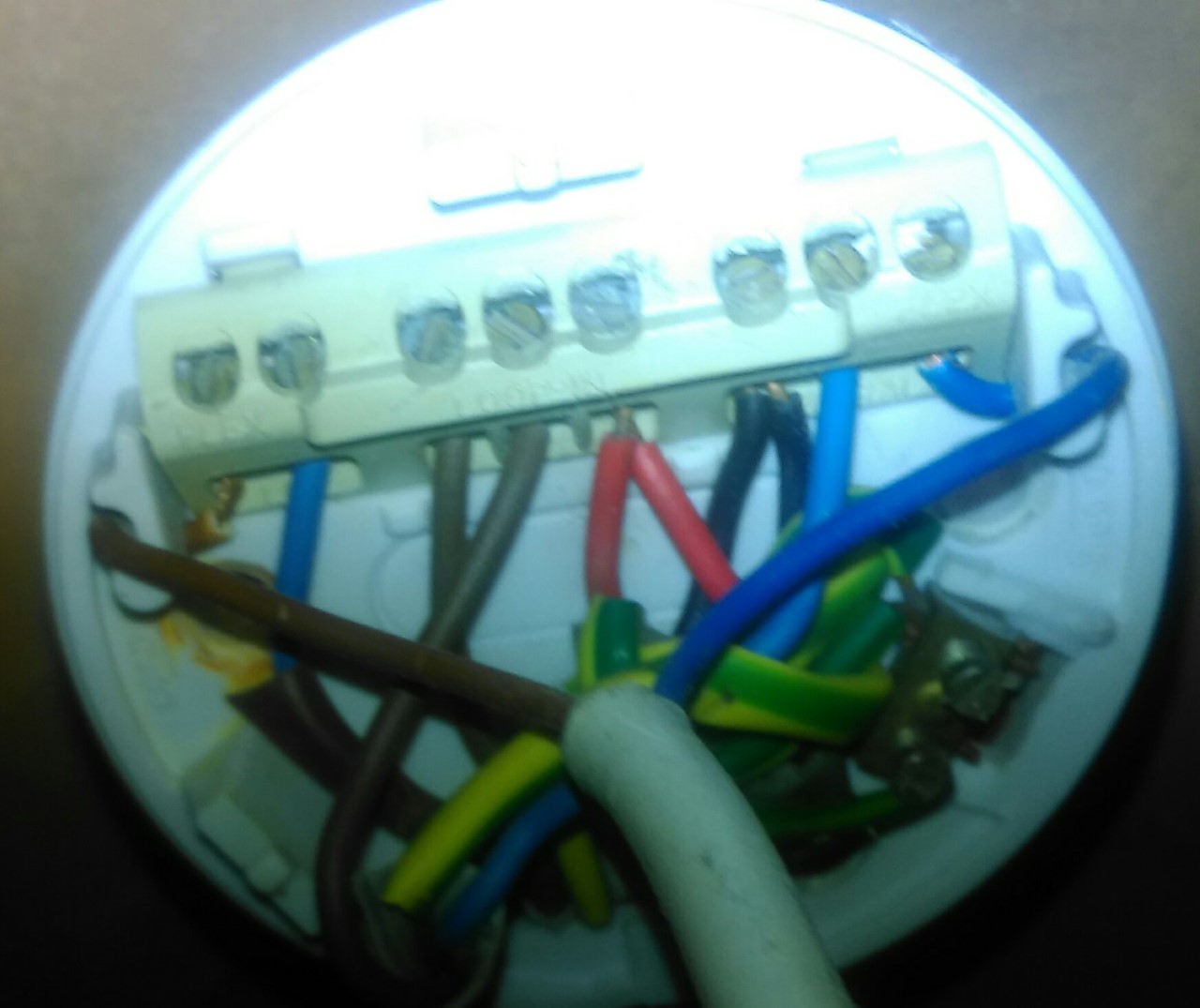

Hi gents ( and ladies if your here too)
decided to get wago connectors as the helgar box is way too tight for the 4 cables going to the rose and another out makes 5 ,so possibly 15 wires squeezed in:(
going off the photo of the present set up ,what wagos would i need to do it safely and correctly,any help would be welcome ! Gracias
I'm sure you can squeeze another cable in there. Easier than starting again.
What are you trying to do ?
Im Trying to change the rose so I can pop all wires safely up in to void leaving just one wire for a flush New fitted light.

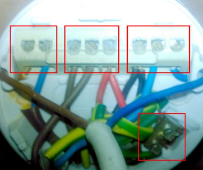

Yes it would be easier, just knowing what wires go in a 2,a 3,a,4 etc that's why I'm asking, Wago how many and what goes where,
I think I have it but want someone with a knowledge I couldn't posses to guide me!!!
The existing rose contains 4 separate connectors
if replacing with other connectors, you need the same quantity of them, and they need to have enough space for the number of wires in each.
That's brilliant that , thank you so much!
So a 2 connector and three 4 wagos looks right but you blocking them off like that is so helpful, to me it's spaghetti junction but that simplifies things for me and I'm sure others thanks again!!
Thanks for that, I have a basic understanding, changed a rose for a quick wire fitting last week ,switch wires, loop in,out and wires to light, just this has an extra set and the hagar box was too tight so was asking about wagos, and as I said the pictorial information given by flameport will benefit not only me but others.
