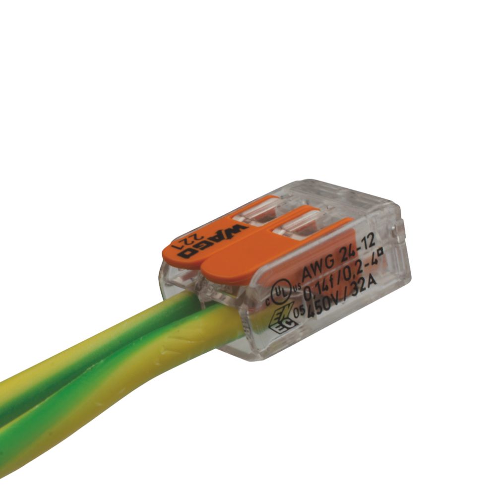

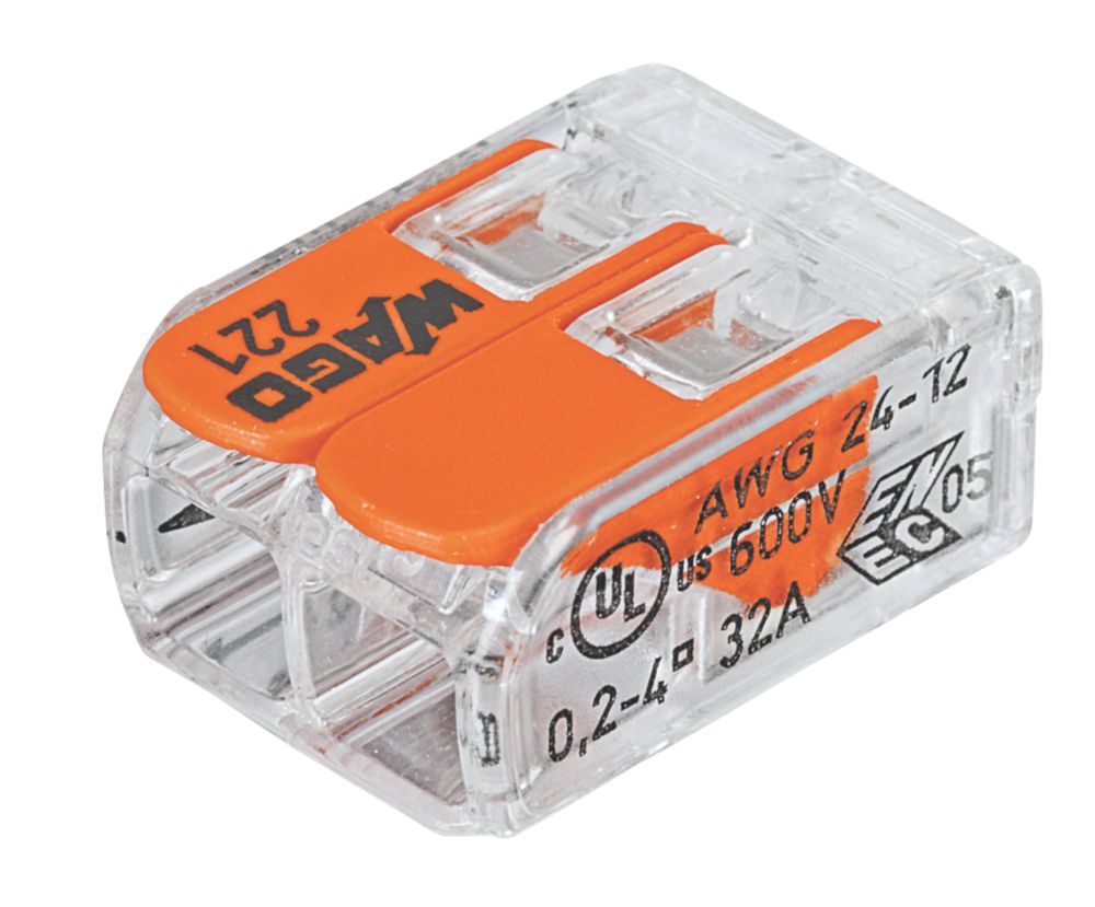

Are there any wago (or similar connectors) that I can use to terminate an earth wire when it is not required in some lights?
I either have to use a two terminal connector or terminal block which I cover with insulation tape.
As long as you prevent the CPC's copper core touching something it shouldn't, it doesn't matter what you use.
ae235
The 221 are the smallest

Also, I tend to use these type for my connections:
Are these okay to use? Is the main difference between these and the image you posted, the ability to re-use?
The difference is the lever type can be used for solid or stranded conductors, the push in style are for solid conductors only.
Both types are reusable.
Insulation tape is not required with any of them.
