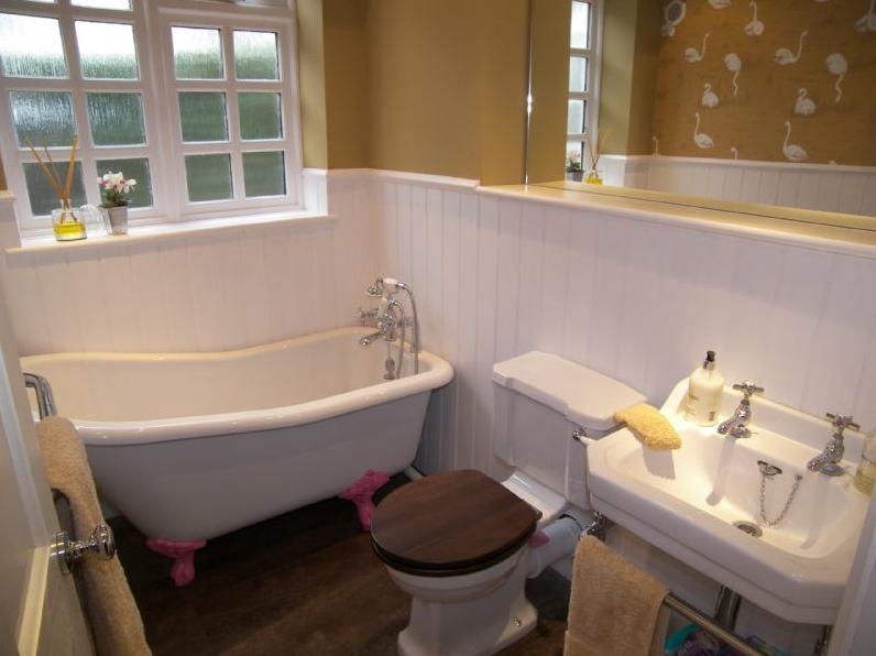

Robbie UK: That's exactly what I want!! Thanks for the photo.
So here's the bits I don't understand:
- Horizontal batons plus the T&G on the top will make all the cladding sit about 25mm from the wall, so how does a bit of dado rail cover the gap at the top?
- How do you do external corners? Did you have to do any?

When I did my WC I used battons because I wanted an air gap between the walls and T&G (external walls).
I gripfilled the battons to the walls. Then pinned the T&G to the battons- remembering to glue the tongues as I went along.
I then had a length of timber machined by my local timber merchant, the width being the batton depth plus the thickness of the T&G. I then pinned and glued that to the dado. See image
I had two external corners on a pillar. I trimmed equal amounts off the left and right boards, and then did the same with the returns. I then glued and biscuit joined them (I can post a picture tomorrow if it helps).
Edit- BTW I would always rather go to a timber merchants and select each length of T&G. You may end up with more wastage and need to do more cuts but it will be cheaper than a diy shed.
On mine i glued the T&G straight to the wall as the walls are flat and quite new. I used Gripfil. The timber sat on top of the skirting and then i faced the bottom up with new 5" Tourus skirting. There would be no need if the original skirting had of ben taken off. The top was done with a piece of 2"x1" on its side and a small fancy bead underneath, all glued on with Gripfil. I didnt have any external corners but you can cap them with a 90 degree bead.
