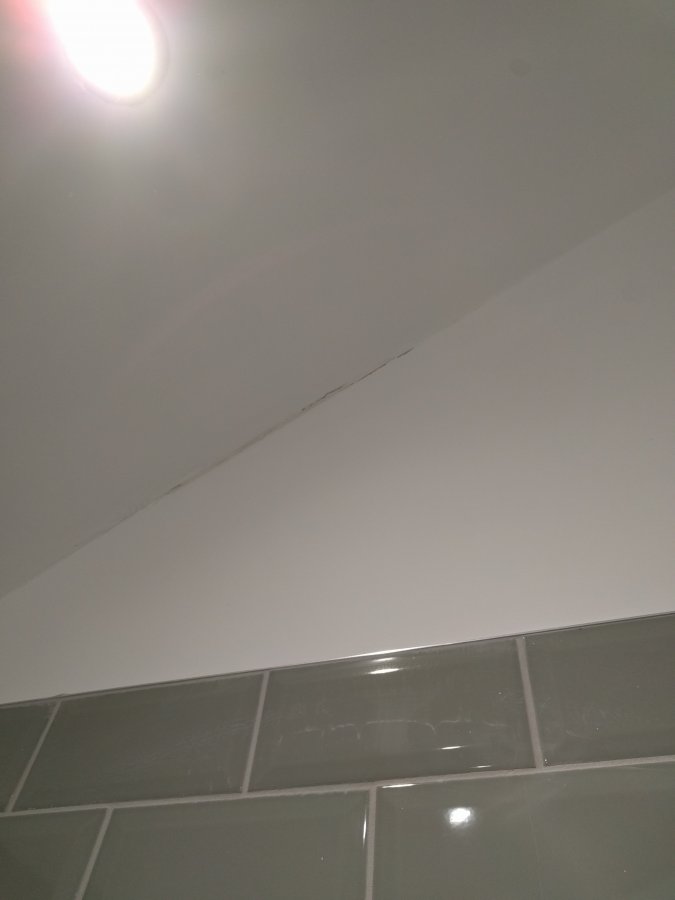

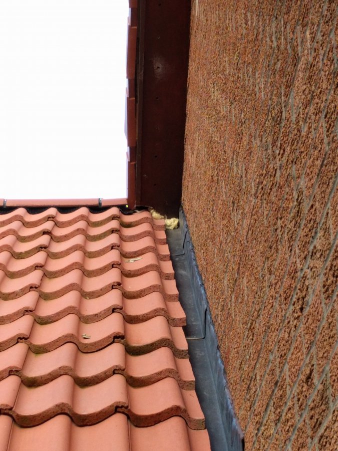

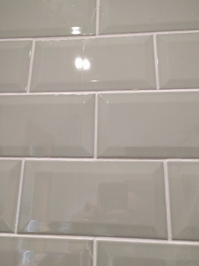

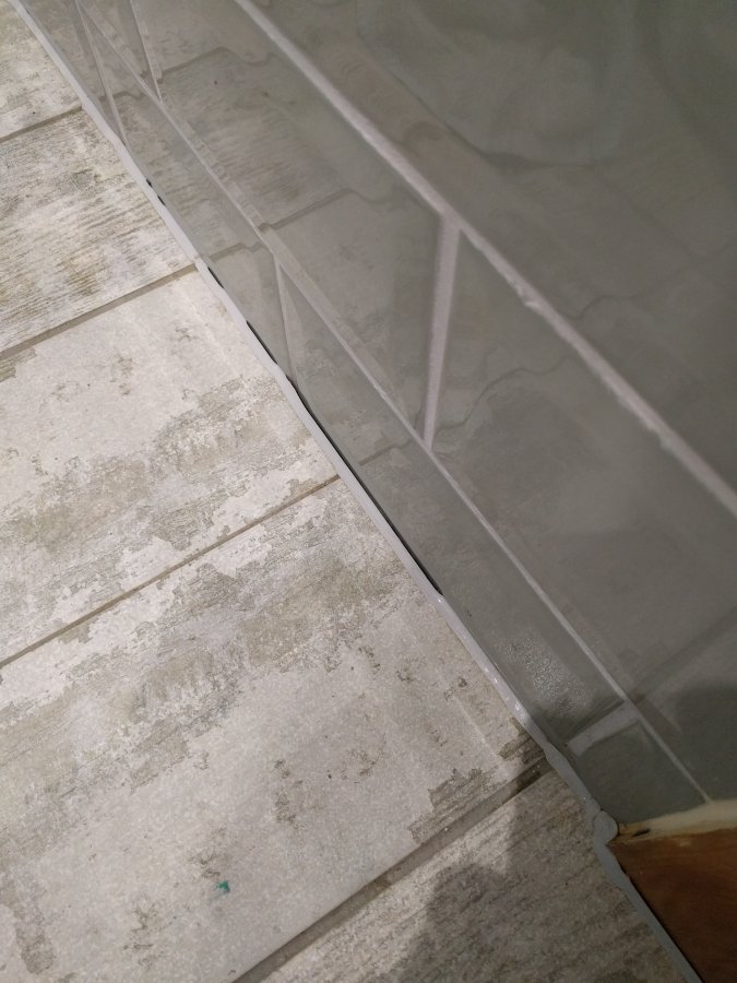

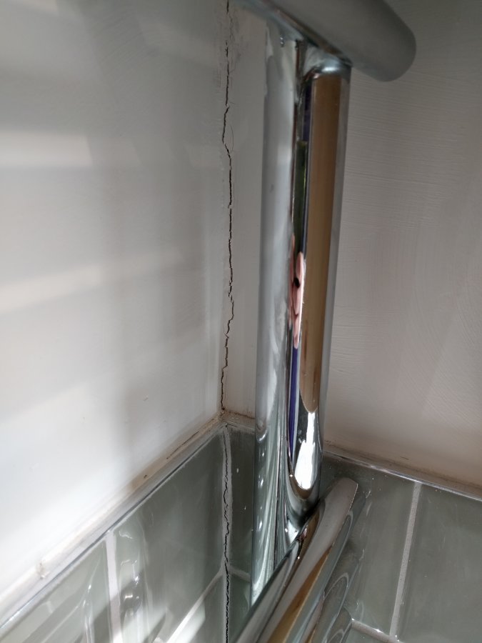

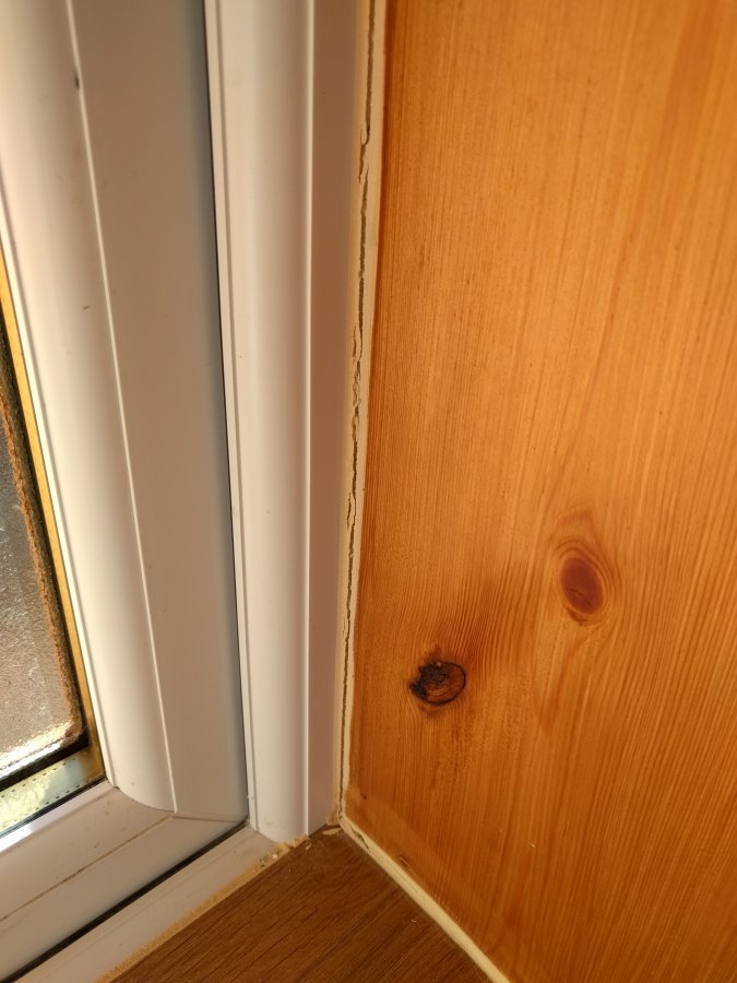

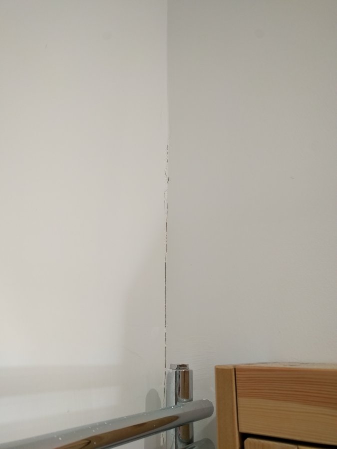

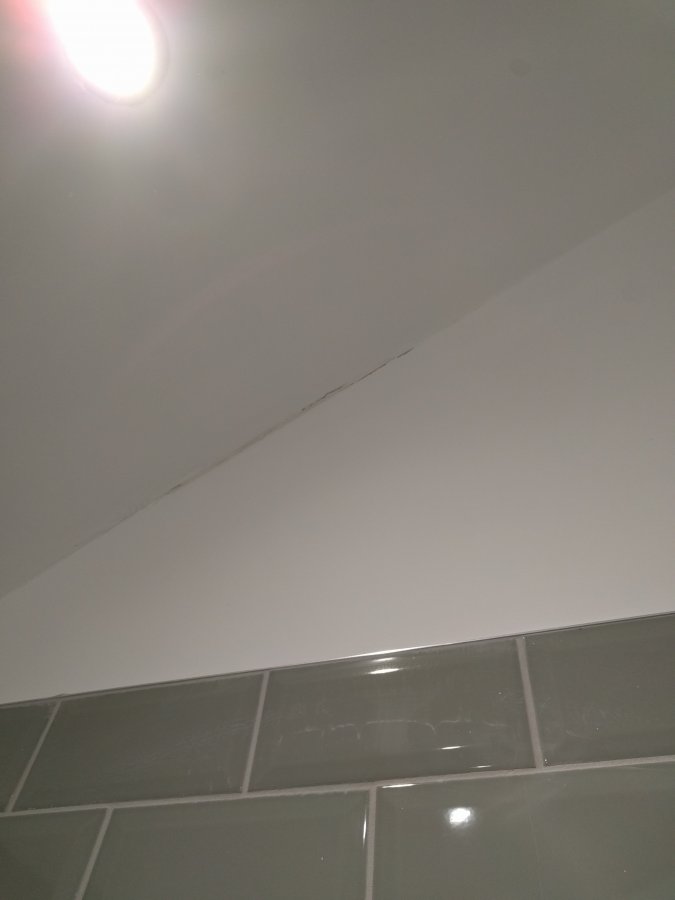

Over the last couple of months the expected cracks in the plaster joints have appeared however I also spotted that there is a joint between the old and new roof which was filled with expanding foam and is sitting open to the elements. The silicone around the wall tile to floor tile joint is coming away in the shower area and there is a mystery crack in the shower wall tiles about 12 tiles deep (hairline but still concerning in a wet area) and the extractor fitted is not up to the job nor the spec I asked for during the build.

Given your condition you may want to post pictures here for impartial feedback on the defects.
Here you go. 14882825341281823707899.jpg 14882825597011058935777.jpg 1488282582755403040250.jpg 14882826099261897218708.jpg 14882826383431075887078.jpg 1488282674740828976775.jpg
Lot of photos. The cracks in the tiles might be quite hard to see. The foam you can see in the roof joint flows right through into the woodwork of the old roof in the loft.
The silicone is in the wet/shower area so any water will be going down the back.

But you need to be sure that the items are just minor snagging, and will cost less than the amount retained. Otherwise do you want to claim for more money to cover the actual costs?

BTW, cracking in ceramic tiles is always a worry as it tends to be caused by movement of the wall behind. Any other work involving water and things getting worse if not rectified quickly, will tend to attract a cost premium to get done quickly.
With the exception of the foam and the cracked tiles, this is just shrinkage and should be remedied with the appropriate decorators filler/ sealant/paint etc. Is a real shame about the tiles as really they need to be removed and replaced. It wont be easy to do that and you might not get a good looking finish. The foam filler probably needs a roofer to flash over or something. You probably could get this all done for the £500, so worth getting someone to quote and then telling the builder you're going ahead with the fix, once you've had a quote.
Edit: woody beat me to it, his reply is better.. apart from sending letters recorded delivery.
Cheers guys. Yes, the cracks are just shrinkage which I was expecting. I don't understand the tile crack at all - there is no cracking of the plaster directly above the crack line - the tiles aren't full wall height so easy to see. It's almost as if there's been some sort of impact that has caused it. For all I know one of the trades fell against it and didnt mention it!
