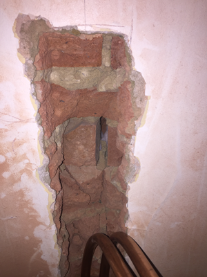

Hi,
I was chasing out a wall at the weekend to put in a hot and cold supply to a sink. The pipes have insulation so i needed it to be quite deep. I haven't really done much chasing before but i used an SDS and chisel. Unfortunately I have gone far too deep and even punched through the inner wall. I'm a bit worried that I've made quite a big mistake. Is this really bad? How can i fix it?
One of the bricks is really loose. I need to firm it up so I can get a fix for some clips for the pipes.
Its no big deal Andrew, block it back out in layers 4-1 sand and cement.
Phew. Thanks very much. Sorry to be such a newbie, but what do you mean by "block it back out in layers"?
