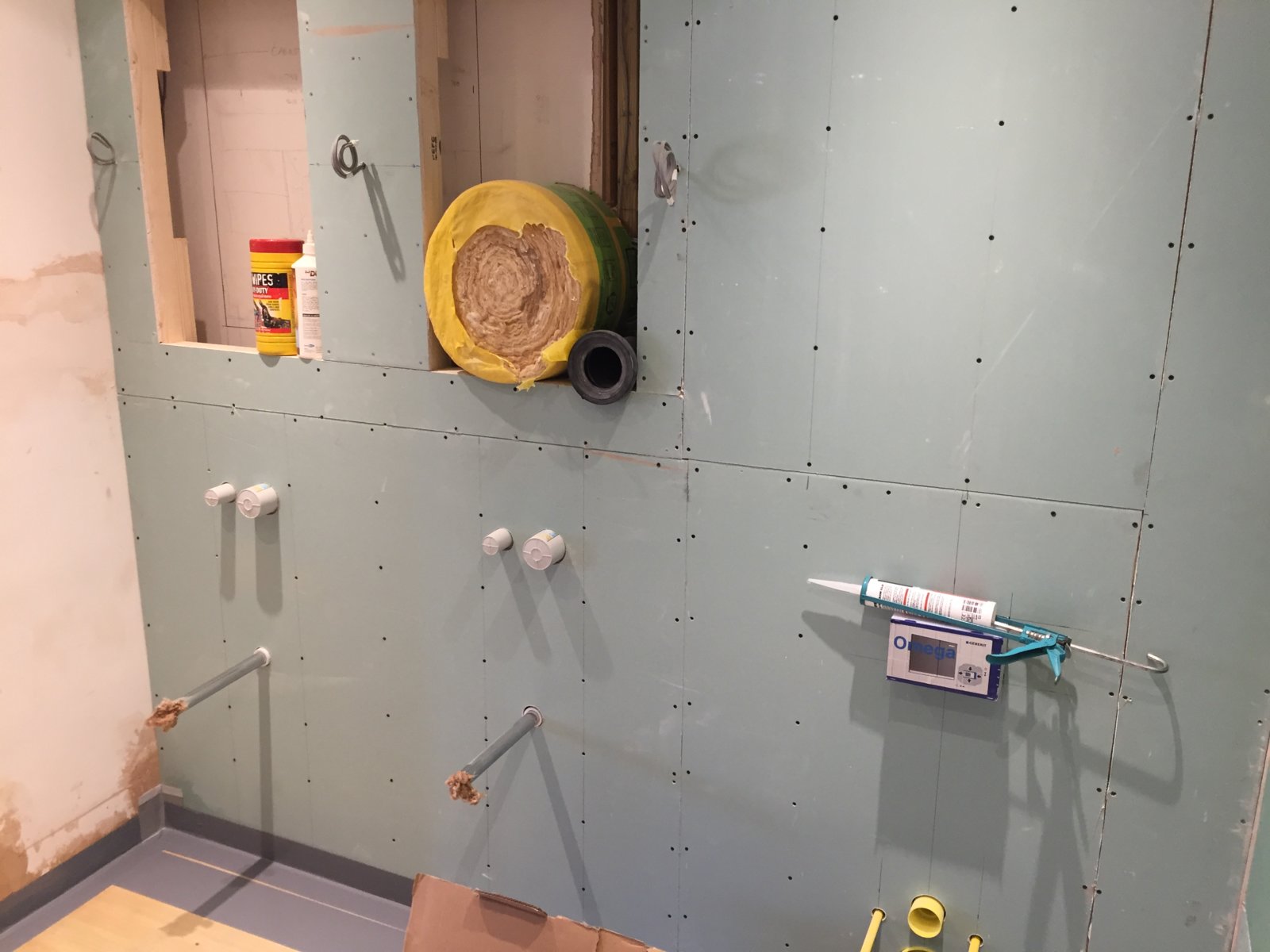

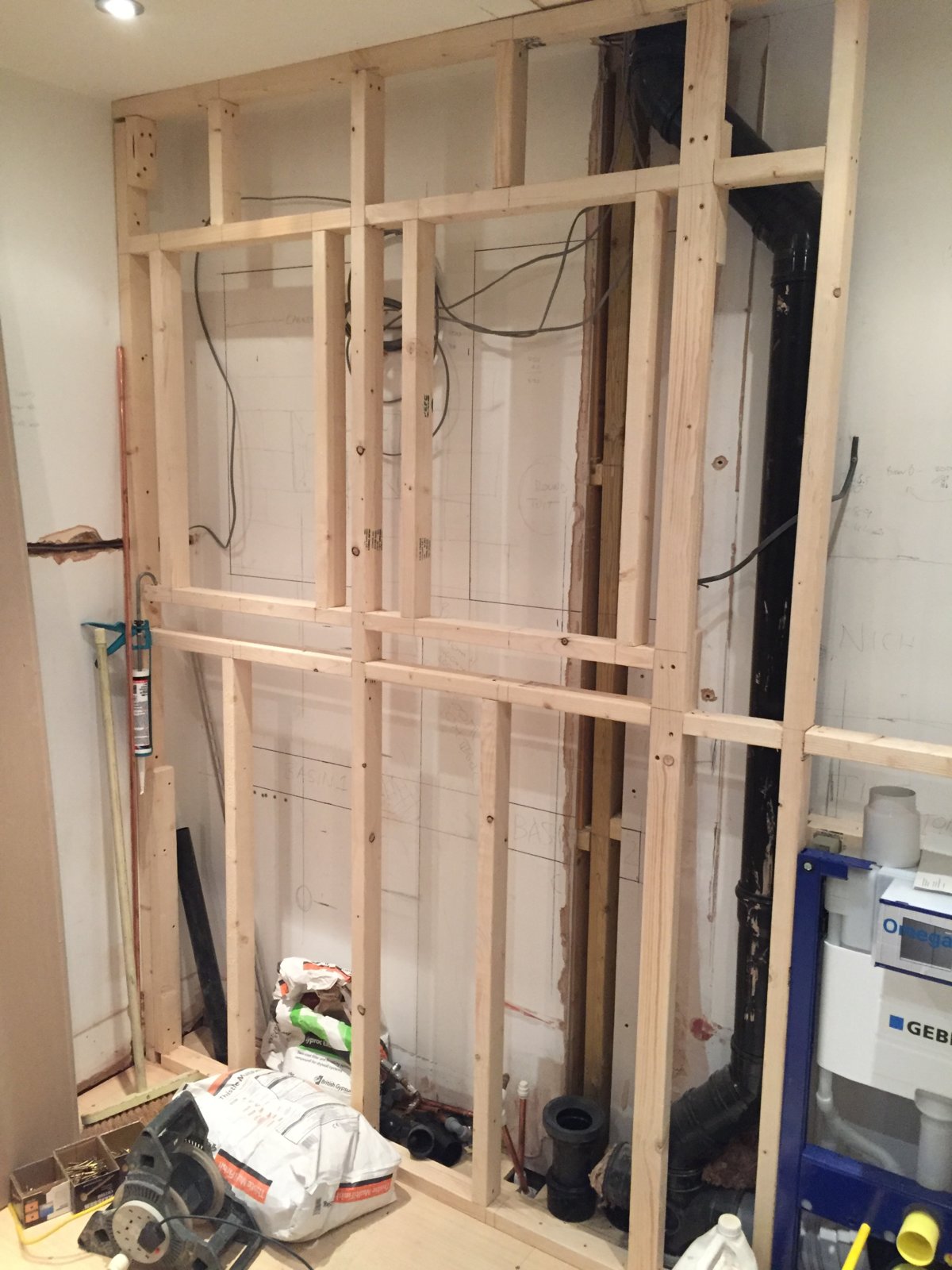

If on a plasterboard wall... you’ll need a timber ground across 2 studs a a back plate to support the frame bolts and the floor bolts will also need something to chew into... one tip is to screw a couple of blocks of wood to the floor, behind the frame’s feet - all the way back to the wall, as a brace.
Here’s one I’m currently doing...
