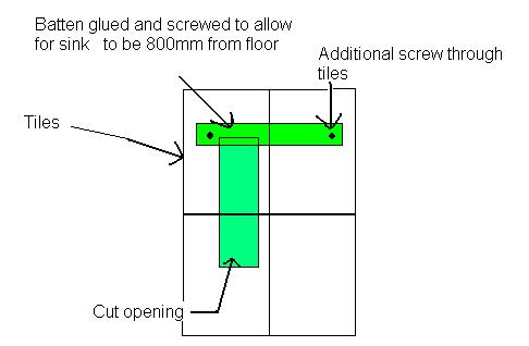

Have you tried an electronic stud detector to locate the studwork behind? If you're lucky, you should be able to affix a supporting batten to this and hang the unit from that.
Alternatively, you could cut an appropriate opening with an angle grinder, but this will be very dusty unless you protect all the surrounding area with taped on plastic and have someone spray water on the tiles as you cut them. Extra care and a gentle touch will be needed if there are pipes back there, but it is possible if you aim at not cutting too deep.
The opening will need to be big enough to manouvre some supporting battens behind the fixing points, and can be glued from behind and screwed through from the tiled front.
Get some replacement tiles, remove a few - find studs - fix battens - re tile as required.
Or return the expensive unit because you bought it when you were unable to fit it.
Angle grinder with tile blade, cut out unit profile on wall removing tile and plasterboard, replace with ply to same depth and install unit to ply background, very secure surface.You are sure to reveal at least one stud which is all that is required for a scure fitting of ply.No further tiles required.
