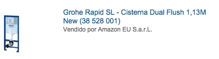

We are currently renovating a bathroom (in Spain) and having ripped out the old bathroom we are installing a new wall hung toilet (Grohe Rapid SL). We want to increase the depth of the area behind the concealed toilet cistern to incorporate some storage alcoves (approximately 250mm depth). The width of the frame is 500mm and we have 650mm. The toilet is being installed in a corner (to the right) and the soil pipe from upstairs is in this corner so my partner is bringing the toilet forward from the wall approximately 200mm and he wants to use long fixings to bridge the gap between the cistern and the wall. Then, he suggested building a brick wall in front of the cistern and putting tile adhesive directly on the bricks to tile over.
My question is: would it be better to build a small brick wall in front of the existing waste pipe and back wall but behind the concealed cistern frame (fixing the cistern frame directly to the new wall, then fix battens to the side of the cistern frame and use board and batten to create the alcoves above. I guess it is as broad as long - it just seems odd bricking up the front of the cistern as an attachment for tiles.....They usually brick everything in Spain I know... and don't use batten and plaster board so much...
Opinions appreciated. .. Thanks in advance...
