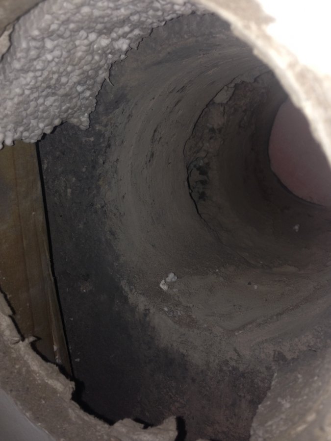

Moved into a house that was built in 2000 in Scotland.
It had cavity wall insulation done by previous owner in 2012. Slightly paranoid about this so took out an external vent a saw that the external wall is made up of the following.
1)Render on outside,
2)100mm concrete block,
3)50mm cavity that is now filled will mineral wool
4)100mm concrete block
5)60mm cavity of which 50mm is filled with polystyrene insulation board.
I got the paper work out for the cavity wall insulation as its says cavity of 85mm to be filled noted during the survey! How did they come to this?
Also after reading all the horror stories will the CWI give me issues, house is in a very good condition
