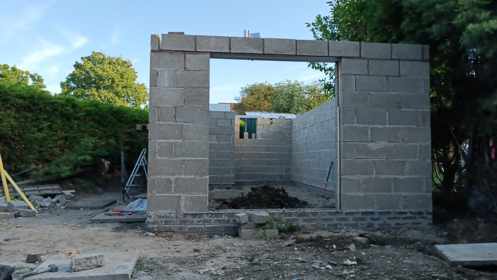

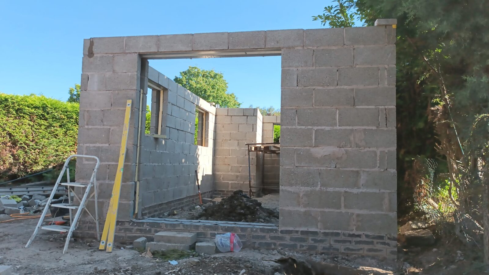

Hi all,
I am currently in the process of doing my roof.
It's a cavity wall. My question is do I put the wall plate on the internal block work only, if so what do I do with the gap on the external block work?
I was planning on putting wall plates on both inner and outer block work.
Inner block work is slightly higher then external block work.
I've also been advised to put some DPC in between the blockwork and Timber, but have also read that this weakens the join between the timber and block work. Plan on strapping down the wall plates with wall straps. Is there any sort of distance I should leave between the wall straps?

I'm going to say inner leaf only, but I haven't the foggiest idea what you are building and neither does my mate below, Old Mystic Mike.

I'm building a outhouse. I'll attach some pics.
So what goes in the gap on the exterior wall?

Flat roof or pitched?
If flat, you don't necessarily need a wall plate. But typically on the inside course with an added course of bricks externally, depending how you intend finishing the soffit/eaves detail - hence the question flat roof or pitched. You may wish to brick the joists in (both leaves) and continue the cavity insulation to the underside of the warm deck (?), in which case, you would not include a wall plate at all. I'm relying on Mystic Mike more and more.
Those blue bricks below DPC could do with another coat of render. (y)
How are you going to tie/lap the DPM onto the DPC course?

The plan is to make a cold flat roof, with the 120mm insulation at the bottom.
I was planning on putting 4x2 wall plates all around the top of both leaves and then securing the 7x2 to the 4x2 timbers.
Soffit boards will go all the way round with 200mm vented boards on the left which will be the highest point and 100mm vented boards on the right lowest point.
I haven't planned for the DPM on to the DPC. Not sure what that means? I think I'm missing something.
Blue bricks at the bottom, was planning on leaving them exposed and k rendering all of the block work around. Again I'm probably missing something with the render suggestion.
