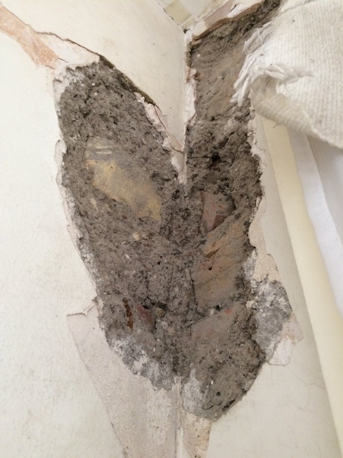

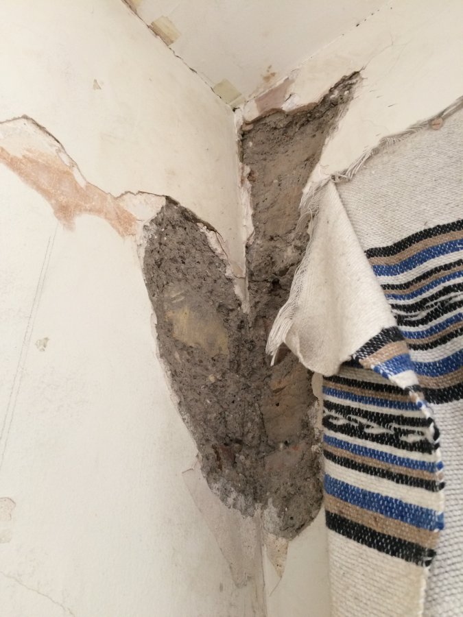

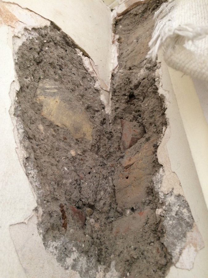

Hi,
I am new to plastering but have done a few bits of DIY in the past successfully!
Had a problem with damp that was fixed by a major roofing and repointing job around 6 months ago. It's definitely dry now, but when checking the blown plaster whole chunks of it fell away and left old crumbly/dusty exposed mortar. This pretty much distentgrated on contact to expose the bricks.
My question is how to fix this? It's a small area and the surrounding bits seem pretty solid (see photos). What kind of render or concrete should I use to fill the hole before plastering?
And what do I need to know about doing all the steps correctly so no cracks will occur?

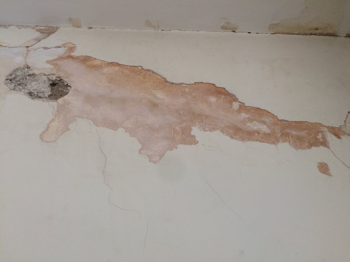

The pics show upper corner of wall adjacent to ceiling. As well as the hole there is a bit of paper and paint that flaked away. Can this be skimmed also?

I'm no expert but I'd say hack off everything that's will come off easily, unibond the wall and replaster. First use bonding if browning (if that's what they still use these days) and then skim it with finishing plaster. No doubt I'll be told different!
As above, remove all loose flaky plaster. if the areas are only small, then probably best using a one coat/universal plaster. This can be applied as one coat or two if the areas are deep.
Thanks for the replies. I was wondering if some kind of mortar would need to be used before plastering to fill the deepest parts of the hole (around 2-3cm)
Maybe just 2-3 coats of plaster?
Unibond is 1 part to 5 parts water according to the sticky on this site
If you have areas that are 3cm deep, then it would be advised to use a basecoat plaster (bonding plaster) or you could apply a basecoat using the one-coat type of plaster. it would depend on the amount work/area sq/m that would need to be done, to do basecoat and skim, you would need to purchased two plaster products, if using one-coat you only need the one product.
With regard to application of PVA, you are best advised to read and follow the MI's of the particular brand you purchase.
The inside corner where the wall joins the ceiling doesn't seem to have been taped - and now there's been some slight movement thats opened the join up a little?
You could choose to do nothing further with the large gaps at the wall meets wall inside corner
, & simply pull it out with sand and cement and then skim it.
However, the corner seems to have been repaired with a jumble of brick bats, and the old skim has not taken to the surrounding wall(s?).
You seem to have skim finish over skim finish over a plaster background - the prep for the last, final skim was not prepped properly.
External wall corners should bond & tie-in wall to wall.

Many thanks. The height of the hole is about 50cm.
@vinn I havent done any work on this, just loosened what was already there. These are external walls yes.
No matter who attempted a repair - the result is rubbish. This is prior to any connection with roof leaks or duff pointing.
Best practice is to take it all out from the "repaired" area, and set properly bonded-in bricks correctly laid in place.
