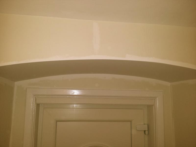

I am currently in the process of wallpapering my landing, passageway and stairway. Whilst I'm not brilliant I'm competent(ish) but I'm about to wallpaper the wall above the top of my stairs on the landing.
Now normally when you wallpaper you’re either wallpapering to the skirting or the ceiling (ie an edge of some description) that you cut into. But above the stairs the wall just stops and slopes downwards, becoming the ceiling to the stairs (if you see what I mean).
I’m worried that cutting across is going to look rubbish (especially when viewed looking up at it); especially since the paper is slightly thick and the line isn’t perfectly straight. Is there a tip to making it look good? Should I cut when the paper is still wet or would I get better results trimming when dry? Would carefully tearing the paper be better, rather than cutting, as the edge would then be more feathery? Although my heart freezes thinking about risking tearing paper freehand!
I’ll have the same problem in the passageway, as there’s a small section of wall above the front door with a lower ceiling than the rest of the passageway which will also need papered down to. And for added difficulty that is arched :confused:

This is the arch I was talking about. The one wall on my landing is the same depth, but not as wide ... and flat, not curved, but the same principle - wallpapering to a flat edge rather than a ceiling or skirting.
I'm guessing if I don't get my cutting spot on it's going to look awful, and also since it's not curving round from below you would look up and see where the paper ends. Could I use a thin line of filler to run across to neaten it if I go a bit off, and to also minimize the 'cut wallpaper' look?
I'm not a pro decorator but that's what I would do. A really light bead of decorators caulk along the edge of the paper and paint the arch ceiling up to that line. As you say, it would just feather the cut edge nicely I think.

I would paper down to the edge leaving an overlap of about an inch make sure the edge is well pressed down perhaps with a seam roller, (if textured paper use a soft one) wait till the next day at least till it is fully dry.
Then trim off to the edge following the curve with a VERY sharp knife flat side of the knife against the underside, the snap off type are good don't be stingy change the blade for each cut. Then if any rough edges a very fine paper along the edge pushing the abrasive up against the underside. Then treat the underneath as ceiling and paint it white.

Do you leave the paper to dry so you're least likely to get snagging when cutting the paper? I'll give it a go but the thought of waiting until the paper is dry before cutting (when it's too late to pull it off and try again if you mess up) is a bit scary.

Yes wait till dry so it's nice and stiff to stop tearing as you cut ;)
