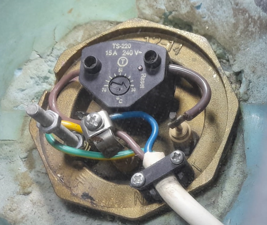

The immersion heater is pictured here, it seems it only heats the top of the tank, and if there is no sun on a day, I run out of hot water, but with the central heating I get enough hot water to last around 4 days, powered from an iboost+ can I heat more hot water?
And will that mean just thermostat change, or whole immersion heater change?
The thermostat is set to about 30 degrees in your photo. Why not raise it to 50 degrees. Then you could mix with cold in your shower or bath - it would "go further" that way.

It is an old photo, I have adjusted the temperature to be as hot as it can without tripping the reset. But the amount of hot water means a couple of dull days, and we run out of DHW.
There's a few inherent problems with top mounted immersions/thermostats.
One is element length, if the cylinder has indirect heating (cylinder coil) then the element can't bee too long as it may foul the coil, another problem is the stat length, the stat length is often much shorter than the element length resulting in element not switching back in until a fair amount of hot water is drawn off. Even if the stat is the full length of the element then from say a fully heated cylinder to 65C then the stat will not switch in until probably ~ 25% of the HW has been drawn off as the stat is measuring the average water temperature, so a 200L cylinder with the element heating 180L may mean that it doesn't start reheating until another 40/45L is drawn off. You could install a destratification pump or a willis type external element but this brings its own challanges.
I would disconnect and pull out the stat (with power isolated) and measure it, for a start.

I understand the issue with element lengths and that is a problem but I find with the standard top mounted immersion there is a limit to how much water you can heat without dangerously overheating the top of the tank so without major plumbing alterations there is little we can do. I don't fancy the idea of a de-stratification pump although it would not have to run continuously, if I had a choice I would choose a tank with a low mounted horizontal heating element.
As far as I can work out the TS-220 thermostat is 7" long, that is well short of where the top of the hot coil is, yes the Willis system would be ideal, but not sure I could find a plumber in Wales who could install it, in Ulster it would be easy, but people who say they are tick, are normally the reverse.

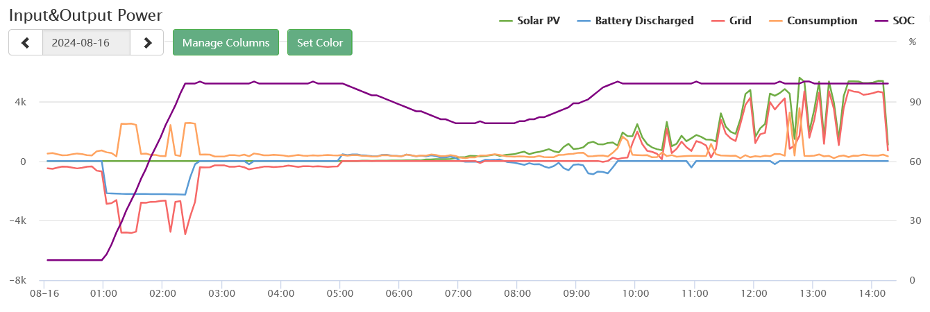

Solar is around 5 kW maximum, today 11 am exporting 1.3 kW in summer most days the battery fully charges, and we do export, which as it stands we don't get paid for it, so as it stands want to use the iboost+, I will admit once I get payment sorted out, the iboost+ is not the best option, using a simple timer and heating with off peak would be better, as in the main payment for solar is higher than the cost of off peak power.

I called a plumber to change the thermostat or immersion heater, and he asked for a picture of the immersion heater, so I assume the picture shown when I started the post would tell plumbers if a longer thermostat could be fitted.
The thermostat is in a (dry) pocket, all thats required is to isolate the power remove the wires from the stat, pull it up and out, measure it, then get a bit of stiff wire and push it down into the pocket until it bottoms out, measure this. What size cylinder have you got?, a 7 ins stat is normally only used in a top mounted dual element immersion with a sink/bath switch, and it switches the neutral.

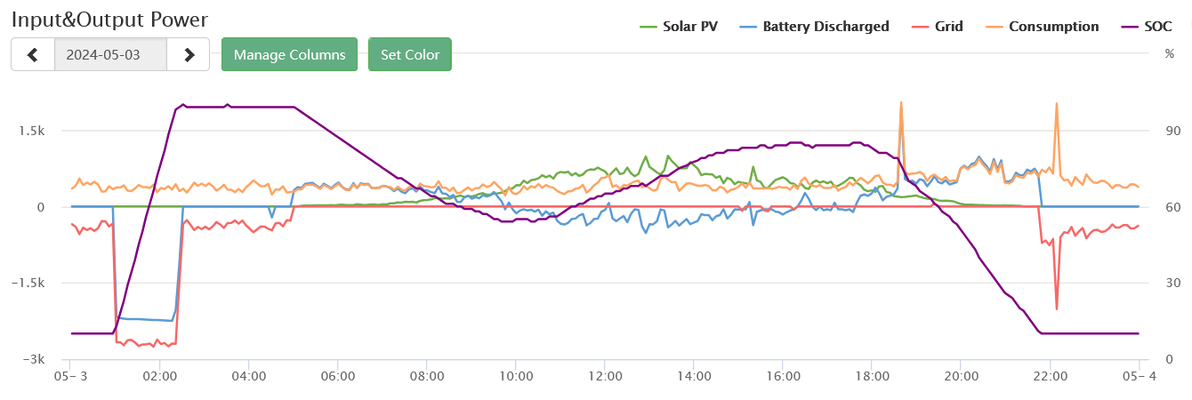

The batteries are after house hold loads most of the day, from 1 am to 5 am they will charge from the off peak, the reason for the 200 watt setting on iboost+ is so the batteries are charged before the iboost+ cuts in. Today is typical in summer 1723814439135.png the dip in SOC (state of charge of battery) after 5 am until the sun comes out, and DHW is heated with no problems, but a day like this 1723814838681.png and the water is simply not heated, the battery was only fully charged with the off peak supply, there was no export on that day, so the DHW was not heated. Had to go back to May for this example when the battery not fully charged by solar, so not too often in Autumn and Spring, Summer rare, and Winter central heating running, so Spring and Autumn is only time.
Before the Smart meter and over night charging of the battery, it did happen more, the off peak charging means we start with fully charged battery so even on a poor day as shown, it was 10 pm before we started to use electric at peak rate.
Very interesting graphs, it's a shame the tank temperature is missing, are you able to add that ?
At the end of the day you have chosen a battery to absorb most of your surplus power so the only way I can see that there is more surplus to also heat your water is to add more panels (assuming the inverter can cope) as your present system is undersized to do both.

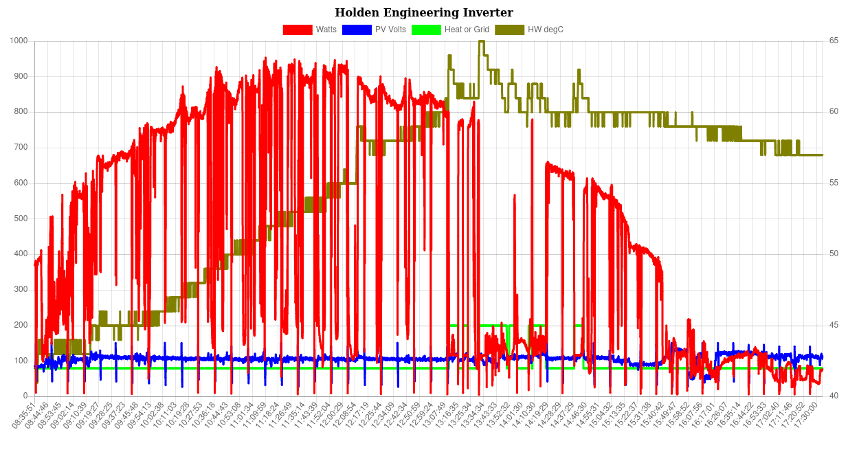

Here is my system on a mid-May day, note it takes till 1pm to fully heat the water!

But all I wanted to know was if looking at picture some one could tell me if I could fit a longer thermostat rather than having to empty the airing cupboard and remove the old one and measure with a bit of wire, it seems the answer is no, so it is empty the airing cupboard to find out.
It's a two minute job, you were close enough to take a photo, no need to empty the cupboard.
