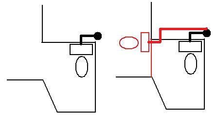

I'm dividing up our existing bathroom as we have the space, and will end up with a bathroom with bath, shower, toilet and sink, and a WC with toilet and sink. So, that's one additional toilet and one additional sink over what we have at the moment. The image below is a no-expense-spared rendering of before and after. The red lines indicate new wall, toilet and pipework...

I'm plumbing a new toilet into the stack. The pipework will run across the same wall as the existing soil pipe. Should I...
(a) Insert a new boss into the stack and connect the new toilet to this. This would be at a level lower down than the existing soil pipe connected to the stack, approximately 50cm lower. As the new toilet is further from the stack, the pipe will connect lower down the existing stack. See (a) in the attached image.
(b) Run the new pipe to a boss lower down on the stack, and run the existing pipe into the new pipework. See (b) in the attached image.
So here I would effectively end up with a T (well, Y) facing upwards, with the old soil pipe falling into the top of the T (Y) on the new pipe going across the wall.
Are either of these solutions OK? If not is there another option I can consider? Note that the fall of the pipes is not correct in the image - I know it's not likely to be 30 degrees!
