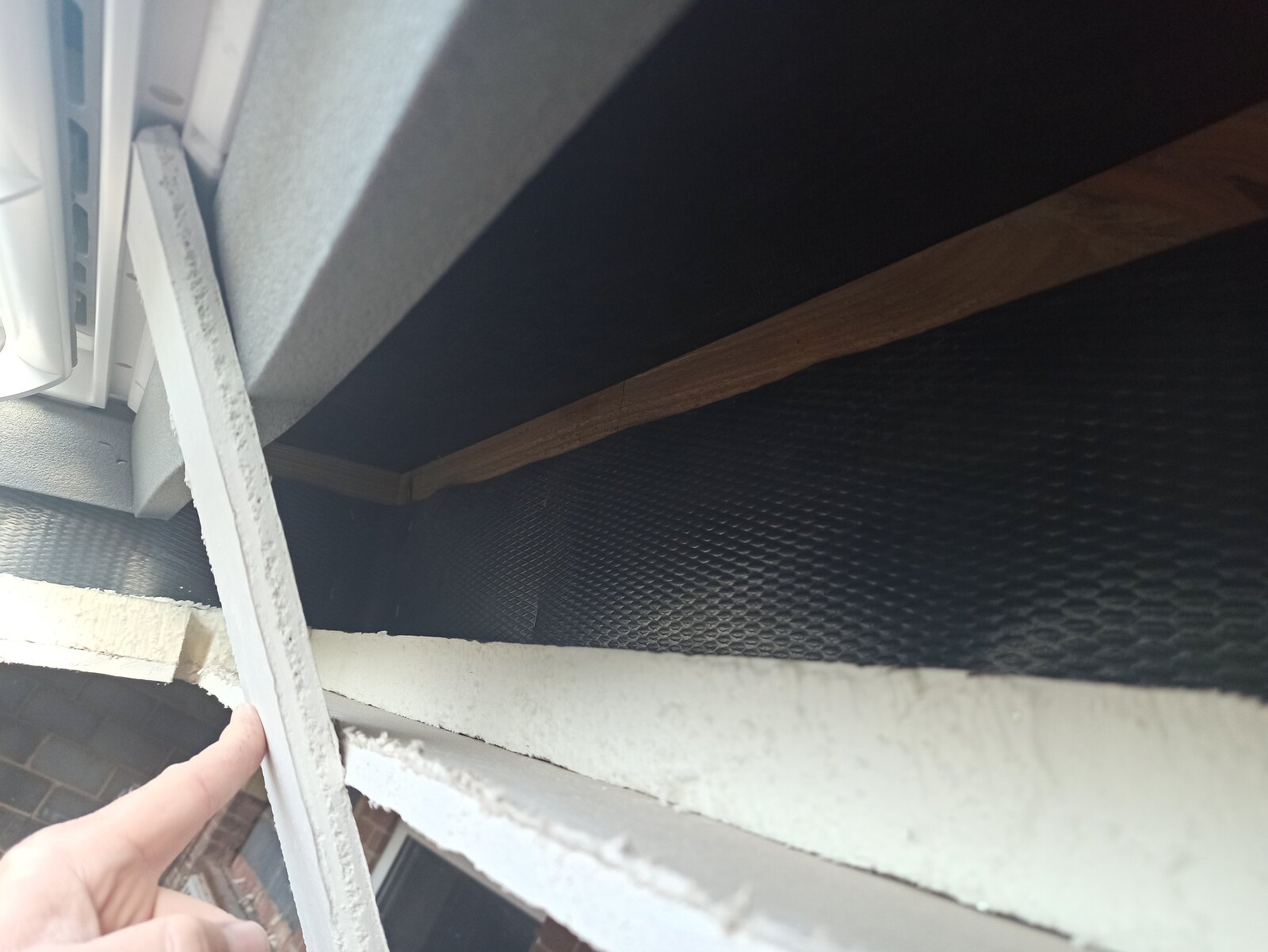

Our latest vaulted...

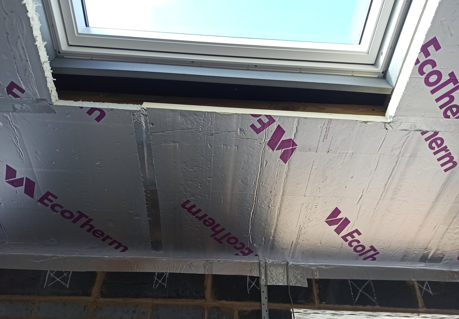

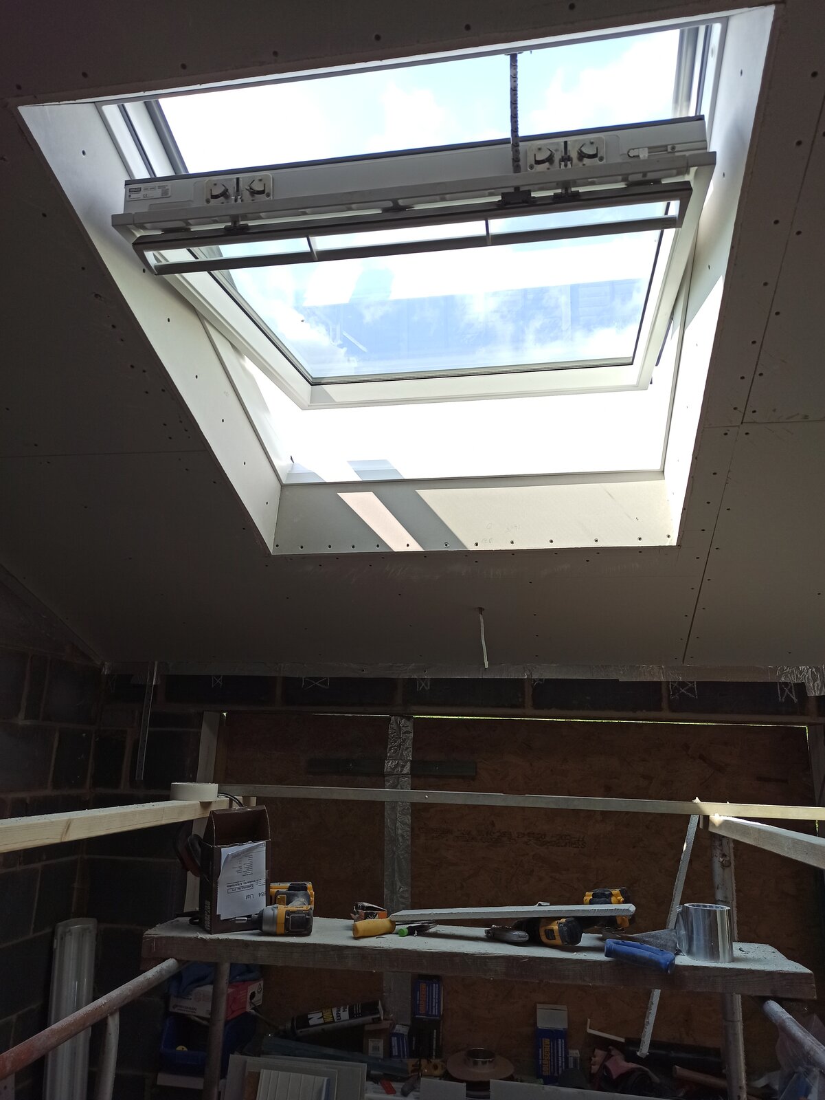

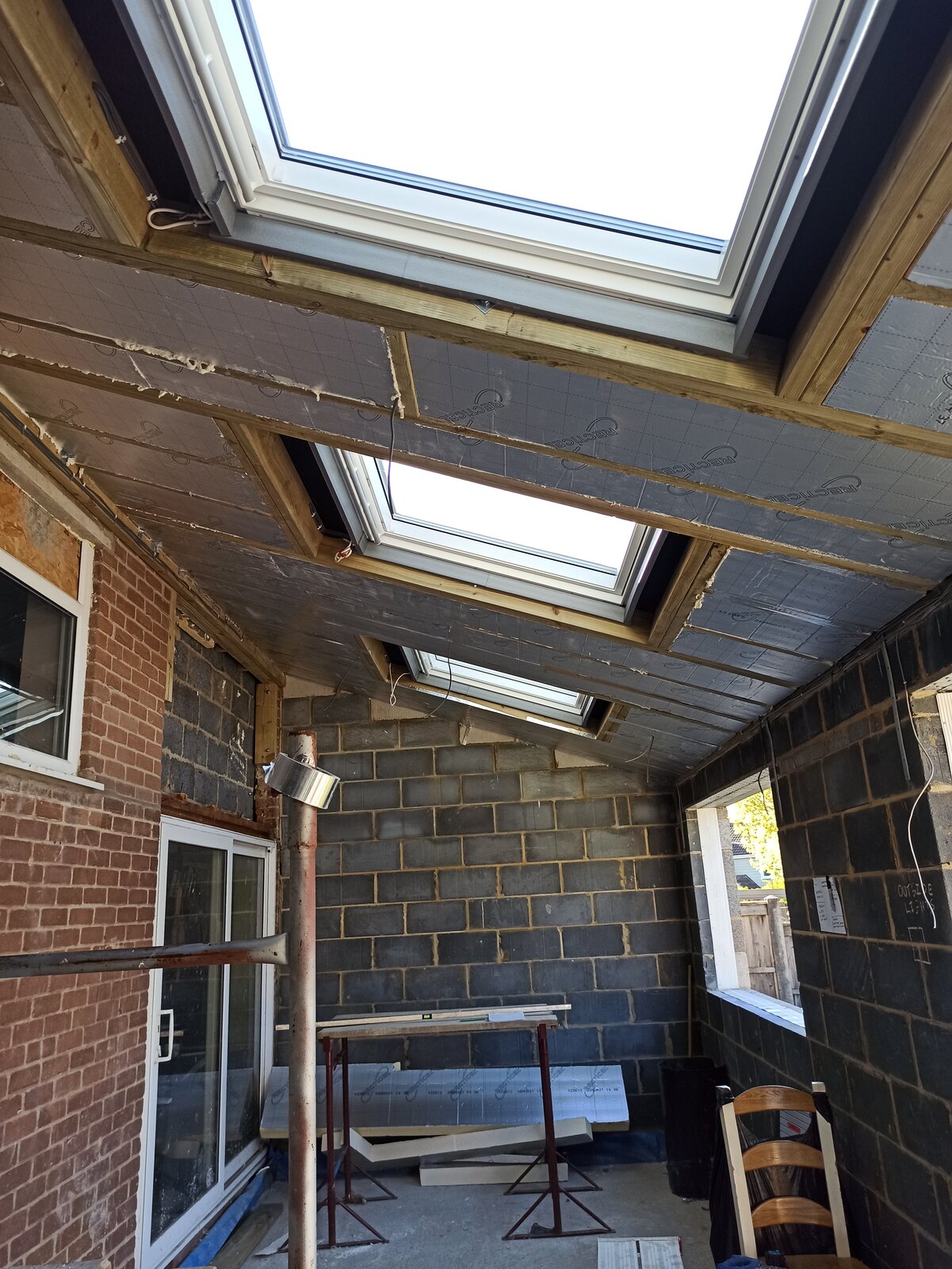

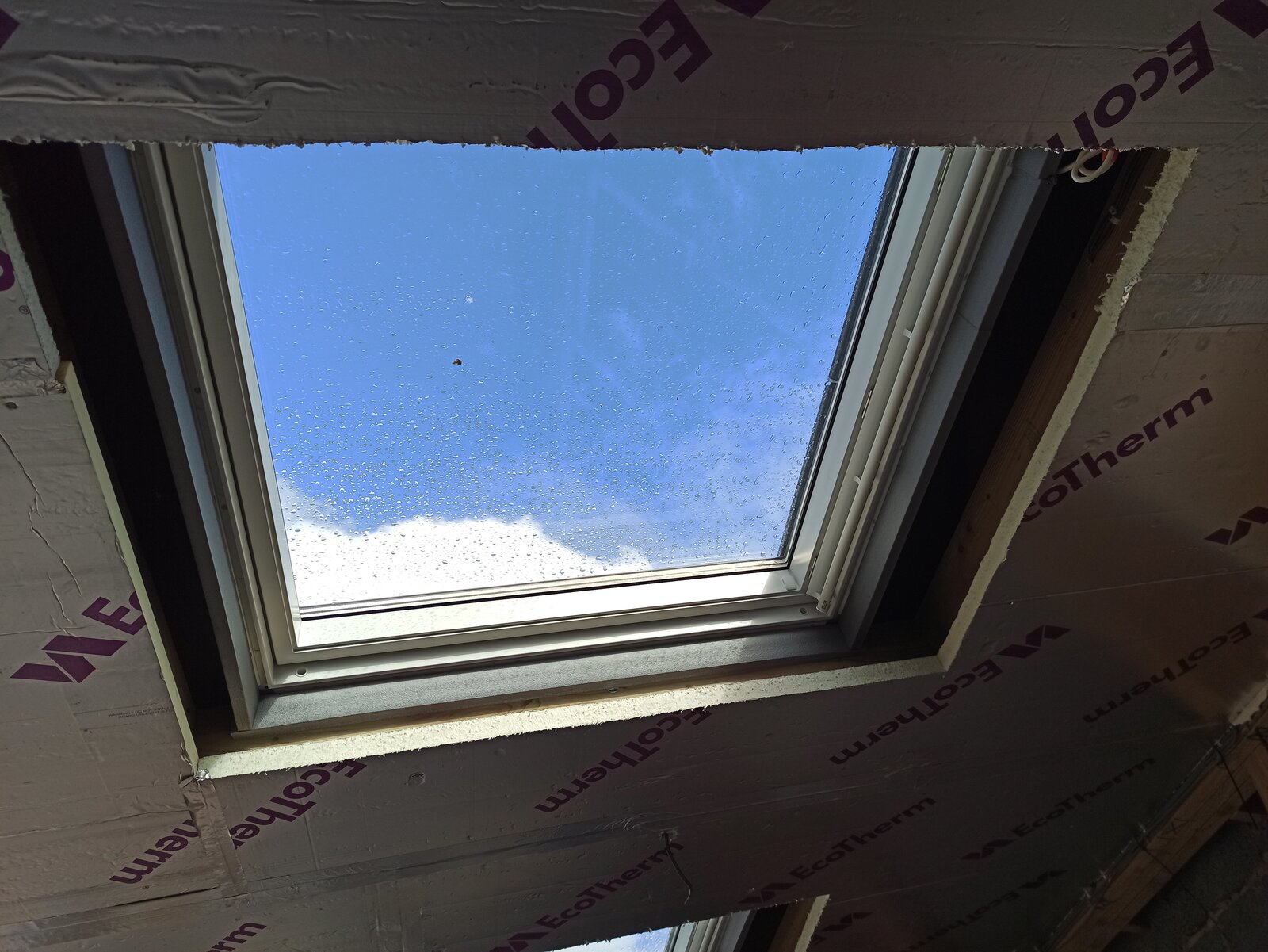

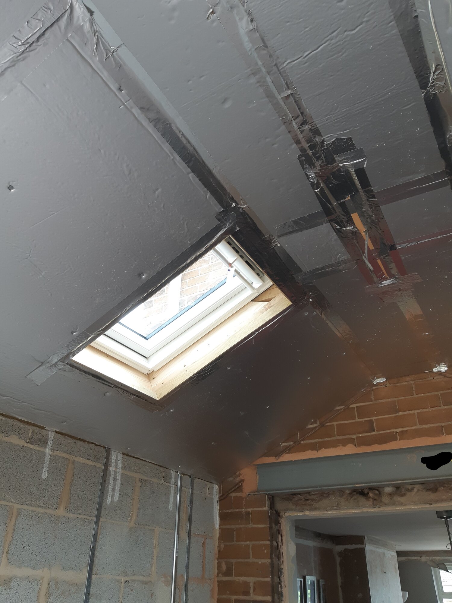

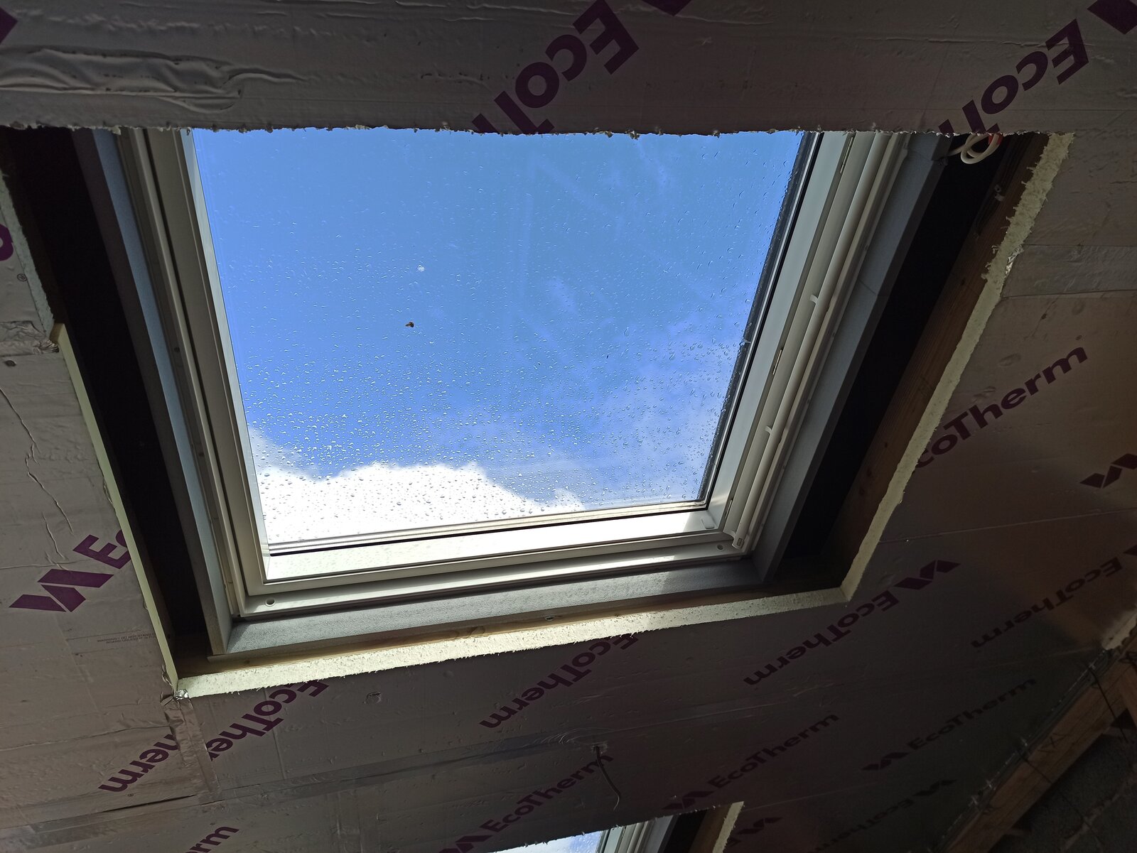

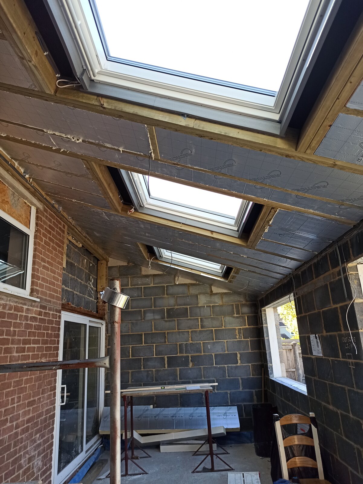

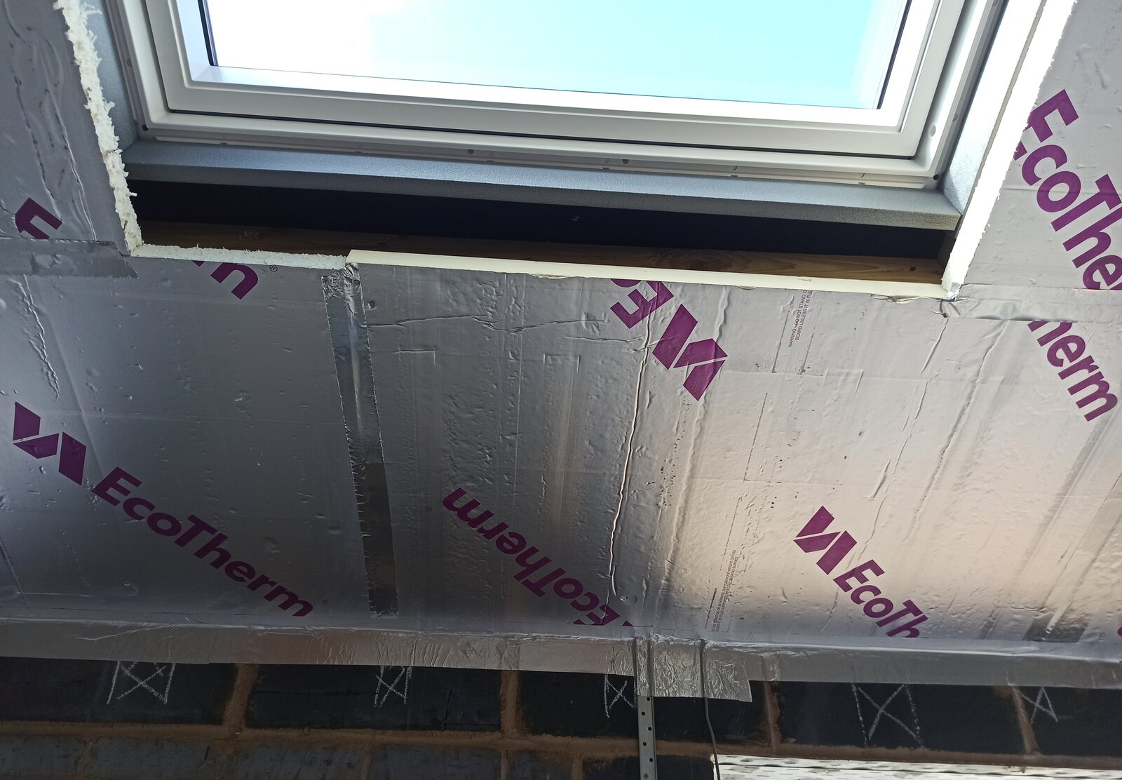

The first image shows 100mm Celotex between the rafters. Note the use of foam too. Also note the 50mm x 25mm batten framing the Velux - this is so that when the 50mm Celotex is laid across the rafters, the plasterboard outer edge has summat to fix to as does the plaster bead. You may also see a timber centrally fixed (now covered in foil) in the second image for ceiling light fixture. Oh and the spray paint wall markings for the rafter positions is essential.
