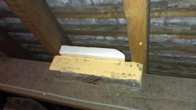

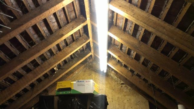

So - I am planning on doing this because I have already insulated the floor, but am facing issues storing things in the loft due to slight damp and at the moment very cold.
I don't want to re-roof - so I am rather stuck with the bare tiles, then baton, then rafter construction that is in place.
I have uploaded two images that might make it clearer. I was planning on something like in the second image where I have a thinner section of insulation between the rafters so as to maintain an air-gap behind. Then a thicker sheet over the top.
At the apex I will construct a frame so that the air can flow from one side of the roof to the other with a void left at the top.
The only place I could think of putting a membrane ( if required ) would be between the two sections of insulation.
