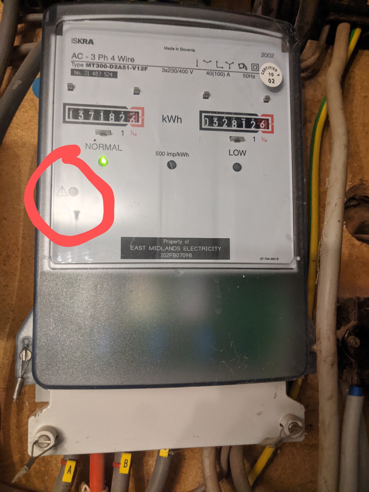

Warning light solid red on electric meter.
21 Jan 2023
I've recently noticed the warning light on our electric meter has been going on (and off). This is separate from the red light that flashes as energy is consumed. Could someone please help me and tell me what this could mean? In the picture I've attached I've circled the light that comes on solid red.
Thanks in advance.
Solid red light means supply is live, but no power (approx) is being consumed.
When power is being consumed, it goes out and you get a flashing red light.
If both are off, there is a supply outage
On your electricity suppliers web page, there is probably a "how to read my meter" section that is specific to the models used in your region.
update
For your particular meter it seems to indicate a fault that you should report to your supplier
Have you got solar panels?
Some kind of fault which will inevitably lead to replacement.
The supplier will want to replace it with a smart meter.
Good luck with that, as it's a 3 phase dual rate affair.
